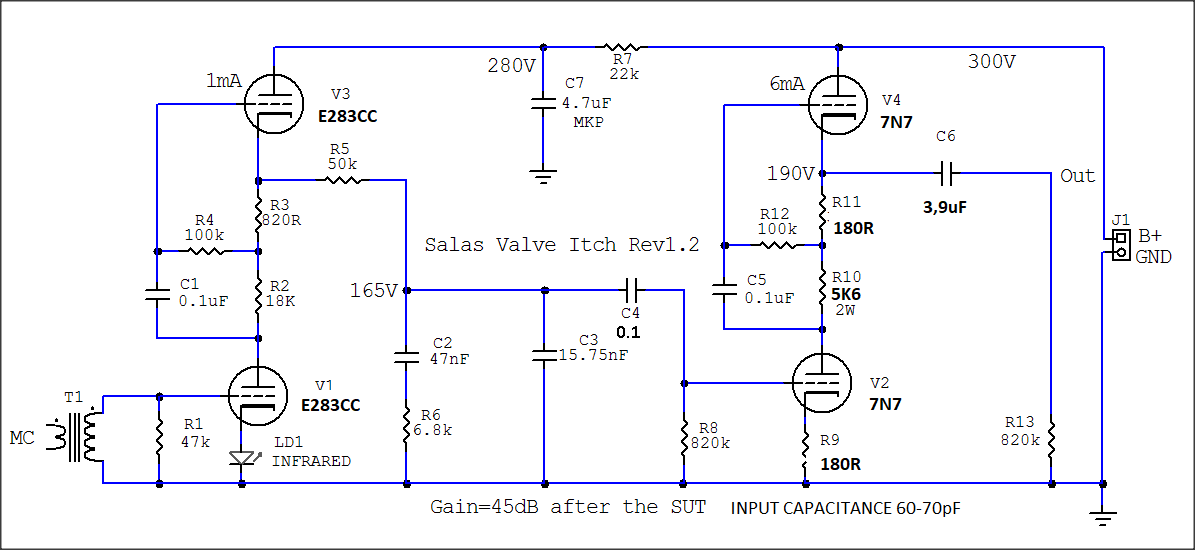

Haven't listened to the radio on various iterations of this so it isn't inherent. It is some detail in your build. For MM you can put 100R grid stopper as a quick measure because such cartridges have higher impedance and it will not affect the noise significantly. There are ferrite beads to try as well. Better/shielded small signal's cabling practice i.e. narrower loop areas of it and tighter construction in the build itself should be thought of and revisited. A grounded metal box is good to transfer the build to, or dress the wooden box's inside with grounded MuMetal shielding, but if its a sensitive tubes issue some locking metal cap shield with compatible base is effective.

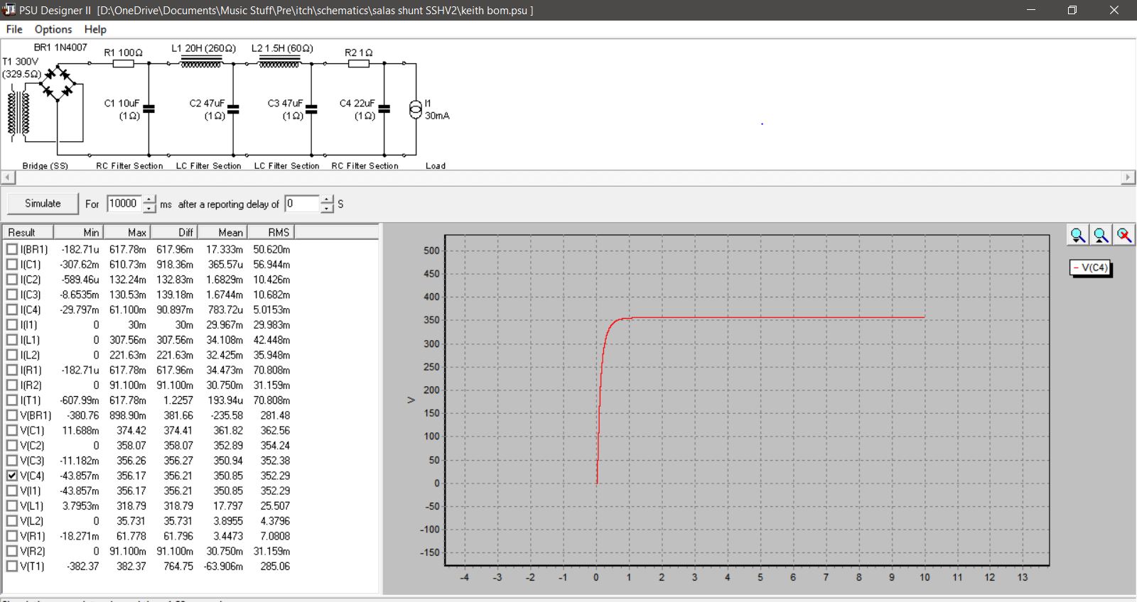

Hi
I have a couple of orphan chokes and thought I could use them in an Itch. I plugged some values into PSUD and came up with a supply that 'hopefully' suits a SSHV2 regulated version of Rev1.2, to be housed in a separate box. The power transformer is a Hammond 370BX putting out about 300v unloaded on local mains voltage. The heater transformers are Hammond toroids (1182K9).
Does this look like it will work?
Keith

I don't know... 10% (?). V2 & V4 sections are the main consumers. Try two different tubes there and measure voltage drop across any resistor in their way (R9 R10 R11) to derive mA when dividing Vdrop by the resistor's value. That will give you an idea of mA bias difference across your own tubes.
