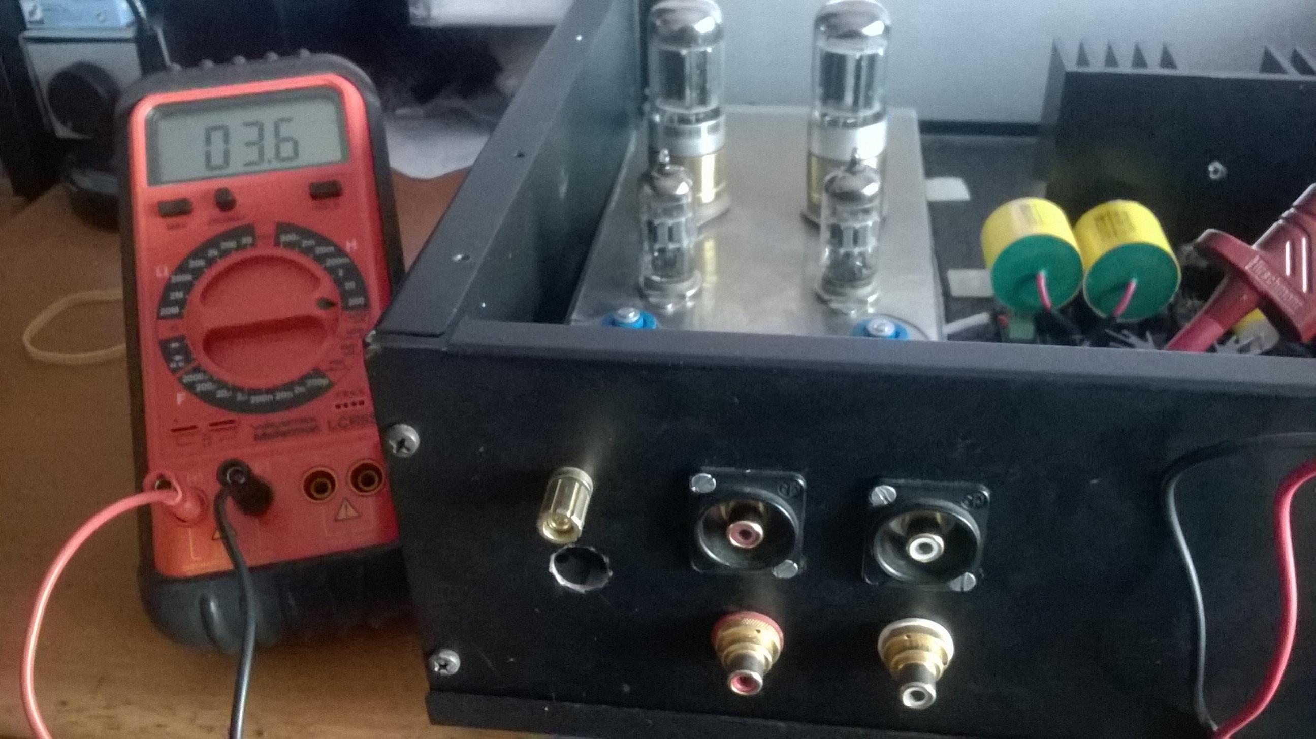

I assume you are mistakenly measuring across the input, as Salas says you should see uH or less (nH) in series with your input resistance. If you are measuring from ground to signal you are mis-using the inductance measurement mode since there is no shunt inductor across the input is there?
You can measure the actual wiring inductance from input jack to end of the signal input wire (not grid pin if grid stopper resistor is present).
