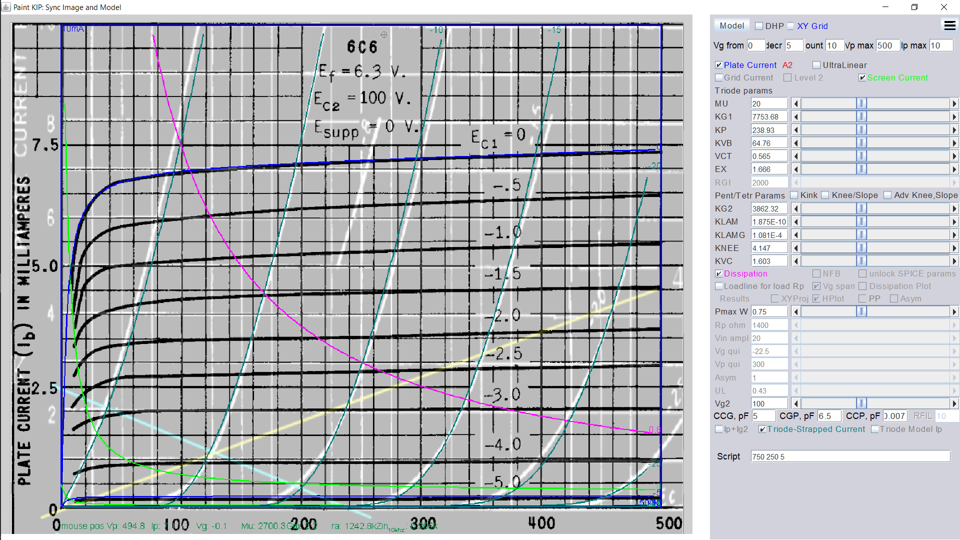

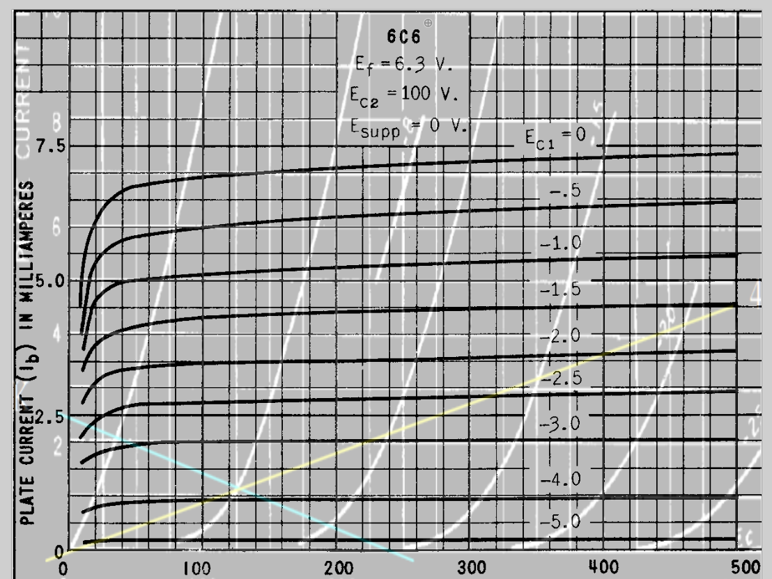

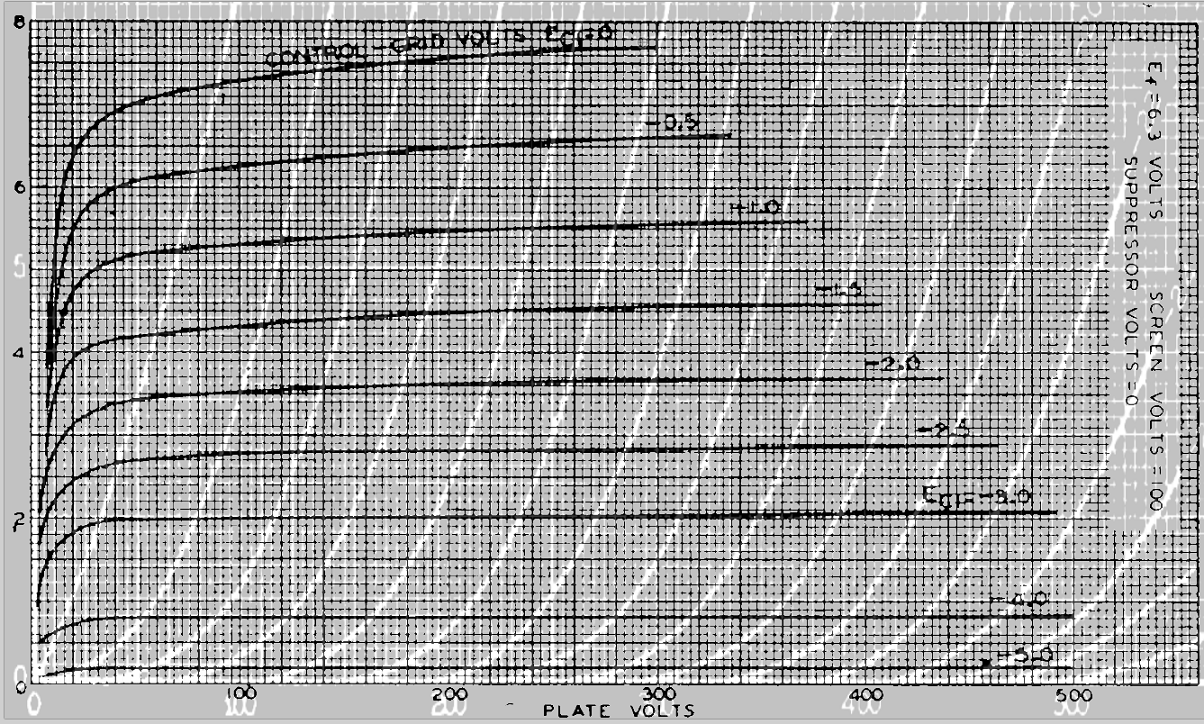

There is 6c6 triode connected curve and schematic here.
Code:
**** 6C6P_TS ******************************************
* Created on 01/03/2019 10:27 using paint_kip.jar
* [URL="http://www.dmitrynizh.com/tubeparams_image.htm"]Model Paint Tools: Trace Tube Parameters over Plate Curves, Interactively[/URL]
* Plate Curves image file: 6c6p_ts.png
* Data source link: <plate curves URL>
.SUBCKT 6C6_TS P G2 G K ; LTSpice tetrode.asy pinout
* .SUBCKT 6C6_TS P G K G2 ; Koren Pentode Pspice pinout
+ PARAMS: MU=20 KG1=7753.68 KP=238.93 KVB=64.76 VCT=0.565 EX=1.666 KG2=3862.32 KNEE=4.147 KVC=1.603
+ KLAM=1.875E-10 KLAMG=1.081E-4   KNK=-0.044 KNG=0.006 KNPL=50 KNSL=11 KNPR=120 KNSR=29
+ CCG=5P CGP=6.5P CCP=0.007P RGI=2000.0
* Vp_MAX=500 Ip_MAX=10 Vg_step=5 Vg_start=0 Vg_count=10
* X_MIN=98 Y_MIN=18 X_SIZE=960 Y_SIZE=770 FSZ_X=1550 FSZ_Y=878 XYGrid=false
* Rp=1400 Vg_ac=20 P_max=0.75 Vg_qui=-22.5 Vp_qui=300
* showLoadLine=n showIp=y isDHP=n isPP=n isAsymPP=n isUL=n showDissipLimit=y
* showIg1=n isInputSnapped=y addLocalNFB=n
* XYProjections=n harmonicPlot=y dissipPlot=n
* UL=0.43 EG2=100 gridLevel2=n addKink=y isTanhKnee=n advSigmoid=n
RE1  7 0  1G    ; DUMMY SO NODE 7 HAS 2 CONNECTIONS
E1   7 0  VALUE=  ; E1 BREAKS UP LONG EQUATION FOR G1.
+{V(G2,K)/KP*LOG(1+EXP((1/MU+(VCT+V(G,K))/SQRT(KVB+V(G2,K)*V(G2,K)))*KP))}
RE2  6 0  1G    ; DUMMY SO NODE 6 HAS 2 CONNECTIONS
E2  6 0  VALUE={(PWR(V(7),EX)+PWRS(V(7),EX))} ; Kg1 times KIT current
RE21 21 0 1
E21  21 0 VALUE={V(6)/KG1*ATAN(V(P,K)/KNEE)} ; Ip with knee but no slope and no kink
RE22 22 0 1 ; E22: kink curr deviation for plate
E22  22 0 VALUE={V(21)*LIMIT(KNK-V(G,K)*KNG,0,0.3)*(-ATAN((V(P,K)-KNPL)/KNSL)+ATAN((V(P,K)-KNPR)/KNSR))}
G1   P  K  VALUE={V(21)*(1+KLAMG*V(P,K))+KLAM*V(P,K) + V(22)}
* Alexander Gurskii screen current, see audioXpress 2/2011, with slope and kink added
RE43 43 K 1G ; Dummy
E43  43 G2 VALUE={0} ; Dummy
G2   43 K  VALUE={V(6)/KG2*(KVC-ATAN(V(P,K)/KNEE))/(1+KLAMG*V(P,K))-V(22)}
RCP  P K  1G     ; FOR CONVERGENCE
C1   K G  {CCG}  ; CATHODE-GRID 1
C2   G P  {CGP}  ; GRID 1-PLATE
C3   K P  {CCP}  ; CATHODE-PLATE
R1   G 5  {RGI}  ; FOR GRID CURRENT
D3   5 K  DX     ; FOR GRID CURRENT }
.MODEL DX D(IS=1N RS=1 CJO=10PF TT=1N)
.ENDS
* The following triode model is derived from pentode model, see above.
* In the triode model, all spice parameters come directly from the pentode model, except for Kg1,
* which for triode-strapped pentodes is derived from pentode's Kg1, Kg2 and Kvc as
*    4Kg1Kg2 / ((2Kvc-Pi)(2Kg1+PiKg2))
* Created on 01/03/2019 10:27 using paint_kit.jar 4.7
.SUBCKT TRIODE_6C6P_TS 1 2 3 ; Plate Grid Cathode
+ PARAMS: CCG=5P  CGP=6.5P CCP=0.007P RGI=2000
+ MU=20 KG1=67293.48 KP=238.93 KVB=64.76 VCT=0.565 EX=1.666
* showLoadLine=n showIp=y isDHT=n isPP=n isAsymPP=n showDissipLimit=y
* showIg1=n gridLevel2=n isInputSnapped=y
E1 7 0 VALUE={V(1,3)/KP*LOG(1+EXP(KP*(1/MU+(VCT+V(2,3))/SQRT(KVB+V(1,3)*V(1,3)))))}
RE1 7 0 1G  ; TO AVOID FLOATING NODES
G1 1 3 VALUE={(PWR(V(7),EX)+PWRS(V(7),EX))/KG1}
RCP 1 3 1G   ; TO AVOID FLOATING NODES
C1 2 3 {CCG} ; CATHODE-GRID
C2 2 1 {CGP} ; GRID=PLATE
C3 1 3 {CCP} ; CATHODE-PLATE
D3 5 3 DX ; POSITIVE GRID CURRENT
R1 2 5 {RGI} ; POSITIVE GRID CURRENT
.ENDS
Excellent! Thanks very much Old Tele Man and Koonw. The 6C6 model works very well in the WE91A circuit I'm developing, giving results that nearly exactly match what's prescribed in the Sound Practices schematic.
I haven't compared it to the 6SJ7 or 6J7 curves, but will try to figure out how to do that and post back. Many thanks again for producing that model.

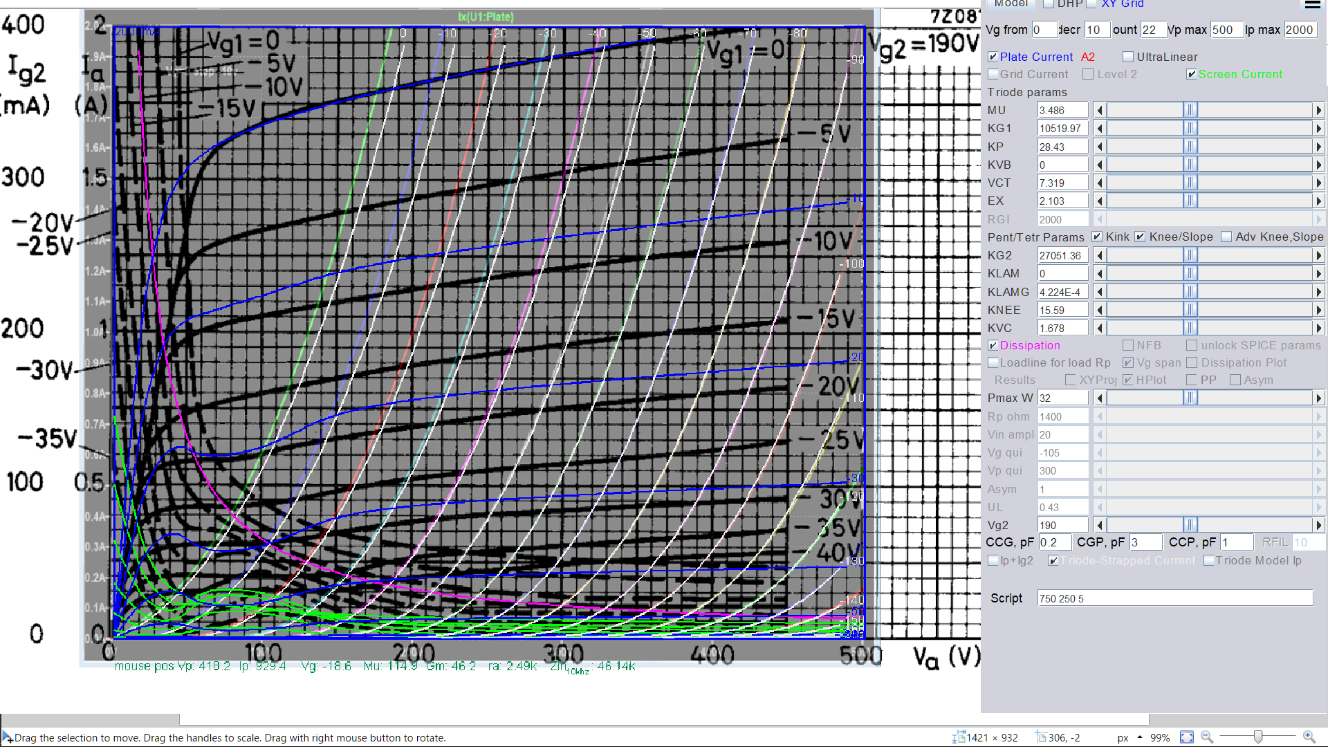

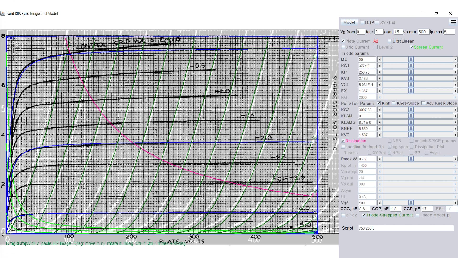

Tung Sol 6c6 and 6j7 are identical in datasheet. Others 6j7 is identical or close to 6sj7, but when compared to 6c6 or Tung Sol 6j7, all that below -1.5v is identical or close, those above -1.5v the curve as it's tilted higher (about 1mA) than Tung Sol and higher than the paint model predicted. Below is Radiotron 6j7 model:
Code:
**** 6J7_RAD ******************************************
* Created on 01/04/2019 13:29 using paint_kip.jar
* [url=http://www.dmitrynizh.com/tubeparams_image.htm]Model Paint Tools: Trace Tube Parameters over Plate Curves, Interactively[/url]
* Plate Curves image file: 6j7_rad.png
.SUBCKT 6J7_RAD P G2 G K ; LTSpice tetrode.asy pinout
* .SUBCKT 6J7_RAD P G K G2 ; Koren Pentode Pspice pinout
+ PARAMS: MU=20 KG1=3774.9 KP=255.75 KVB=2.136 VCT=5.031E-4 EX=1.367 KG2=3907.93 KNEE=5.569 KVC=1.587
+ KLAMG=8.71E-6   KNK=-0.044 KNG=0.006 KNPL=50 KNSL=11 KNPR=120 KNSR=29
+ CCG=2.6P CGP=1.8P CCP=17P RGI=2000.0
* Vp_MAX=500 Ip_MAX=8 Vg_step=2 Vg_start=0 Vg_count=15
* X_MIN=21 Y_MIN=65 X_SIZE=1045 Y_SIZE=663 FSZ_X=1550 FSZ_Y=878 XYGrid=false
* Rp=1400 Vg_ac=20 P_max=0.75 Vg_qui=-14 Vp_qui=300
RE21 21 0 1
G1   P  K  VALUE={V(21)*(1+KLAMG*V(P,K)) + V(22)}
.ENDS
* Created on 01/04/2019 13:29 using paint_kit.jar 4.7
.SUBCKT TRIODE_6J7_RAD 1 2 3 ; Plate Grid Cathode
+ PARAMS: CCG=2.6P  CGP=1.8P CCP=17P RGI=2000
+ MU=20 KG1=91856.78 KP=255.75 KVB=2.136 VCT=5.031E-4 EX=1.367
.ENDS

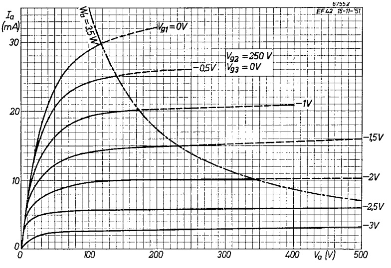

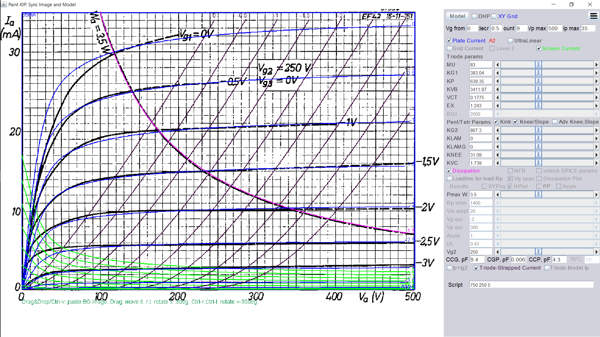

Hello.
Does anyone have an EF42 lamp model?

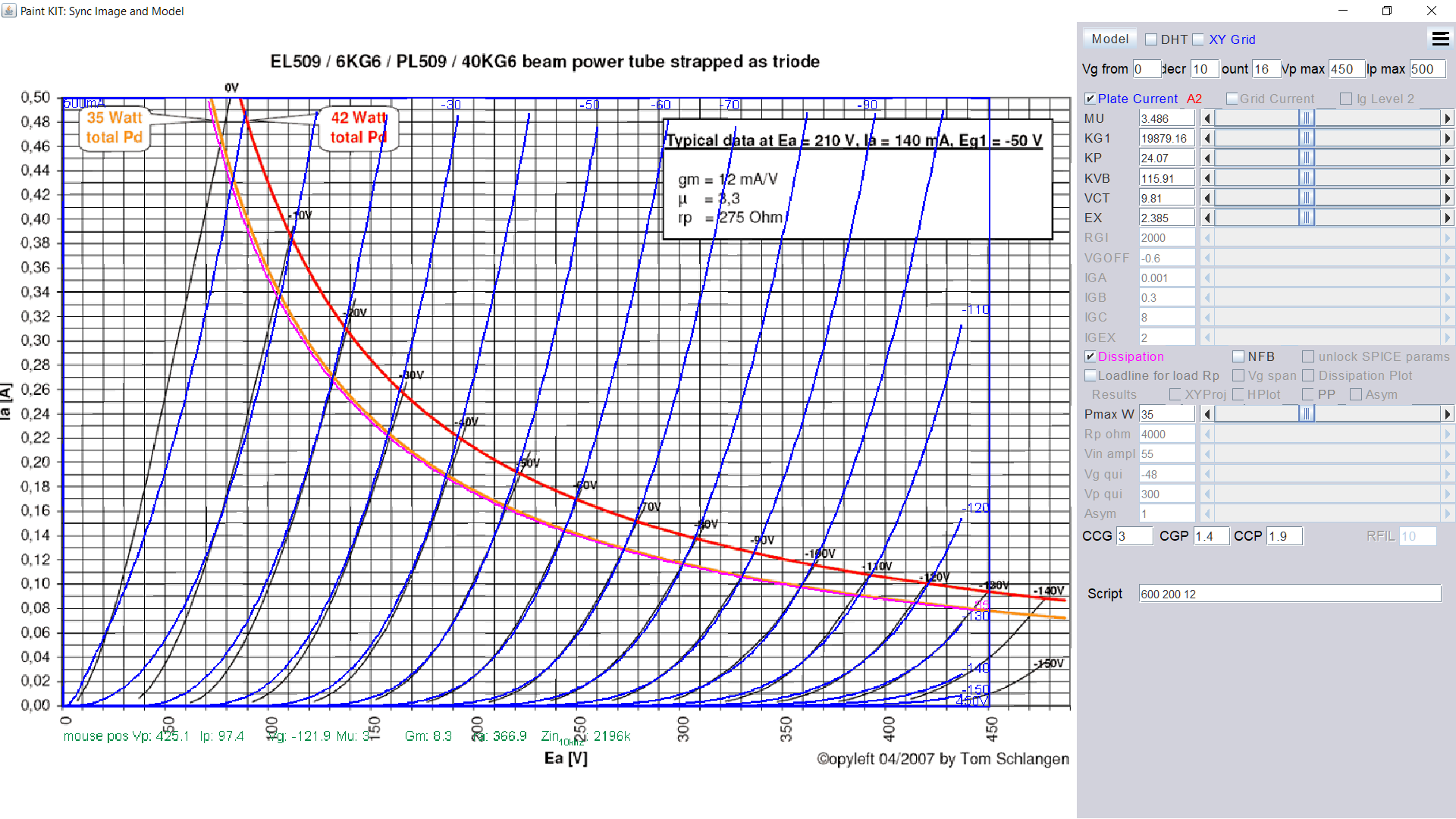

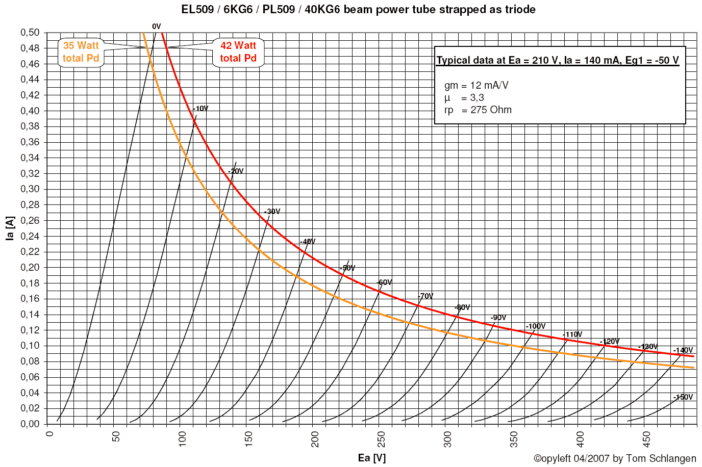

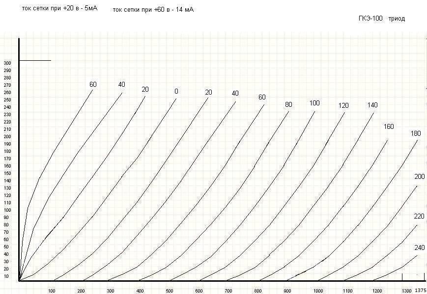

GKE100 in triode
Code:
**** GKE100TRIODA ******************************************
* Created on 12/22/2018 09:51 using paint_kit.jar 3.1
* Plate Curves image file: gke100trioda.jpg
* Data source link:
.SUBCKT TRIODE_GKE100TRIODA 1 2 3 ; Plate Grid Cathode
+ PARAMS: CCG=3P  CGP=1.4P CCP=1.9P RGI=2000
+ MU=5.082 KG1=6120 KP=150 KVB=822 VCT=-0.112 EX=1.428
* Vp_MAX=1375 Ip_MAX=300 Vg_step=20 Vg_start=60 Vg_count=16
* Rp=4000 Vg_ac=55 P_max=40 Vg_qui=-48 Vp_qui=300
* X_MIN=39 Y_MIN=127 X_SIZE=825 Y_SIZE=447 FSZ_X=1369 FSZ_Y=640 XYGrid=false
* showIg1=n gridLevel2=n isInputSnapped=n
* XYProjections=n harmonicPlot=n dissipPlot=n
.ENDS

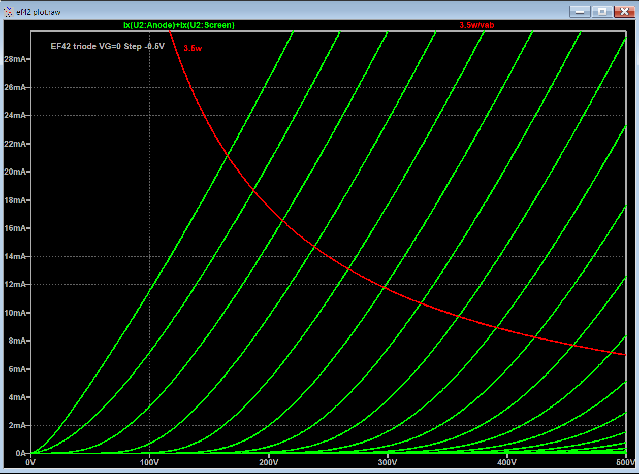

ef42 model:
Code:
**** EF42 ******************************************
* Created on 01/07/2019 09:28 using paint_kip.jar
* Plate Curves image file: ef42.png
.SUBCKT EF42 P G2 G K ; LTSpice tetrode.asy pinout
* .SUBCKT EF42 P G K G2 ; Koren Pentode Pspice pinout
+ PARAMS: MU=83 KG1=383.04 KP=639.35 KVB=3411.97 VCT=0.1775 EX=1.243 KG2=867.3 KNEE=31.09 KVC=1.739
+  KNEE2=20 KNEX=30  KNK=-0.044 KNG=0.006 KNPL=50 KNSL=11 KNPR=120 KNSR=29
+ CCG=9.4P CGP=0.006P CCP=4.3P RGI=2000.0
* Vp_MAX=500 Ip_MAX=35 Vg_step=0.5 Vg_start=0 Vg_count=9
* X_MIN=56 Y_MIN=10 X_SIZE=1006 Y_SIZE=710 FSZ_X=1550 FSZ_Y=878 XYGrid=false
* Rp=1400 Vg_ac=20 P_max=3.5 Vg_qui=-2 Vp_qui=300
* UL=0.43 EG2=250 gridLevel2=n addKink=y isTanhKnee=y advSigmoid=n
RE21 21 0 1
E21  21 0 VALUE={V(6)/KG1*ATAN((V(P,K)+KNEX)/KNEE)*TANH(V(P,K)/KNEE2)} ; Ip with knee but no slope and no kink
G1   P  K  VALUE={V(21) + V(22)}
G2   43 K  VALUE={V(6)/KG2*(KVC-ATAN((V(P,K)+KNEX)/KNEE)*TANH(V(P,K)/KNEE2))-V(22)}
.ENDS
* Created on 01/07/2019 09:28 using paint_kit.jar 4.7
.SUBCKT TRIODE_EF42 1 2 3 ; Plate Grid Cathode
+ PARAMS: CCG=9.4P  CGP=0.006P CCP=4.3P RGI=2000
+ MU=83 KG1=1131.6 KP=639.35 KVB=3411.97 VCT=0.1775 EX=1.243
.ENDS

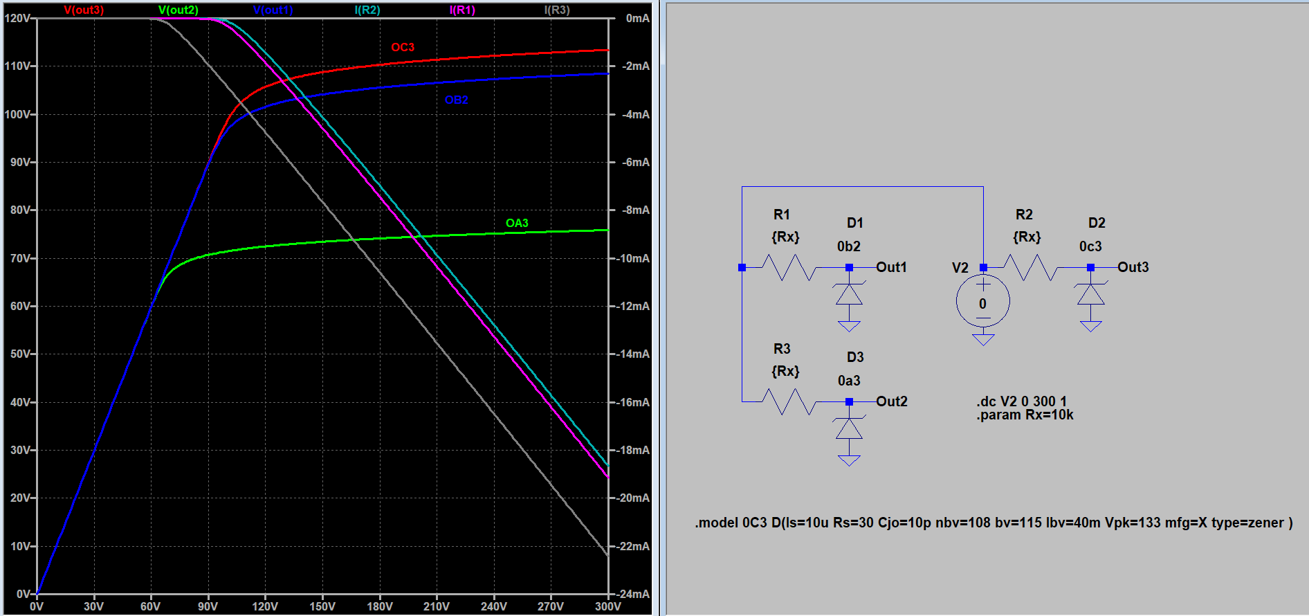

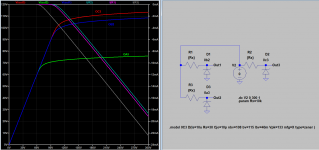

OK, I'm looking for a 0C3 regulator tube model, which I would've thought would be out there already. I haven't found any through Google, by searching this thread, or by starting a new thread in the Tubes/Valves forum (it shows you similar threads once click in the post body area). Can anyone point me to one or copy-paste it here?
Thanks!
Disabled Account
Joined 2013
Here is my attempt to modify 0C3 based on the above link and datasheet, and you can further adjusted for different manufacturers specs such as nbv (normal break down voltage).
Code:
.model 0C3 D(Is=10u Rs=30 Cjo=10p nbv=108 bv=115 Ibv=40m Vpk=133 mfg=X type=zener )
0C3 is 108v octal type tube regulator, max current 40mA.

Asking for the model. I attach triode curves.

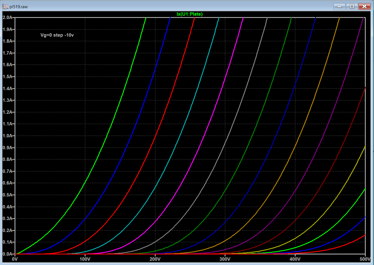

I remodel the triode curve you attached to match the larger scale of corresponding pentode curve so making a larger area to paint. Here is the model:
Code:
**** PL519_P ******************************************
* Created on 01/17/2019 02:14 using paint_kip.jar
* Plate Curves image file: pl519_p.png
.SUBCKT PL519_P P G2 G K ; LTSpice tetrode.asy pinout
* .SUBCKT PL519_P P G K G2 ; Koren Pentode Pspice pinout
+ PARAMS: MU=3.486 KG1=10519.97 KP=28.43 KVB=0 VCT=7.319 EX=2.103 KG2=27051.36 KNEE=15.59 KVC=1.678
+ KLAMG=4.224E-4 KNEE2=20 KNEX=30  KNK=-0.044 KNG=0.006 KNPL=50 KNSL=11 KNPR=120 KNSR=29
+ CCG=0.2P CGP=3P CCP=1P RGI=2000.0
* Vp_MAX=500 Ip_MAX=2000 Vg_step=10 Vg_start=0 Vg_count=22
* X_MIN=134 Y_MIN=47 X_SIZE=868 Y_SIZE=708 FSZ_X=1550 FSZ_Y=878 XYGrid=false
* Rp=1400 Vg_ac=20 P_max=32 Vg_qui=-105 Vp_qui=300
* UL=0.43 EG2=190 gridLevel2=n addKink=y isTanhKnee=y advSigmoid=n
RE21 21 0 1
G2   43 K  VALUE={V(6)/KG2*(KVC-ATAN((V(P,K)+KNEX)/KNEE)*TANH(V(P,K)/KNEE2))/(1+KLAMG*V(P,K))-V(22)}
.ENDS
* Created on 01/17/2019 02:14 using paint_kit.jar 4.7
.SUBCKT TRIODE_PL519_P 1 2 3 ; Plate Grid Cathode
+ PARAMS: CCG=0.2P  CGP=3P CCP=1P RGI=2000
+ MU=3.486 KG1=50076.34 KP=28.43 KVB=0 VCT=7.319 EX=2.103
.ENDS
