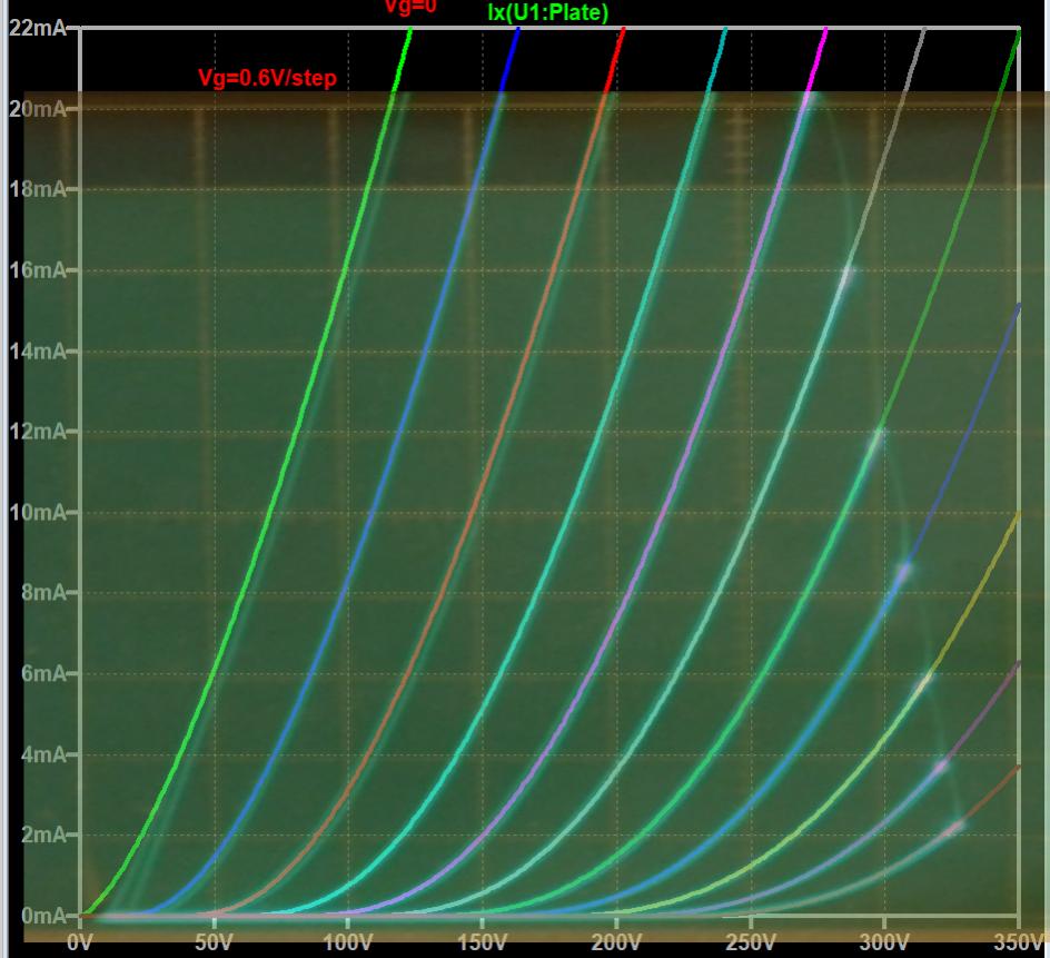

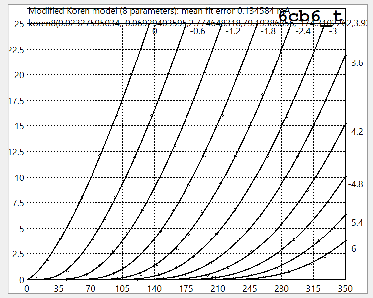

There are models already but if you like to use model based on these curve plot, here is 6c6_t:
* 6cb6_t LTSpice model
.subckt 6cb6_t P G K
+ params: ccg=6.5p cgp=0.015 ccp=3p rgi=1000
Bp P K I=(0.02327595034m)*uramp(V(P,K)*ln(1.0+(-0.06929403595)+exp((2.774648318)+(2.774648318)*((79.19386856)+(-174.3102262m)*V(G,K))*V(G,K)/sqrt((3.939429998e-006)**2+(V(P,K)-(-11.60203021))**2)))/(2.774648318))**(1.417585497)

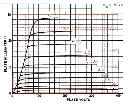

@Koonw - for the 6CB6 and 6GU5 models that you posted above, did you check them against the datasheets (in pentode)? Just looking at the plate current quickly, their readings seem to be quite a ways off, i.e., the traced curves are somewhat suspect, which could be due to the tubes that smoking-amp used for the tracing or the scales given might be off.
Don't find any original curve for 6gu5.

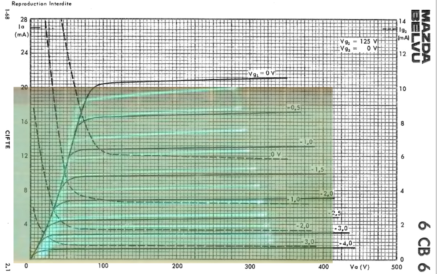

The smoking-amp's pentode curve for 6cb6 is compared to Mazda's, but they are plots for Vg2 equal to 130v and 125v, respectively and different Vg steps, still, it is not very far from original (see Vg=0). The triode model traced very well and tight, CurveTracer will not generate it, if it's just slightly out as tolerance is low, IHMO.

@smoking-amp & Koonw - ok, I generated a pentode model for the 6CB6 using the traced triode curves, and here is the resultant characteristic compared to the datasheet, as you can see, the cuves are far from close, even if we factor in the tube tolerance and the error that was introduced by the methodology used...

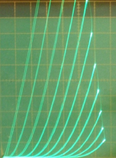

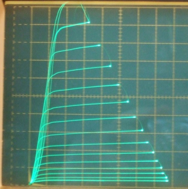

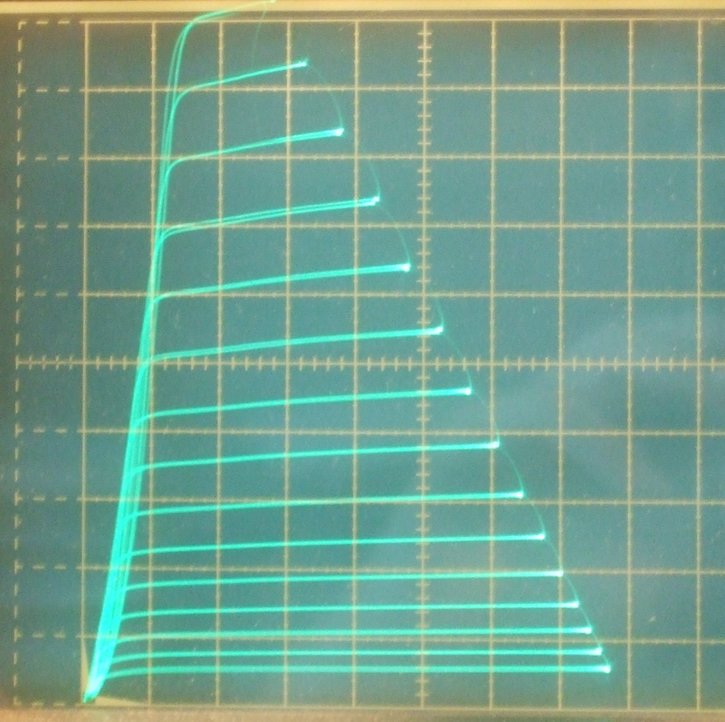

Here are pentode mode curve traces for the two NOS RCA 6CB6A/6CF6 tubes I have.
Vert. Scale is 2 mA/div and Horiz. scale is 50V/div
Grid 1 steps are 0.25V

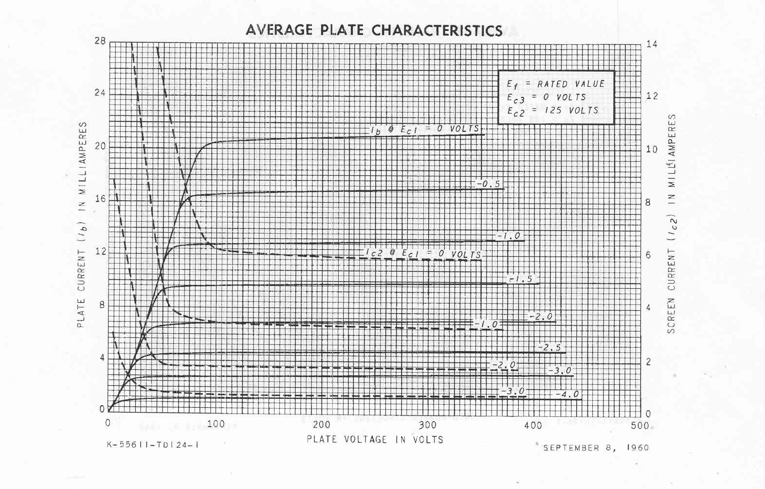

Both were adjusted to get a similar graph to the GE datasheet (except 0.25V steps here instead of 0.5V steps there). 1st tube needed 135V on grid2, and the second tube needed 120V on grid2. (typical variation)

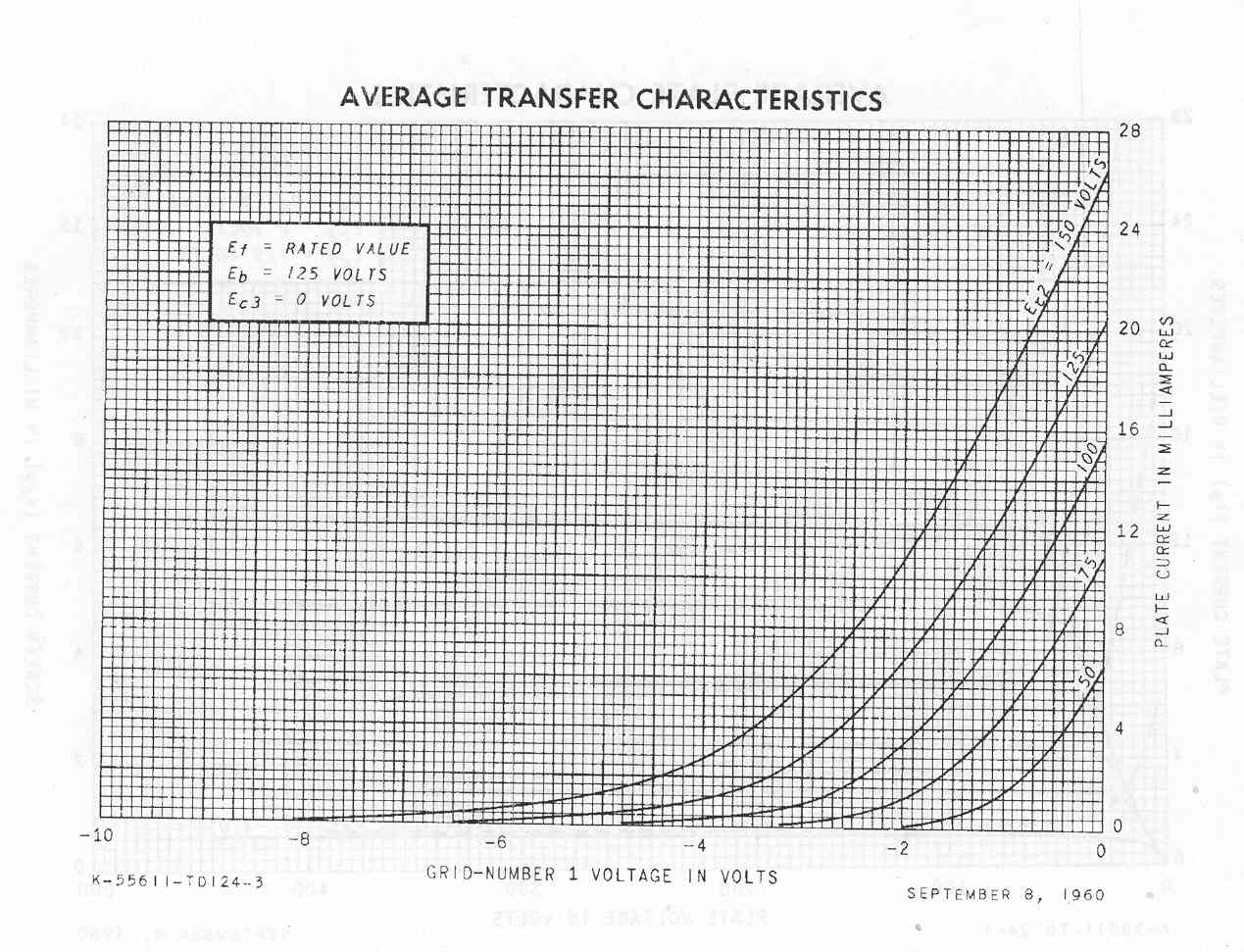

From the 2nd GE datasheet plate/grid1 curves one can easily compute the triode Mu as around 36 for a nominal tube. (including the plate 280,000 Ohm Rp effect would drop that Mu by 1.6% to 35.4)
If one takes into account the 135 Vg2 required on the 1st tube to get the same pentode curve results as the datasheet at 125 Vg2, then that tube Mu would be increased to 135/125 x 36 = 39 (I think I got around Mu 42 earlier, but that depends on what current level Mu gets measured at)
There is clearly some grid1 gm difference between the two RCA tubes as well. About 13% more gm1 for tube 2. Which would increase its Mu factor by 1.13. But the lower 120V Vg2 would lower its Mu by about 120/125. Giving: 36 x 1.13 x 120/125 = 39 expected Mu. Both tubes measured similar triode Mu's, now we know why. (probably just more cathode emission in tube 2, Mu is determined by the grid geometries and should be more constant for similar tubes)
