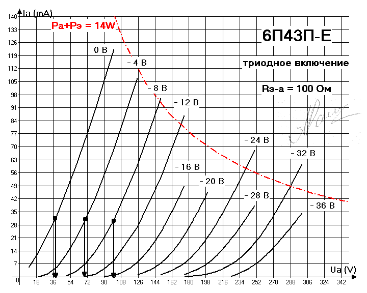

I've collected as many data sheets and curves as I could find. I've attached some to this post, in the (perhaps misguided) hope that one of you SPICE wizards can possibly make a working model out of the info.
In triode, this looks like a beefy and quite linear driver, or possibly the power tube for a small amp (headphone amp?).

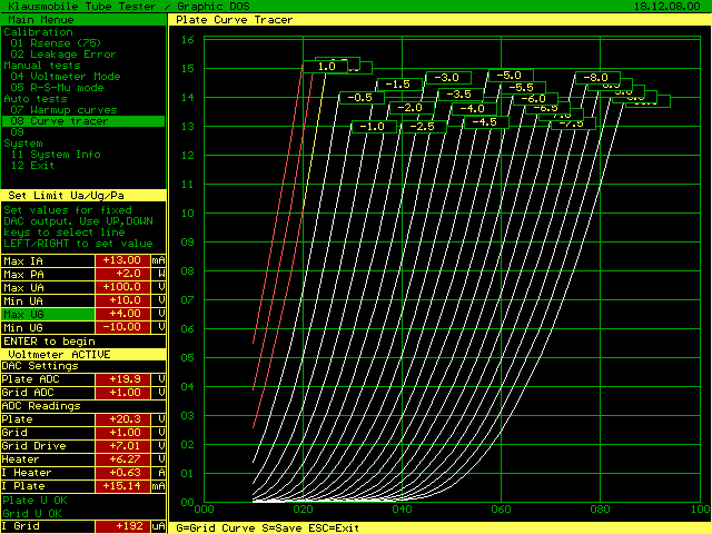

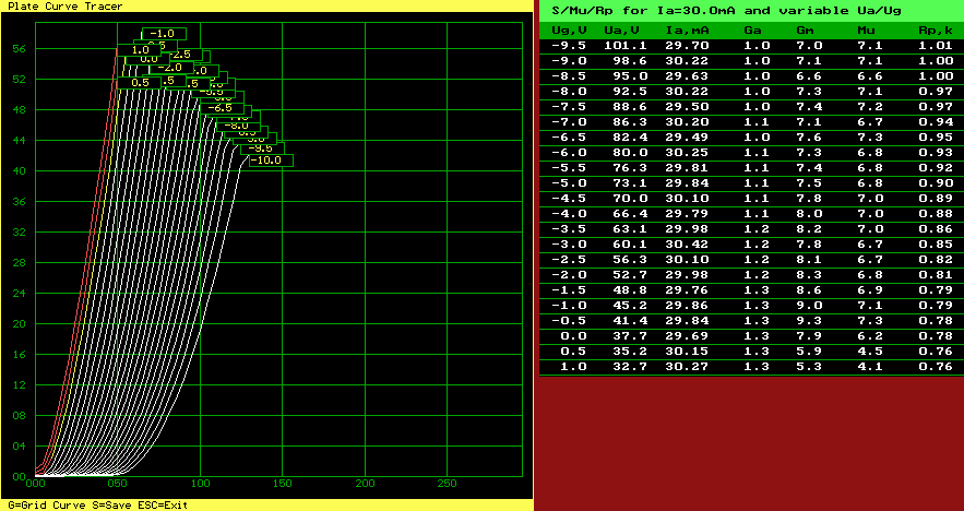

6P43P-E triode conneted LTspice model
@rongon, I did this in Curve Captor. I guessed at the capacitances. Follows closely the triode connected curves you posted.

Isn't this very similar to EL86 ?
According to Klausmobile Tube Tester Files, the 6P33P is an "EL86 clone." He says about 6P43P-EV: "I give up, cannot find data on this tube, heard that it is 6P18P version, although it does look differently."
I'm looking at the data sheet for EL86, which has triode curves on page 'G.' It looks like it's sort of close to 6P43P in triode, but not equivalent.

Any model at all would be much appreciated. I can see using this tube in triode for a line amp or driver stage, or in pentode for a push-pull output stage.
I've read some good things about this tube, including from Anatoliy (Wavebourn), but my search for a spice model turned up only one very simple one that I couldn't get to work right.
I did a quick LTspice mock-up of a triode line stage with the model cogsncogs kindly contributed, and it looks like it works well. Mu of about 7, voltages and currents look about right, and line up pretty well with the operating points measured on the klausmobile site.
