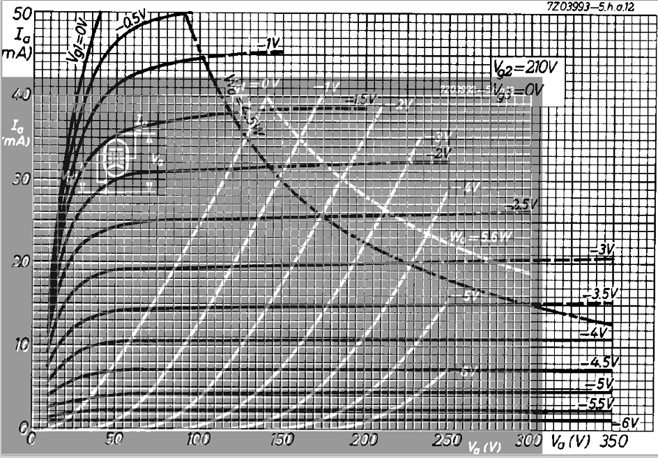

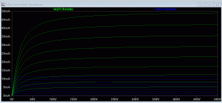

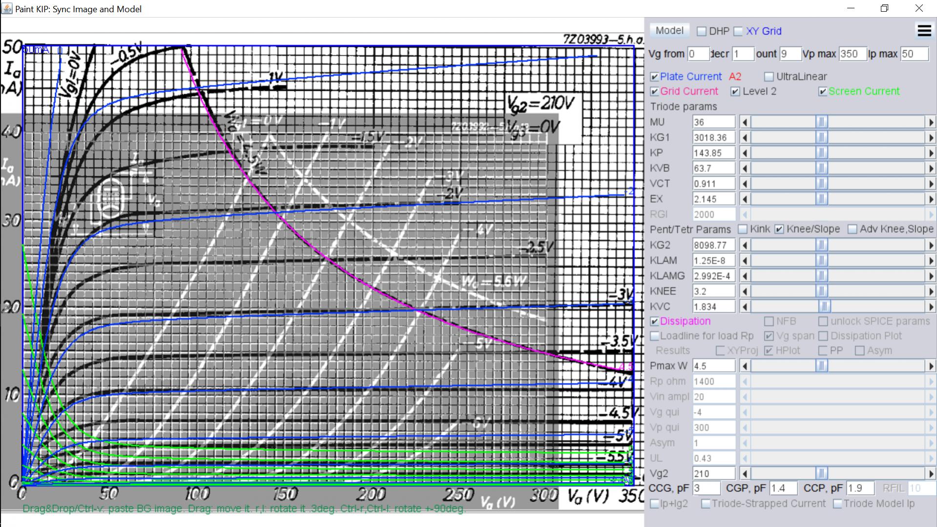

E81L model:
Code:
**** E81L ******************************************
* Created on 11/09/2021 02:02 using paint_kip.jar
* [url=http://www.dmitrynizh.com/tubeparams_image.htm]Model Paint Tools: Trace Tube Parameters over Plate Curves, Interactively[/url]
* Plate Curves image file: e81l.png
* Data source link: <plate curves URL>
.SUBCKT E81L P G2 G K ; LTSpice tetrode.asy pinout
* .SUBCKT E81L P G K G2 ; Koren Pentode Pspice pinout
+ PARAMS: MU=36 KG1=3018.36 KP=143.85 KVB=63.7 VCT=0.911 EX=2.145 KG2=8098.77 KNEE=3.2 KVC=1.834
+ KLAM=1.25E-8 KLAMG=2.992E-4 KNEE2=19.08 KNEX=9.04  KNK=5.126E-4 KNG=1.501E-5
+ CCG=3P CGP=1.4P CCP=1.9P VGOFF=-0.6 IGA=0.001 IGB=0.3 IGC=8 IGEX=1.86
* Vp_MAX=350 Ip_MAX=50 Vg_step=1 Vg_start=0 Vg_count=9
* X_MIN=31 Y_MIN=39 X_SIZE=835 Y_SIZE=601 FSZ_X=1296 FSZ_Y=736 XYGrid=false
* Rp=1400 Vg_ac=20 P_max=4.5 Vg_qui=-4 Vp_qui=300
* showLoadLine=n showIp=y isDHP=n isPP=n isAsymPP=n isUL=n showDissipLimit=y
* showIg1=y isInputSnapped=y addLocalNFB=n
* XYProjections=n harmonicPlot=y dissipPlot=n
* UL=0.43 EG2=210 gridLevel2=y addKink=n isTanhKnee=y advSigmoid=n
RE1  7 0  1G    ; DUMMY SO NODE 7 HAS 2 CONNECTIONS
E1   7 0  VALUE=  ; E1 BREAKS UP LONG EQUATION FOR G1.
+{V(G2,K)/KP*LOG(1+EXP((1/MU+(VCT+V(G,K))/SQRT(KVB+V(G2,K)*V(G2,K)))*KP))}
RE2  6 0  1G    ; DUMMY SO NODE 6 HAS 2 CONNECTIONS
E2  6 0  VALUE={(PWR(V(7),EX)+PWRS(V(7),EX))} ; Kg1 times KIT current
G1   P K  VALUE={V(6)/KG1*ATAN((V(P,K)+KNEX)/KNEE)*TANH(V(P,K)/KNEE2)*(1+KLAMG*V(P,K))+KLAM*V(P,K)}
* Alexander Gurskii screen current, see audioXpress 2/2011
RE4K 4K K 1G ; Dummy, per Alex request
E4K 4K  4 VALUE={0} ; Dummy, per Alex request
G4K 4K K VALUE={V(6)/KG2*(KVC-ATAN((V(P,K)+KNEX)/KNEE)*TANH(V(P,K)/KNEE2))/(1+KLAMG*V(P,K))}
RCP  P K  1G     ; FOR CONVERGENCE
C1   K G  {CCG}  ; CATHODE-GRID 1
C2   G P  {CGP}  ; GRID 1-PLATE
C3   K P  {CCP}  ; CATHODE-PLATE
RE23 G 0 1G
GG G K VALUE={(IGA+IGB/(IGC+V(P,K)))*(MU/KG1)*
+(PWR(V(G,K)-VGOFF,IGEX)+PWRS(V(G,K)-VGOFF,IGEX))}
.ENDS

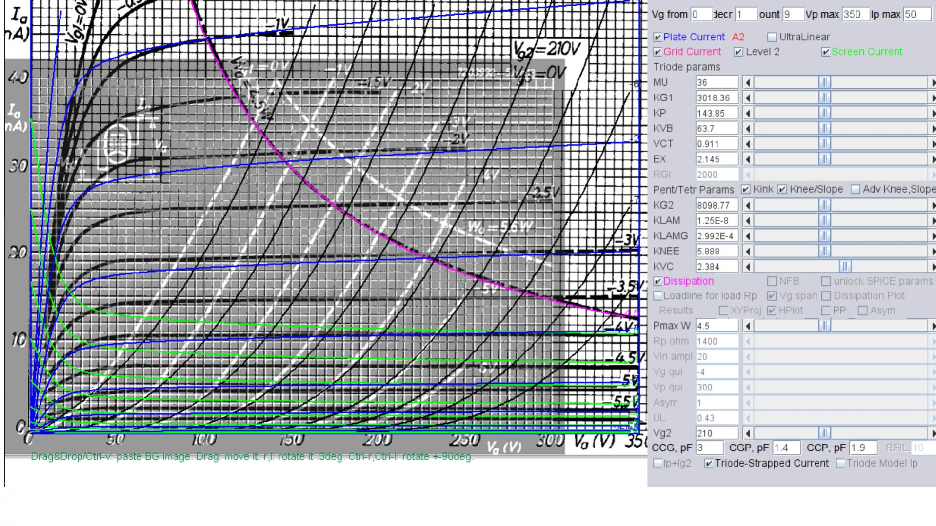

Disabled Account
Joined 2013
This update fixed missing Ig2, E81L:
Code:

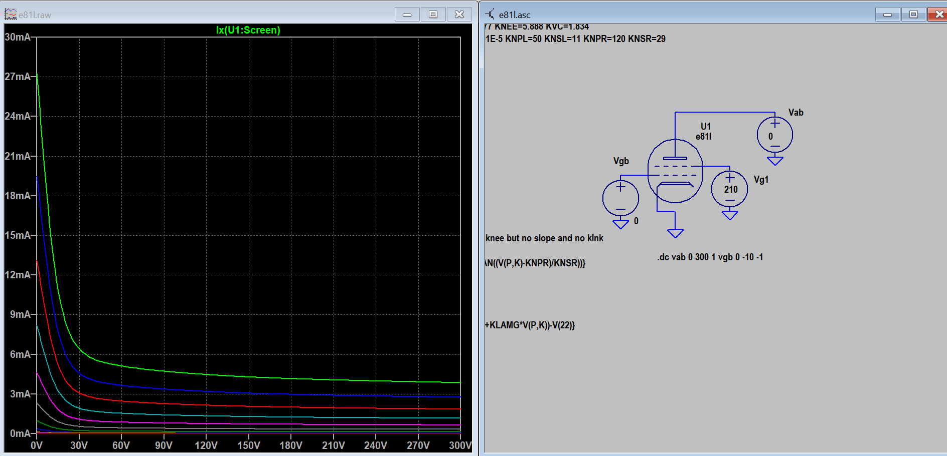

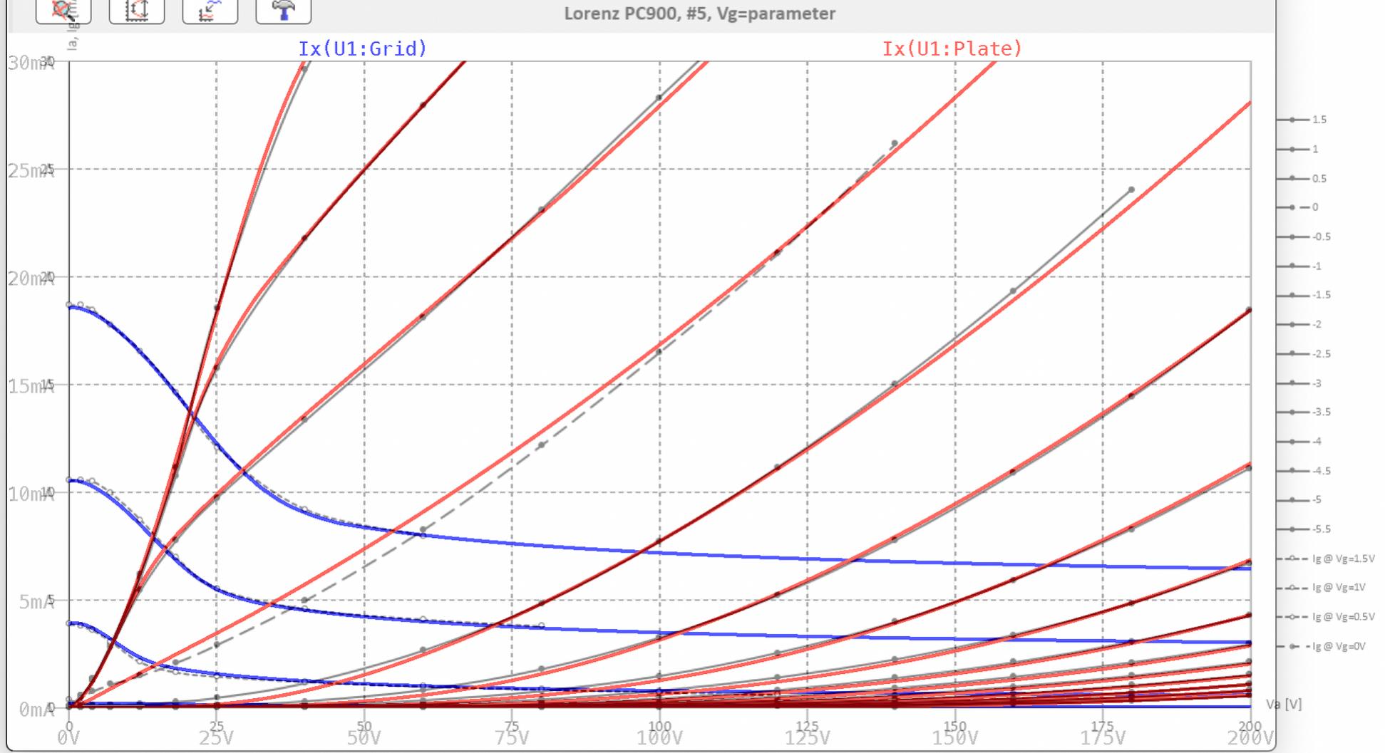

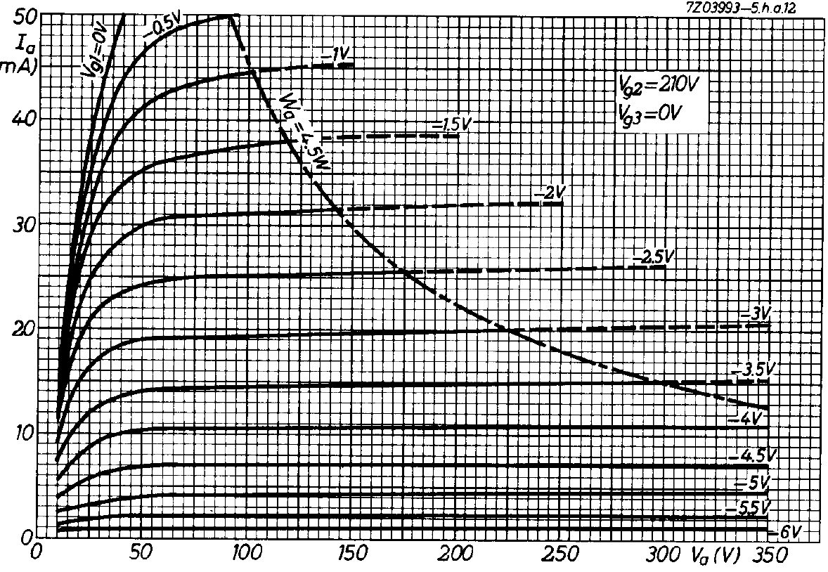

E81L grid 2 current
Hi Koonw,
Thanks for the quick work on the model. I also tried Paint_KIP and could not figure out how to fix the model errors.
Can you check the G2 current data of your model? The Philips data sheet indicated G2 current of 5.3 mA at 210V plate, 20 mA plate current, and -2V bias. The chart on page 6 of 1968 data sheet showed the similar amount. So I would expect the 3rd (grid current) green line from top down should be around 5 mA.
If you agree, can you revise the model again? Appreciate your help.

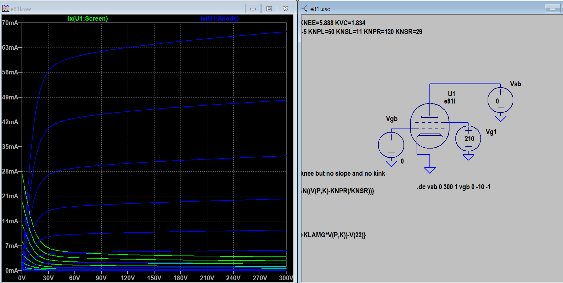

Disabled Account
Joined 2013
Here is Ig2 plot of the updated model (posted previously), nothing has been changed, just plot Ig2. Adjust params Kg2 and KVC will change Ig2 curve, params Screen current and Kink needs to be on, but the Kink is unchecked in the earliest model (think that is a bug) now included. Should you need to correct the model, you need the original curve, once in Paint, click on the Model, paste the model code and then Update. Adjust the X,Y ordinates to make sure it matches the original scale Ia/Va curve. As there is no Screen Current curve, you need to alter it if it's incorrect. I must have mistaken 0v instead of -2V, anyway the triode curve now lined much better. Thank you very much together we made better model.
Disabled Account
Joined 2013
E81L model with Ig2 adjusted: ( also alter inter-electode capacitance yourself)

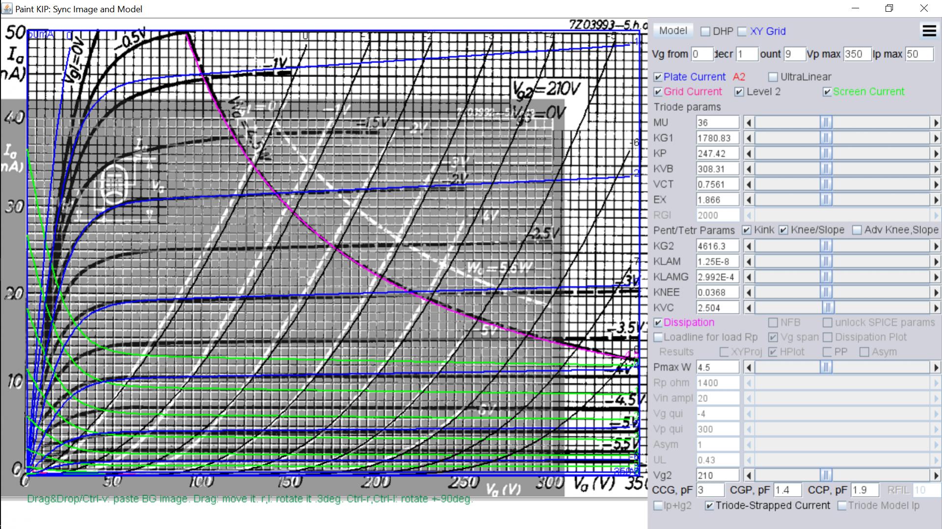

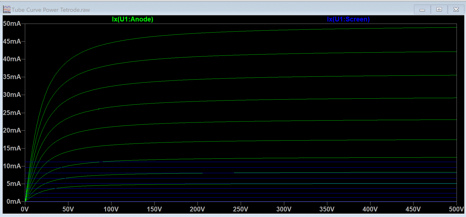

Disabled Account
Joined 2013
Refined model, triode curve better matched the original.
Code:
* Created on 11/09/2021 11:30 using paint_kip.jar
* [URL="http://www.dmitrynizh.com/tubeparams_image.htm"]Model Paint Tools: Trace Tube Parameters over Plate Curves, Interactively[/URL]
+ PARAMS: MU=36 KG1=1780.83 KP=247.42 KVB=308.31 VCT=0.7561 EX=1.866 KG2=4616.3 KNEE=0.0368 KVC=2.504
+ KLAM=1.25E-8 KLAMG=2.992E-4 KNEE2=22.16 KNEX=0.93  KNK=1.435E-4 KNG=1.411E-5 KNPL=37 KNSL=11 KNPR=120 KNSR=29
* X_MIN=37 Y_MIN=18 X_SIZE=832 Y_SIZE=606 FSZ_X=1296 FSZ_Y=736 XYGrid=false
* UL=0.43 EG2=210 gridLevel2=y addKink=y isTanhKnee=y advSigmoid=n
RE21 21 0 1
E21  21 0 VALUE={V(6)/KG1*ATAN((V(P,K)+KNEX)/KNEE)*TANH(V(P,K)/KNEE2)} ; Ip with knee but no slope and no kink
RE22 22 0 1 ; E22: kink curr deviation for plate
E22  22 0 VALUE={V(21)*LIMIT(KNK-V(G,K)*KNG,0,0.3)*(-ATAN((V(P,K)-KNPL)/KNSL)+ATAN((V(P,K)-KNPR)/KNSR))}
G1   P  K  VALUE={V(21)*(1+KLAMG*V(P,K))+KLAM*V(P,K) + V(22)}
* Alexander Gurskii screen current, see audioXpress 2/2011, with slope and kink added
RE43 43 K 1G ; Dummy
E43  43 G2 VALUE={0} ; Dummy
G2   43 K  VALUE={V(6)/KG2*(KVC-ATAN((V(P,K)+KNEX)/KNEE)*TANH(V(P,K)/KNEE2))/(1+KLAMG*V(P,K))-V(22)}
RE23 G 0 1G
.ENDS

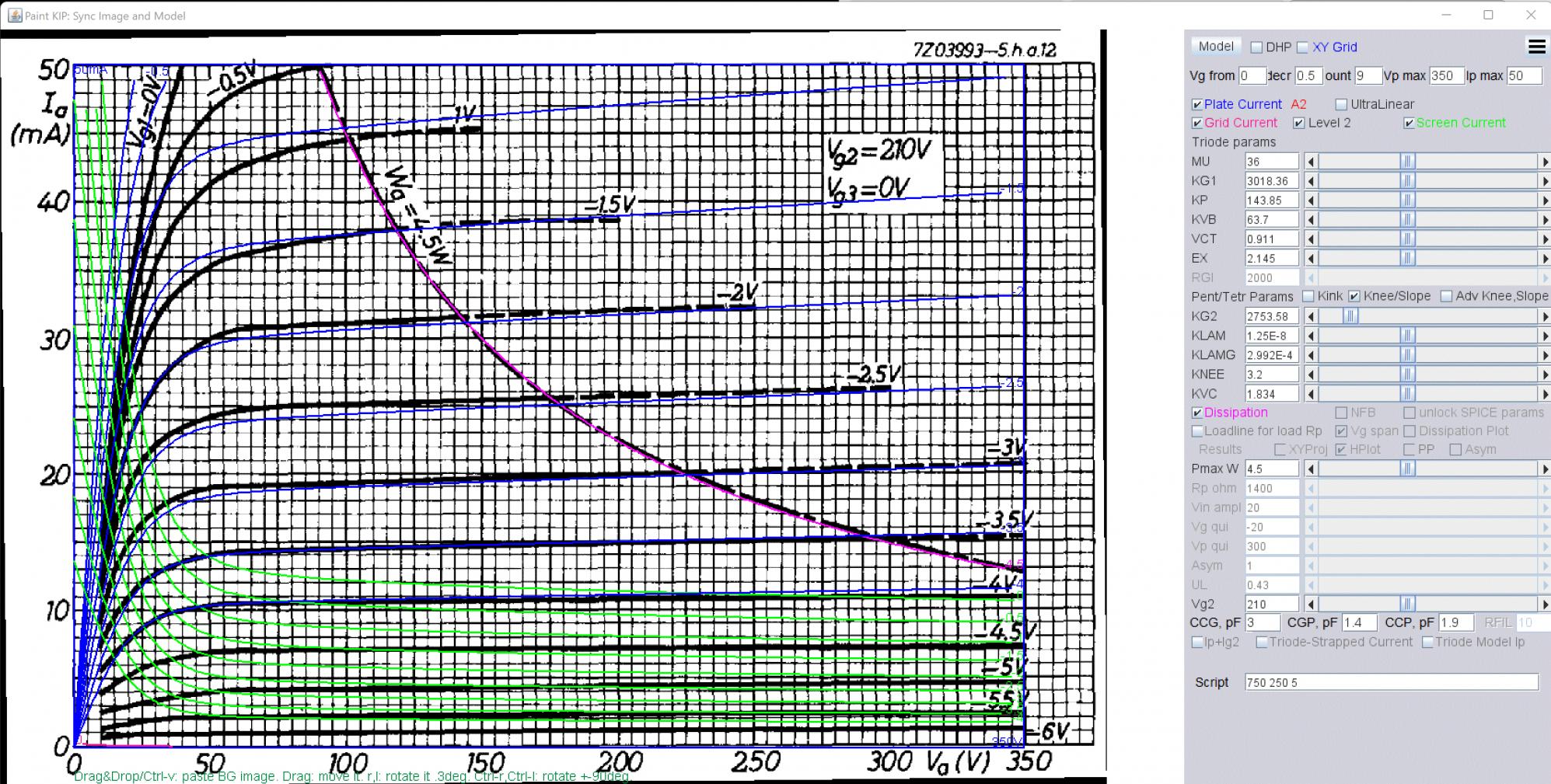

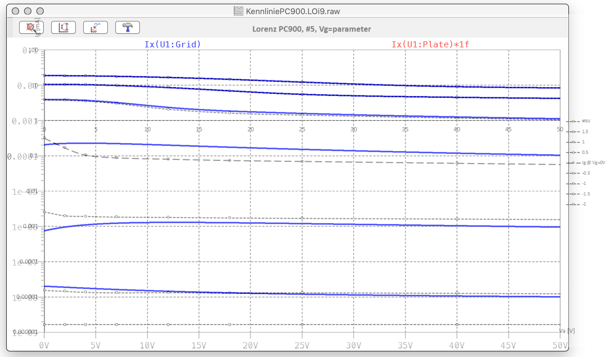

Hi Koonw,
I managed to revise the grid current. See attached. However, I could not output the same model as your second note. There were a few added lines and changes in that model. If you have a new Paint_KIP.jar program, can you please share with me.
When I modified the model and plotted on LTspice, I found the model I modified did not show a high grid current at low plate voltage. However, it is not that critical for my simulation.
Below is my model modified according to your second note:
* Created on 11/08/2021 20:53 using paint_kip.jar
* Model Paint Tools: Trace Tube Parameters over Plate Curves, Interactively
* Plate Curves image file: E81LPA.gif
+ PARAMS: MU=36 KG1=3018.36 KP=143.85 KVB=63.7 VCT=0.911 EX=2.145 KG2=2753.58 KNEE=3.2 KVC=1.834
+ KLAM=1.25E-8 KLAMG=2.992E-4 KNEE2=20 KNEX=30 KNK=-0.044 KNG=0.006
+ CCG=3P CGP=1.4P CCP=1.9P VGOFF=-0.6 IGA=0.001 IGB=0.3 IGC=8 IGEX=2

The i5 is probably the best tested triode spice model ever. Regarding convergence, I learnt that DC-coupled circuits are much more difficult. So I started to test my beta versions with a tube OpAmp circuit containing 10 triodes!
But the ultimate test circuit was a 1bit-ALU (Arithmetic-Logic-Unit) made with 39 (!!) triodes, challenging my beta versions a lot. ;)
So, if a crazy guy wants to simulate a tube based number cruncher, this is possible now!
But back to the first i5 model:
It's the PC900/6HM5, a (semi) remote cutoff triode. For such triodes, the curves at higher Va voltages are special shaped. The i5 is the first model which is able to mimic such characteristics with a satisfying result.
All PC900/6HM5 electrode constructions seen so far were identical (although from different companies), so I assume that there is only 1 construction existing for that tube, and so I skipped the both manufacturer letters in the suffix - no need to distinguish between companies for this tube.
