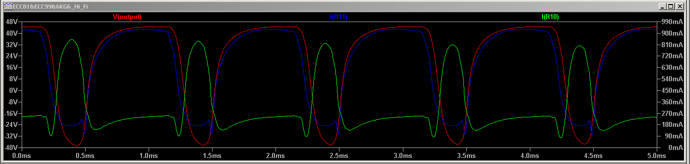

Hi, I've used the following LTSpice models:

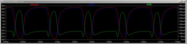

...but results are not good on simulations.
I attach the LTSpice asc file to make everyone able to find a solution.
  • ECC81&ECC99&6KG6_Hi_Fi.asc

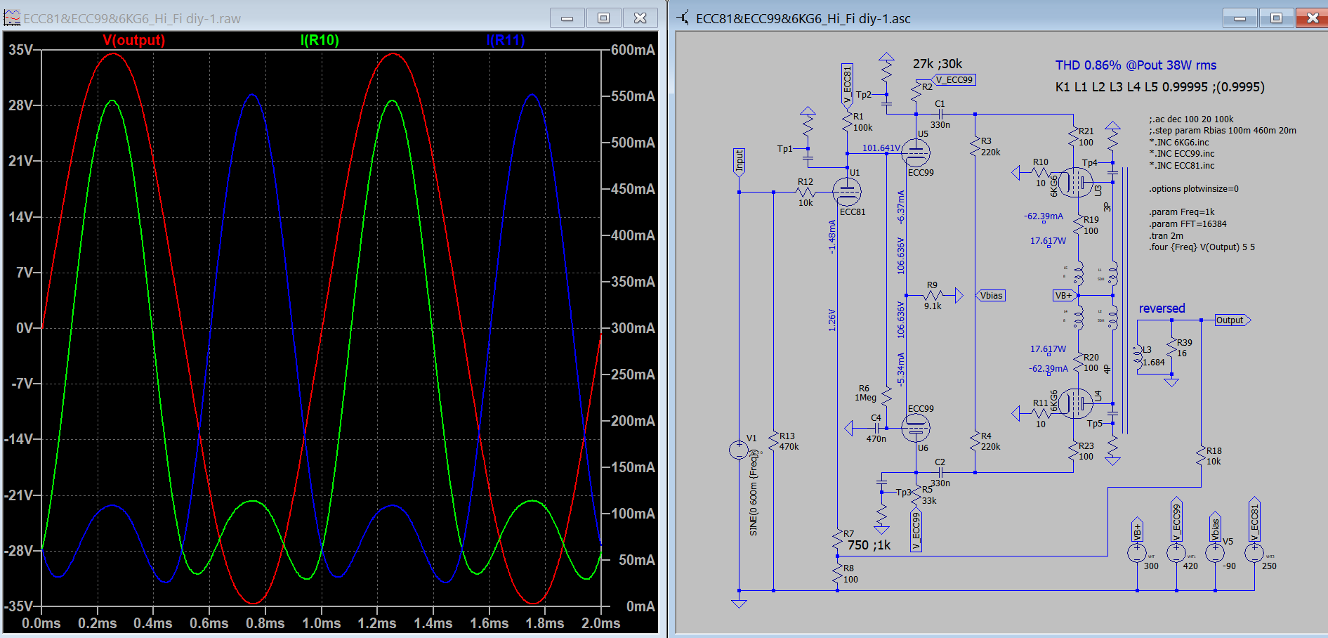

I made a few mods mainly to increase the coupling factor K from 0.9995 to 0.99995 to make the oscillation disappeared. In real amp the K factor is calculated from leakage inductance K=sqr((Lpri-Ll)/Lpri) where Lpri=primary inductance and Ll=leakage inductance. Other mods are to make the PI output more symmetrical. From sim we see the bottom cathode tubes current waveform is not straight (hump) indicated cutoff has ringing, may to increase grid bias to increase overlapping region or increase the driver current. Also the series resistance of OT should be adjusted.

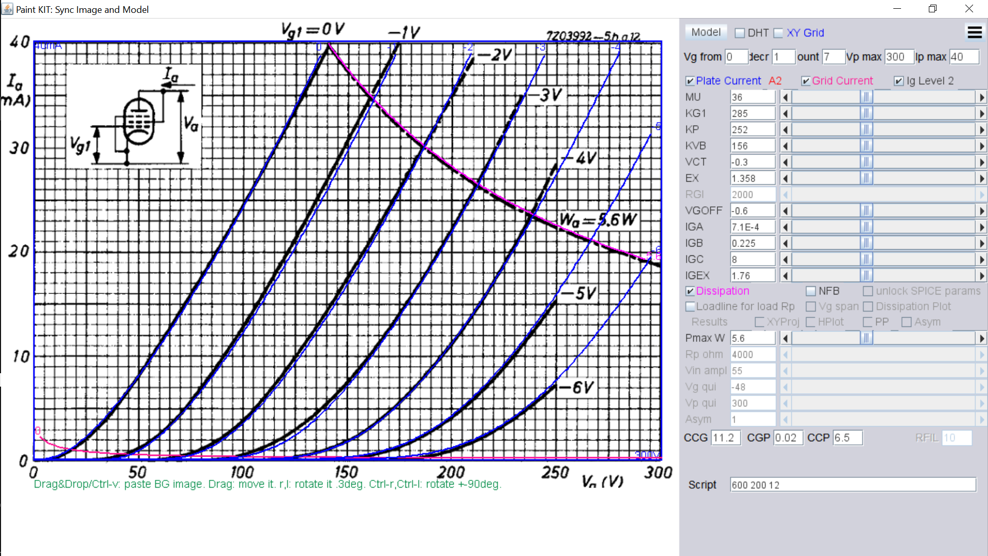

E81L triode model:
Code:
* Plate Curves image file: E81L-T.png
 * Data source link:
.SUBCKT TRIODE_E81L_T 1 2 3 ; Plate Grid Cathode
+ PARAMS: CCG=11.2P  CGP=0.02P CCP=6.5P
+ MU=36 KG1=285 KP=252 KVB=156 VCT=-0.3 EX=1.358
+ VGOFF=-0.6 IGA=7.1E-4 IGB=0.225 IGC=8 IGEX=1.76
* Vp_MAX=300 Ip_MAX=40 Vg_step=1 Vg_start=0 Vg_count=7
* Rp=4000 Vg_ac=55 P_max=5.6 Vg_qui=-48 Vp_qui=300
* X_MIN=44 Y_MIN=30 X_SIZE=813 Y_SIZE=542 FSZ_X=1296 FSZ_Y=736 XYGrid=false
* showLoadLine=n showIp=y isDHT=n isPP=n isAsymPP=n showDissipLimit=y
* showIg1=y gridLevel2=y isInputSnapped=n
* XYProjections=n harmonicPlot=n dissipPlot=n
E1 7 0 VALUE={V(1,3)/KP*LOG(1+EXP(KP*(1/MU+(VCT+V(2,3))/SQRT(KVB+V(1,3)*V(1,3)))))}
