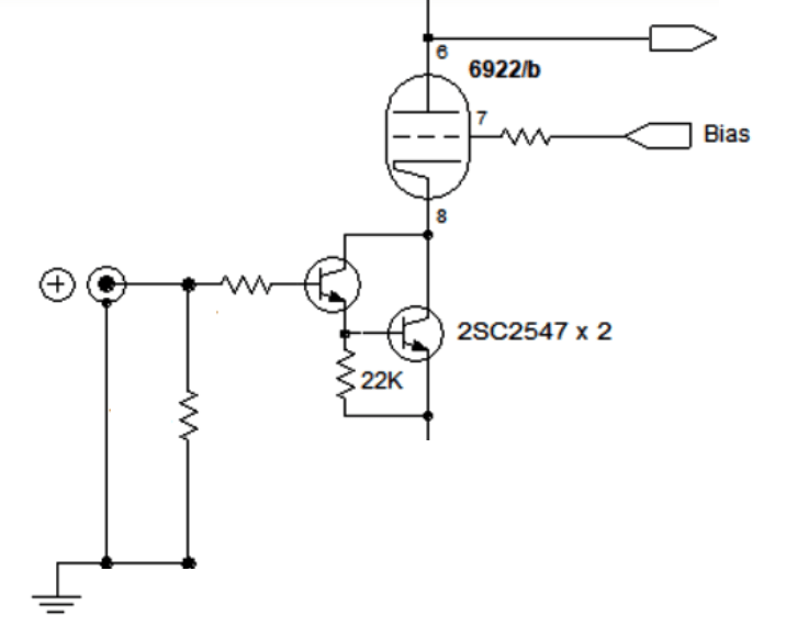

Terry,
Honestly said I'm a bit surprised to read this when you say that the 22k resistor will result in only 30uA current. Joe is talking about 4 - 5mA current and up to 9 - 10mA depending on the Anode resistors under #810. Your remark would imply that the 22k resistor needs to be lowered significantly in order to receive a much higher current or not? And Joe is even suggesting to leave the 22k resistor out and that would be the equivalent of having a resistor with infinite high resistance at that particular position so quite the opposite. So I'm wondering what is right and what is wrong here.
Could you comment on that? Thanks
Günter
Gunter,
Actually it will probably be about 40uA through first transistor. Lets call the B-E voltage of 2nd BJT 0.68V so 0.68/22000= 30.9uA but there will also be some small
amount of additional current coming from base of 2nd BJT, maybe 10uA max depnding on its Beta. So total will be around 40uA max.
TCD

The stage I posted in #803 and here is the part where the Darlington pair sits:
As we both know, I do not use 2SC2547 pair. They are different, as per our dicussion.
Joe, that discussion was quite some time ago and centered around your application (why doesn't that surprise me :) ) so my recollection of it is minimal.
There are thousands of IP devices that you can use and from memory the part I was advising you on was the use of mixed property BJT's in the Darlington pair
to obtain some of the benefits of each different BJT.
But there was something that emerged afterwards that we never discussed. That 22K limits maximum voltage swing in that particular application, for example if this was a power amp and not a preamp. If you don't need to swing a lot of volts coming off the Anode of the 6922, then I would use 1K. If this was used in a power amp, then you cannot use anything that low.
The 22k resistor looks very much like a current source to the first BJT's emitter. I'm not sure how this will limit maximum voltage swing. Can you clarify this.

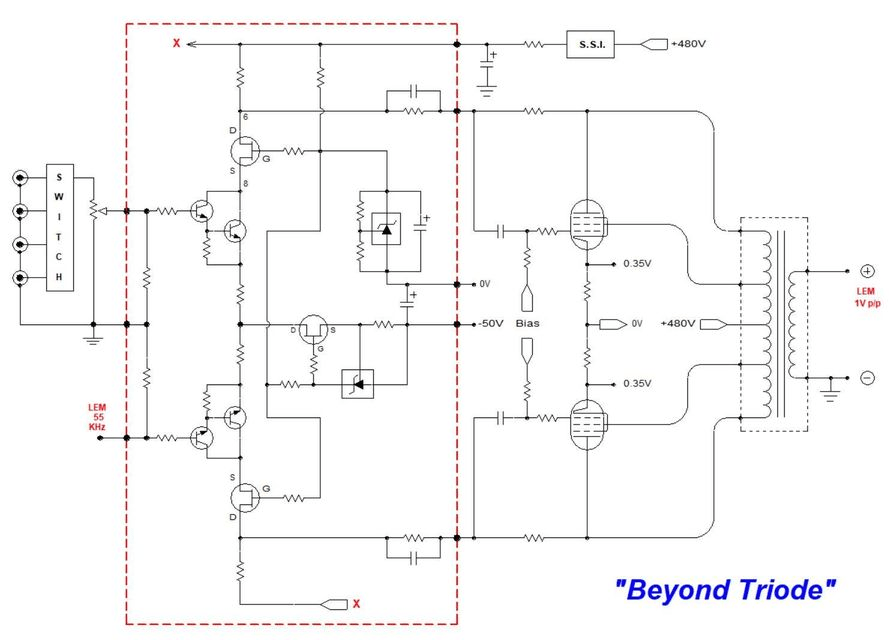

In the power amp I have here, that needs to swing 200V, then no resistor can be had in that circuit. The output is current and that is current driving the 6922 through the Cathode. The Darlington is a transconductance stage, volts converted to current.
Yep, it's a cascode... V -> I -> V :)
That resistor, depending on value, analyse the circuit and it will limit the final voltage swing the stage can achieve.
Like you said, there is a compromise(s) to be made.
Cheers, Joe
How so?
I have a spice model of this stage up and running, give me some R values, supplies etc etc and I'll pump them through, see what the results are.
Cheers
Terry
Hi Joe and Terry,
Thank you both for plenty of information.
As I said already earlier I might give this circuit a try in the RTP3 phono stage replacing the MAT02's.
I would suppose that getting lowest possible noise there is definitely important and limiting voltage swing is not important considering the low output
of a MC cartridge.
So for a phono amp I think using 22k makes no sense at all. 1K could be ok and maybe using no resistor at all in that particular position is best in order to get low noise and maximum gain, right?
Would be keen to hear your opinions.
Günter
I would suppose that getting lowest possible noise there is definitely important and limiting voltage swing is not important considering the low output of a MC cartridge.
Spot on Günter. Something like 1K should be a good choice and the input transistor will be set at around 0.6mA constant current (as Terry said, it acts virtually as a current source). I think Terry would approve as well, but I will leave that to him. MAT02's as well. (y)
As it turns out, in Ltspice the size of the B-E resistor on IP BJT, (22k) actually doesn't make much difference to the distortion numbers. I thought it might but that is not the case.
Probably because it does act much like a CCS and there is very little current modulation through the IP BJT.
So for a Phono IP stage probably best approach would be looking at optimizing noise. A single non darlington IP pair will be superior noise wise.
I'm not sure what major advantage the darlington brings to the table here except slightly higher IP Z and lower IP bias current.
Joe?
TCD

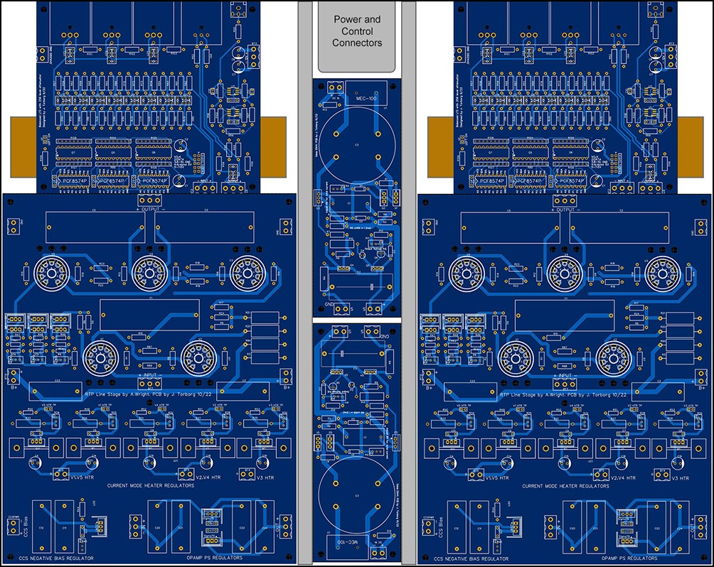

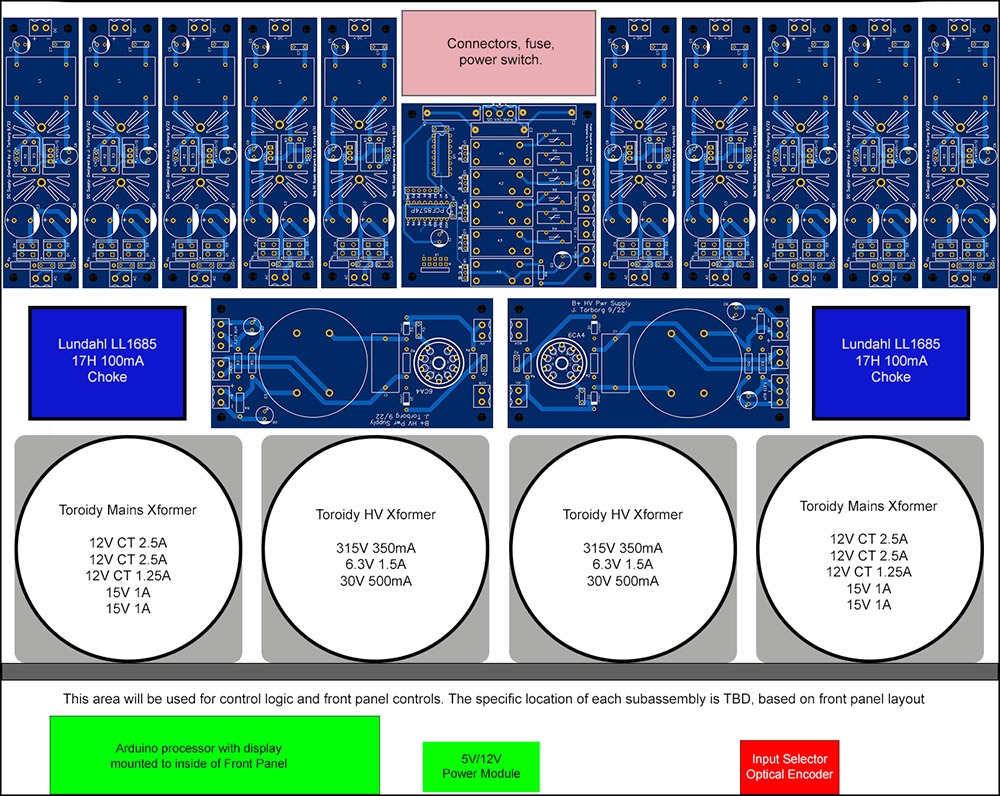

I started working on a build a couple of months ago. I am building a line-stage only preamp that will use Allen’s RTP3C line-stage design, but I’m not trying to build a clone of his preamp. My build will use custom PCBs for everything. I’m mostly still in the planning/design phase, but I have fabricated a few of the power supply boards to do some testing.
I am building a two-chassis implementation, but the power supply chassis will include all the front-panel controls. I am using a custom-programmed Arduino to control a 256 level relay stepped attenuator with 0.25db steps (to provide enough precision for balance adjustment). I’m also using relays for input selection, output muting, and power supply control. A color TFT display will show input selection, volume level and other information.
The power supply is completely separate for each chassis from the transformers forward. I’m using separate transformers for the heaters and the B+, etc., so that they can be turned on separately. These will also have an Arduino-controlled soft-start.
The B+ supply will use a cLCLC filter into a Salas HV shunt regulator. The first “c” is a small (1-2uF) cap to adjust the shunt regulator input voltage. The first choke is a 17H Lundahl choke. The second is a Tent Labs mini-electronic choke mounted on the shunt regulator board. All caps are film caps. The larger ones are ClarityCap TC4s.
The heater supplies use two-stage regulation, with three regulated supplies (elevated to different voltages) in the power supply chassis, and individual current regulators for each tube close to the tubes in the line stage. The current regulators are adjustable from 260mA to 380mA to support a variety of tubes.
I also have an op-amp (OPA1612, OPA1611) based single-ended output for my subwoofers. This is also powered by a two-stage regulator using 1085s in the power supply chassis and Sparkos regulators near the op-amps.
Below are images showing the PCB layouts in the two chassis. Two DC umbilical cables between the two chassis will provide power to the two channels. A 9-pin D-Shell cable will be used for serial communication to control the attenuators, input selectors, and output muting relay.

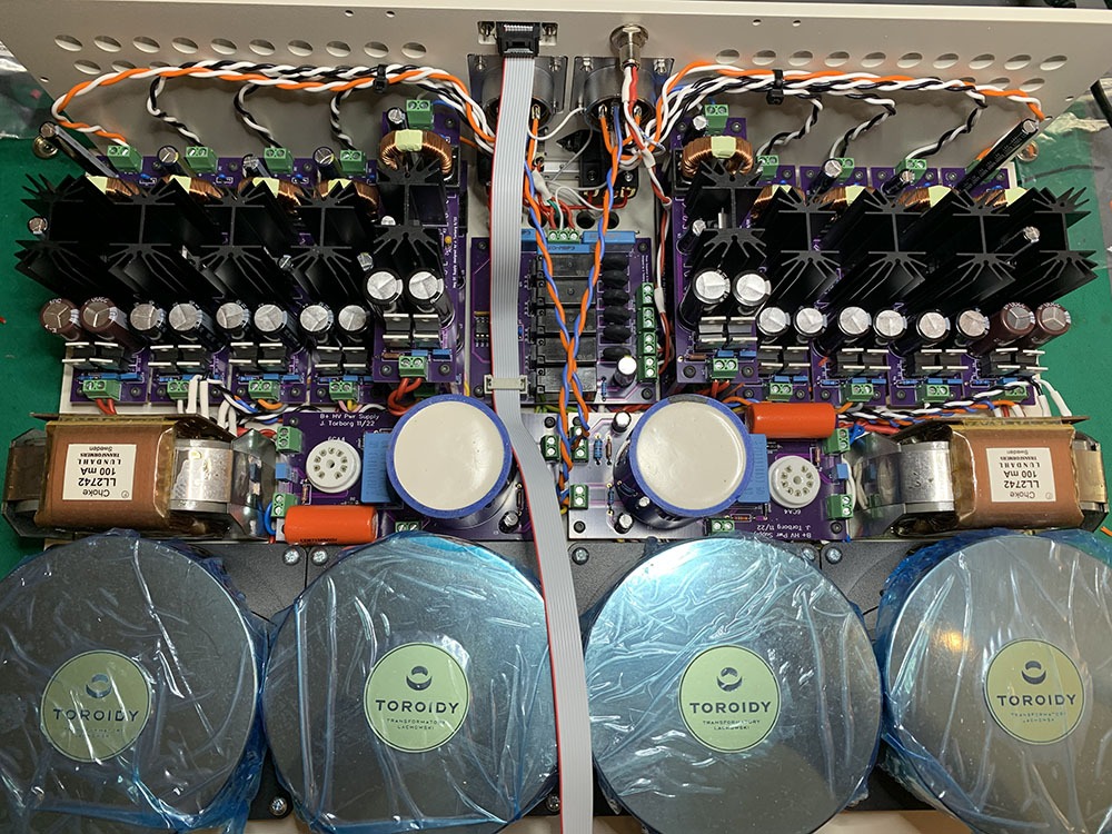

I've made some slow progress with my build. It's been a very busy several months with work so I haven't had much chance to work on this. I've finished building the power supply chassis (at least the power supply part), and am close to finishing the front panel circuitry which uses an Arduino DUE for control with a front-panel TFT display. I'm going to route the ribbon cable under the HV power supply board and transformers. This connects to a custom Arduino Shield PCB mounted to the front panel, which will sit in front of the transformers.
I've done some redesign of the PCBs for the second chassis to move the regulated op-amp supply to the input/output board (which has the input relays, stepped attenuator, and op-amp buffer for the subwoofer output). This tightens up the layout of both boards. I haven't fabricated these boards yet and am still fine tuning the layout. But I hope to start work on these in the next month.

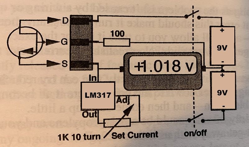

Another reason to read The Tube Preamp Cookbook is that it contains a neat little circuit for matching J-FETs. Whether you will be using (increasingly scarce) 2SK369s, as in the earlier versions, or (readily available) BF245s, as used in the latest incarnation, they will have to be matched, obviously. Allen still sells matched pairs of 2SK369s.
Does anyone have the details of this test circuit? The circuit in both my copies of Allen's Tube Pre-Amp Cookbook (pdf and actual book) is illegible.
Thanks,
Karl

The circuit is scalable and fets could be used, by I want to do an all Darlington version, my tribute to Rowan I suppose. Trust me, Darlingtons are great and they are high input impedance. Small Fets sounds a bit lose or light in comparison. When gravitating away from tubes I have come to prefer bipolar over Fets, but it just depends. If you want to swing a lot of volts, I would use bipolar Darlington on the bottom and a high voltage HexFET that behaves a bit like a Pentode and get as little possible voltage swing as possible seen by the Darling pair. It just sounds great, can have a gain above 500 and swing 1000V p/p with the right Fet. No voltage on the gate, the Fet is current driven via Source. Like this:
