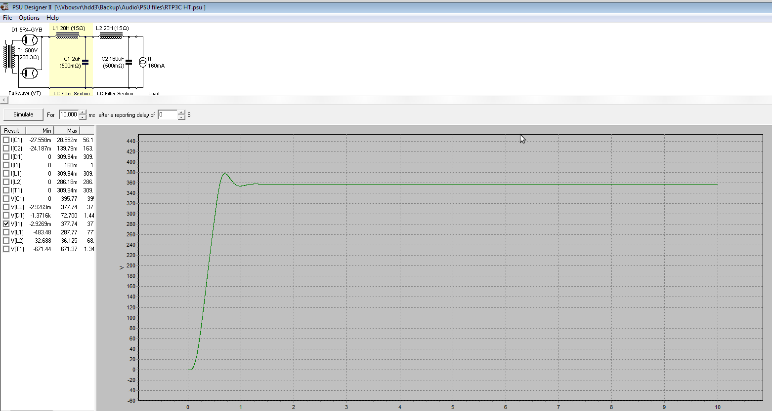

I strongly advise you to use the Duncan amp Power supply designer (free software)
to simulate all needed supplys thats really helpfull.

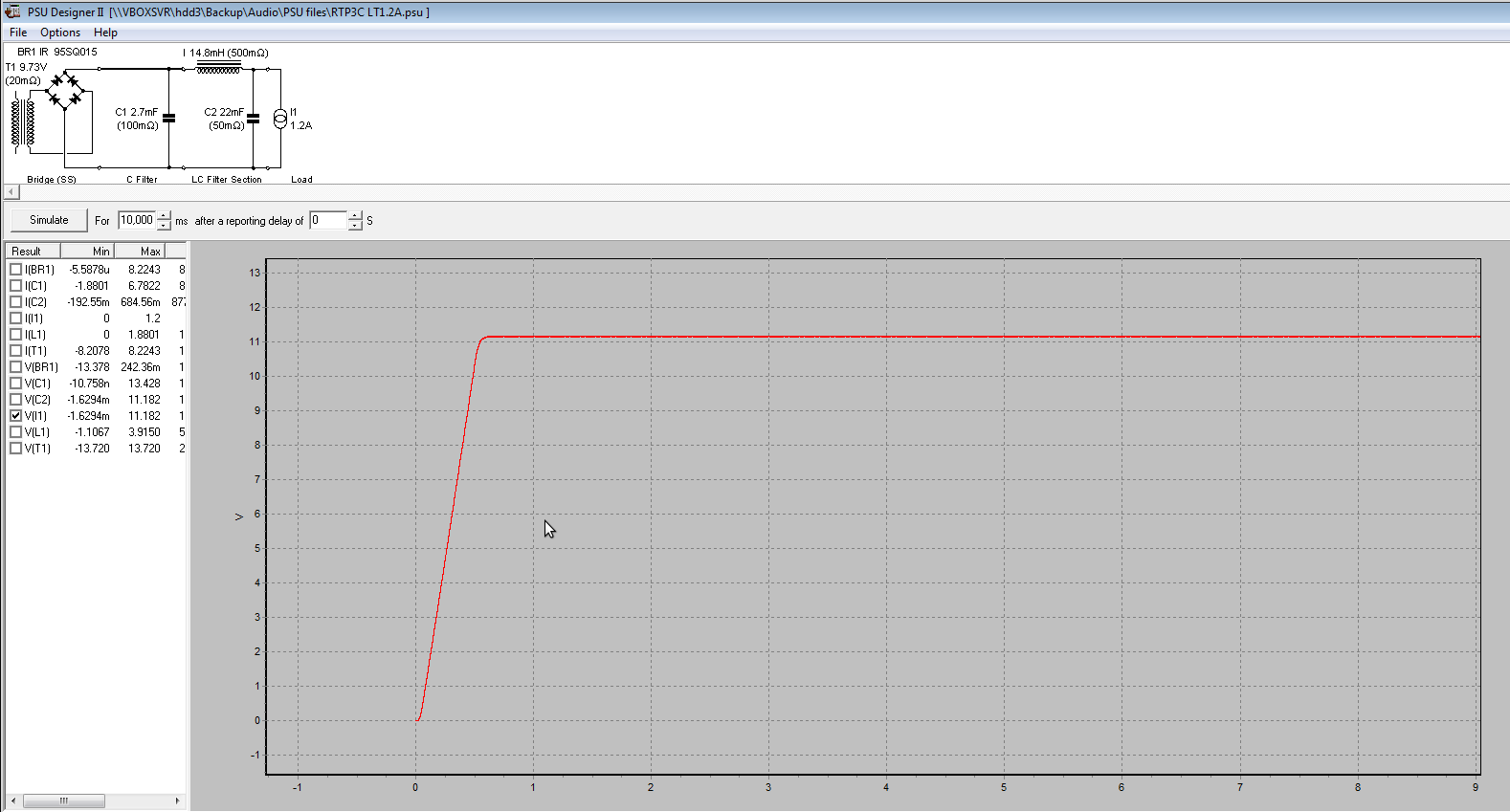

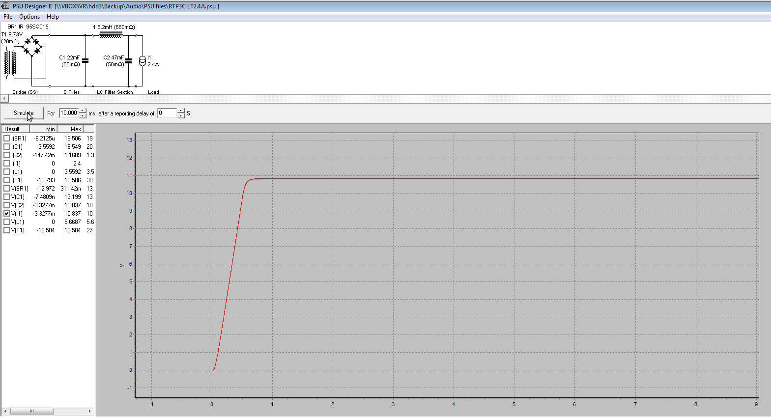

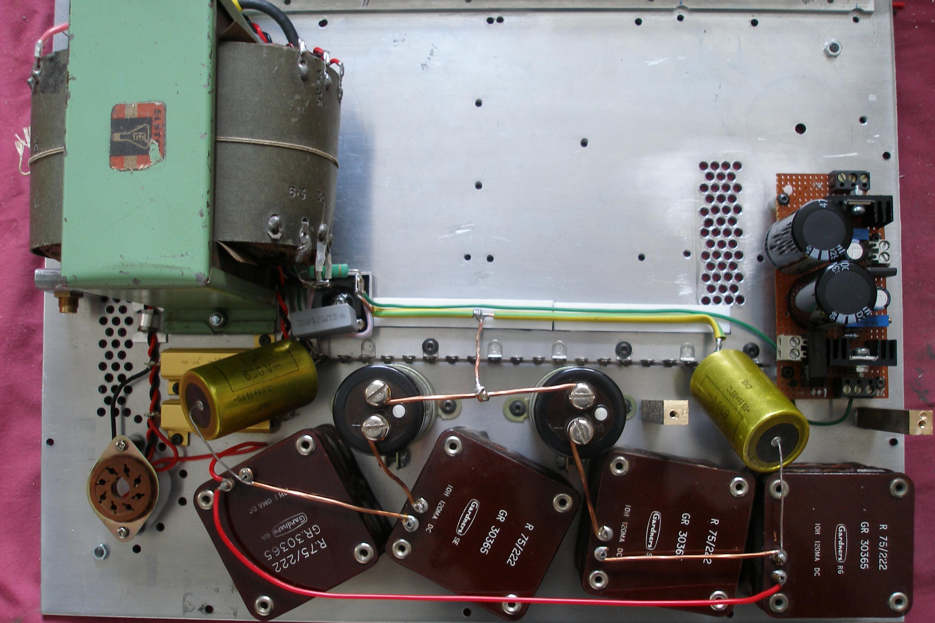

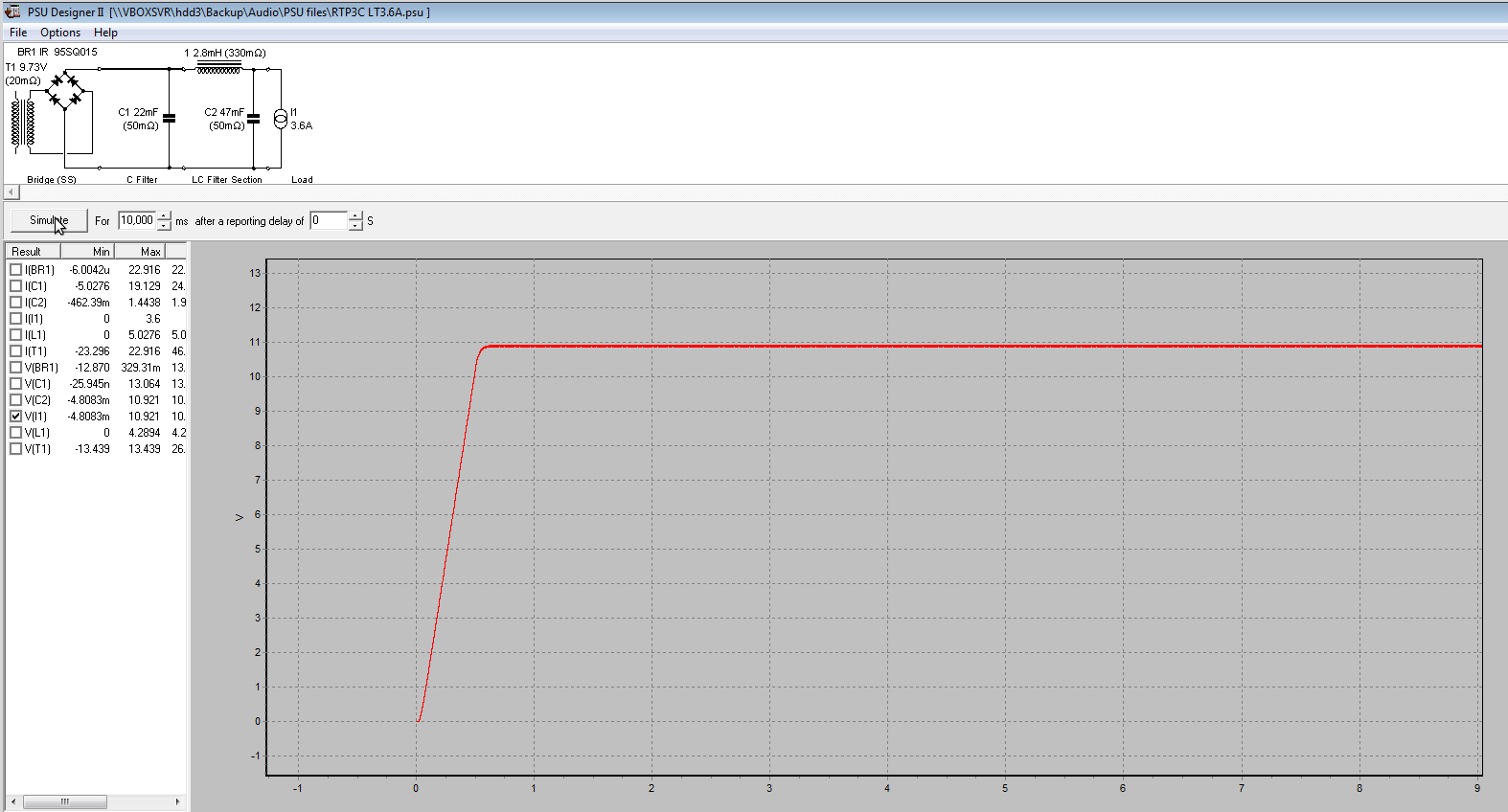

I've built the RTP3C with a separate PSU. The heaters are individually current sourced (LM317's) and adjustable for 0.3, 0.365 & 0.6 amps so I can put a variety of tubes in there! I've a 500va toroid with four 10v secondaries to supply the 3 elevated heater supplies and the timer circuit. A bit OTT really, but I was struggling to find an off the shelf TX with sufficient secondaries. A second smaller toroid supplies the LT for the line/phono boards and regulators.
There are 2 super regulators at 300v, (onboard the amp) sinking around 20ma each, so the HT is around 370v to give sufficient headroom. Although there is only one 500-0-500 TX I've split the left/right supplies after the rectifier. (Only because I had four 80ma chokes and thought I'd use them!) The TX came off EBay and is nothing special but works well. If you use regulators I would suggest that anything before it would be OK although Allen Wright did recommend choke input. I used PSUD 2 to design what I needed with the components I had.
Although the rectifier gives a slow start I've still used a 556 timer to give an adjustable delay to the HT. Tempting as it is to keep it turned on 24/7 as Allen Wright used to, it runs too hot and I'm too tight to pay for the electricity!
To be on the safe side I've used relays to switch off the HT should any of the heater supplies fail.
Dean

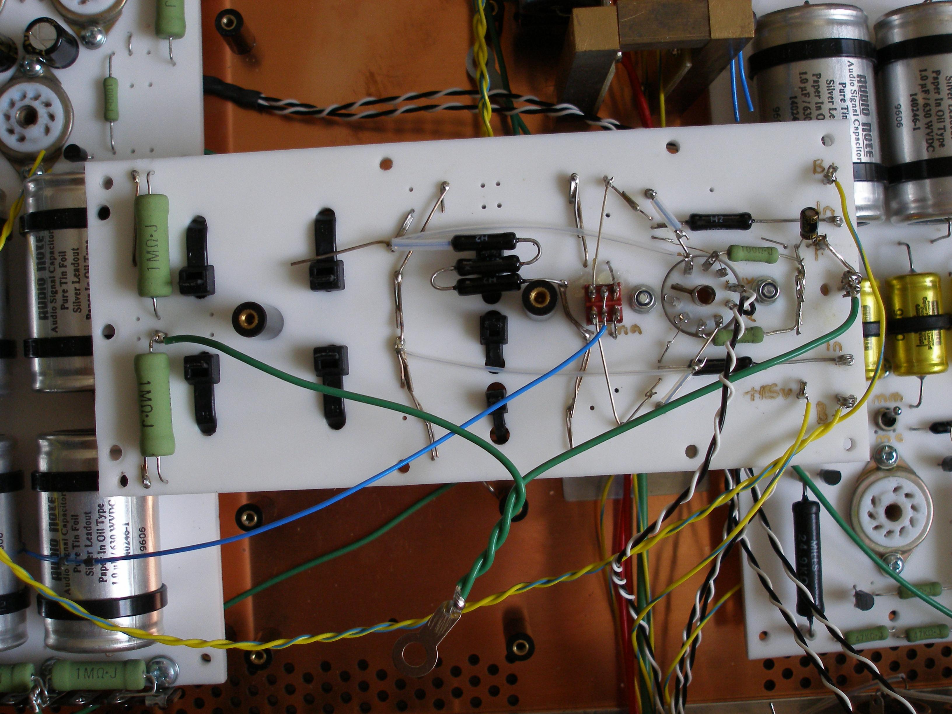

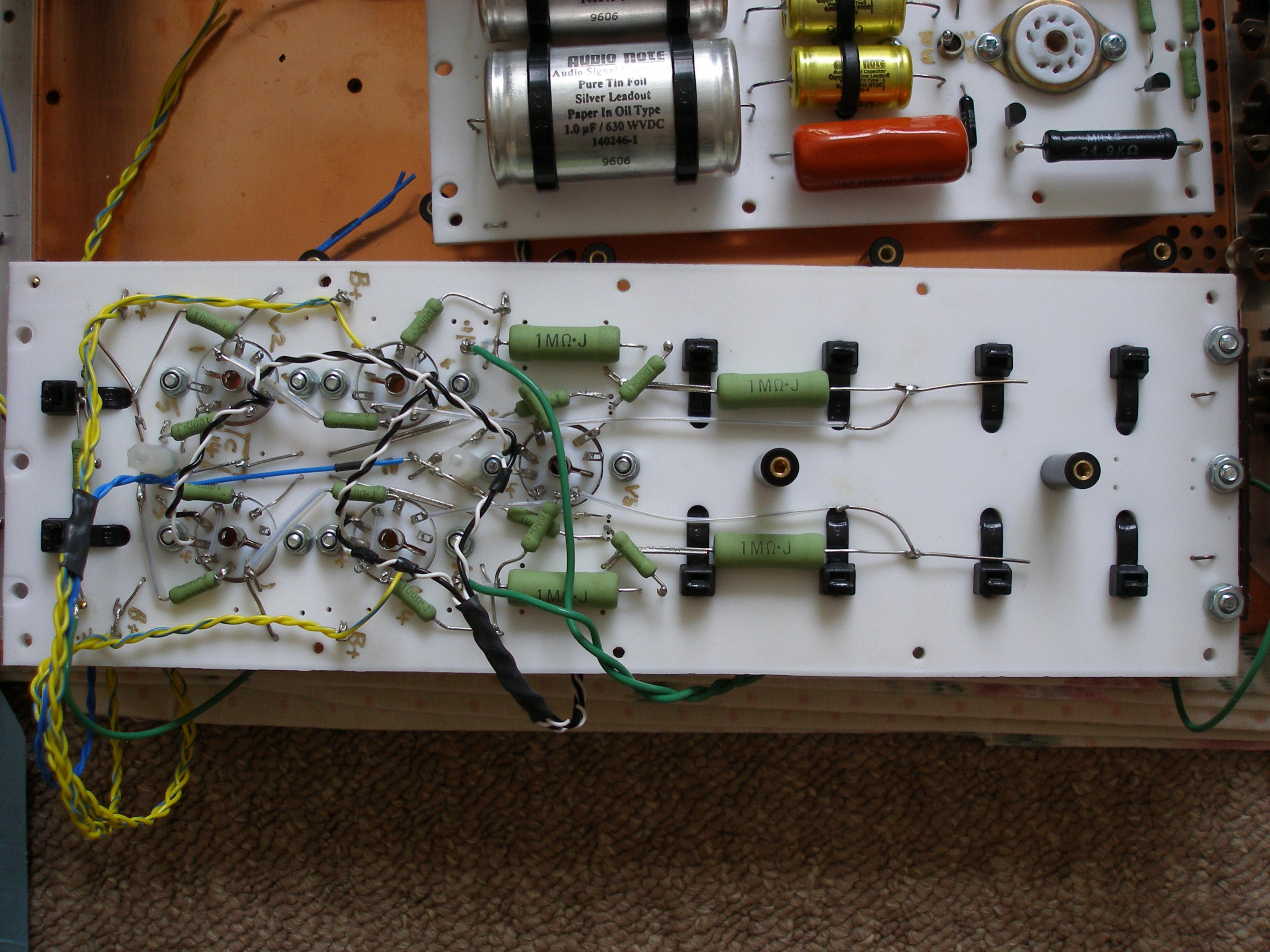

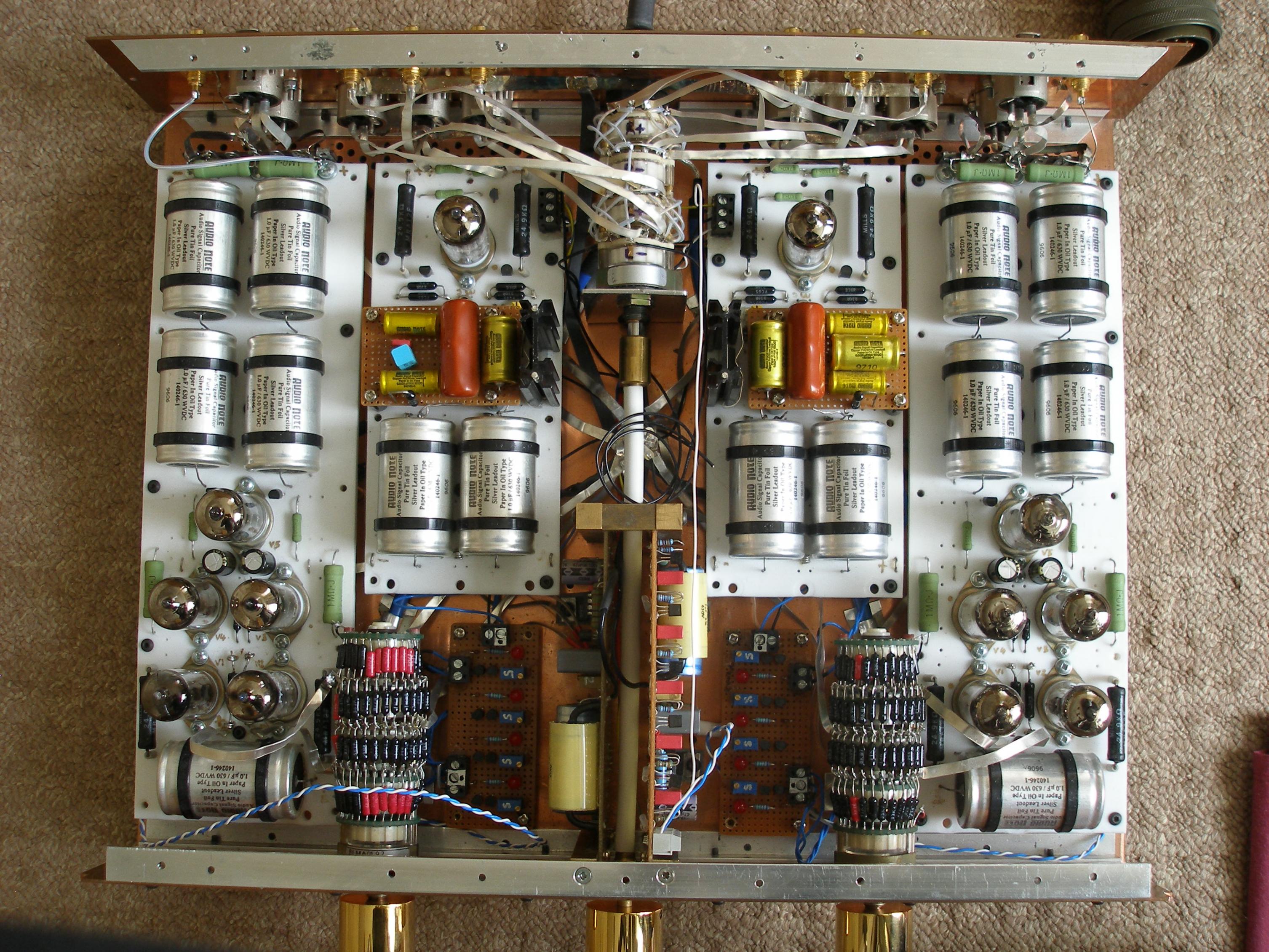

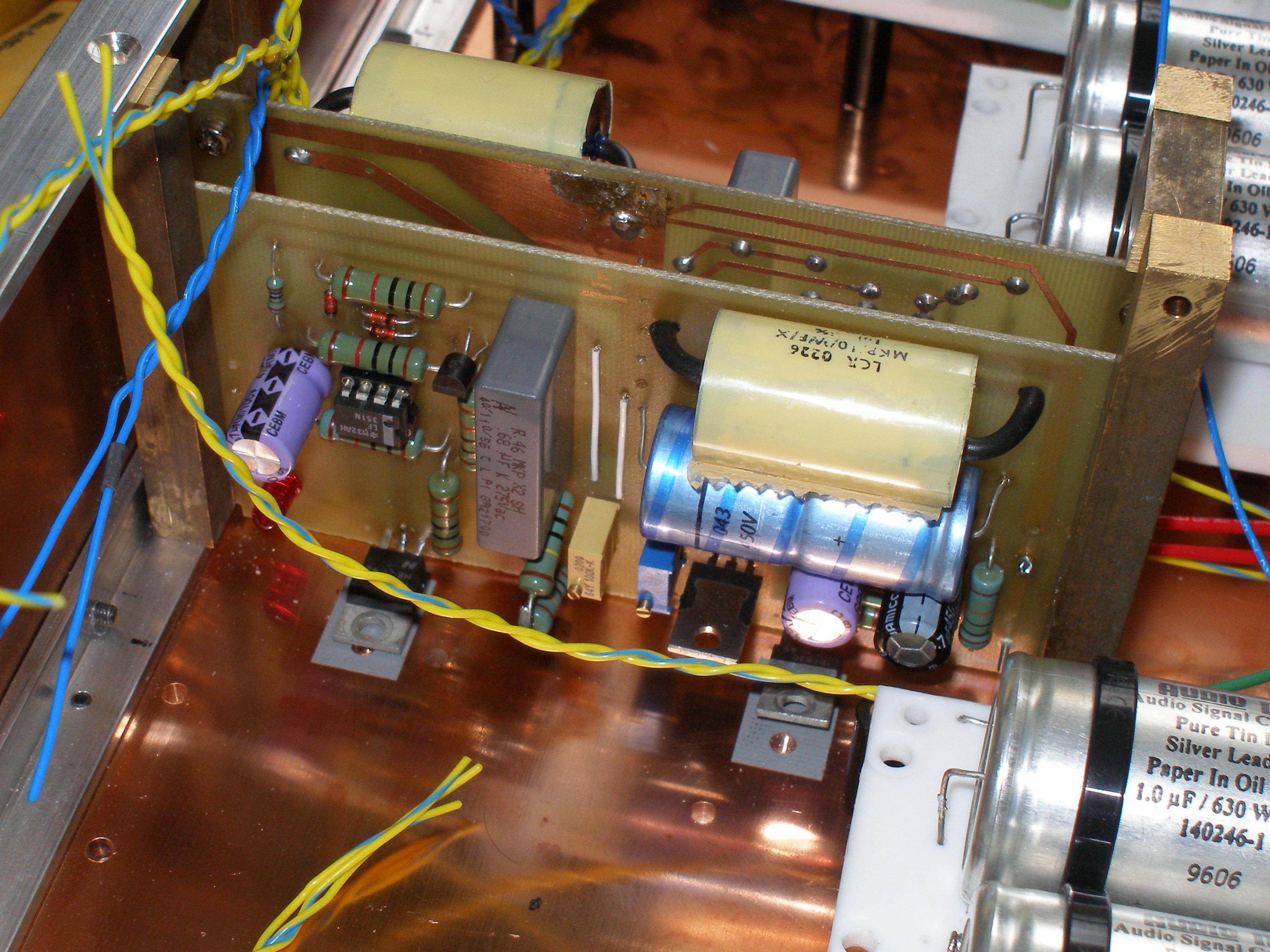

I'm having issues with the phono stage at the moment so can only comment on the line stage. (the more eagle eyed viewers will have noticed the phono boards are not connected to the selector switch) Well, what can I say? I was using Stevens and Billington TVC passive into JELabs 300b monoblocks before this and this beats the TVC hands down. Sound impressions are just so personal though so I wont go on and on about "spaciousness" and "dark backgrounds" blah, blah, blah!
I've been constructing this on and off for twelve years (I like a challenge) so I would say it sounds fantastic wouldn't I? Honestly though, my personal feeling is that it has fantastic potential which my other equipment currently doesn't fully exploit. My new project is to feed it from PC based music server through a dual mono balanced Sabre DAC and to get the pesky phono stage working. I'm only getting 20db gain on the phono with sk170's despite playing with the gain resistors. I'm going to try substituting those with SSM2212RZ before I investigate further.
Here's a few more piccys to whet your appetite. Everything built on 4mm PTFE in a copper chassis. Silver wire and silver foil except for power which uses multistrand PTFE silver coated copper. If I was building this again I would use rails to fasten everything to, as others have done, and make everything accessible from below. It's a PITA to do any tweaking as it is.
Initially I had a problem with noise but only because I had the line gain too low. I upped that and tweaked the input to my power amps which solved the problem.
I suppose that if you're on this forum then you know the potential of this amp. If you've not built one then give it a go as it's worth the effort just for the line stage! Some day I might get the phono working as well.
Very nice.
I'm intrigued by your gain problem with the phono stage. As a quick check, you could connect a pair of reasonably well-matched BC550s to see if the solid-state devices are the cause. This design is optimised for bipolar input transistors, rather than JFETs.
Have you measured the DC voltages on the anodes and cathodes of the valves? Is the standing current correct?
Alex

It stay fixed all by itself...Very nice! But how did you get the stuff fixed in the slut during soldeing???
