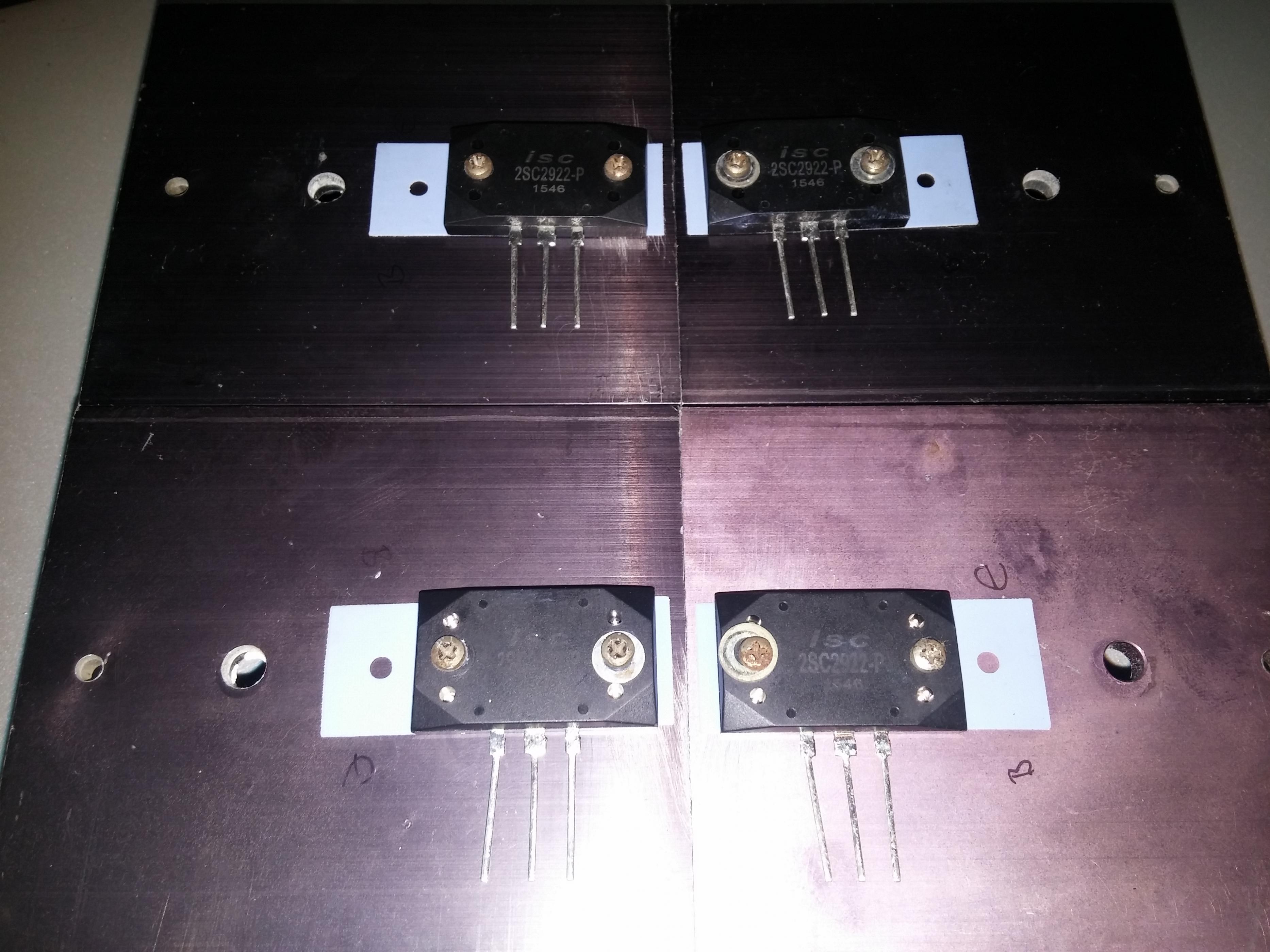

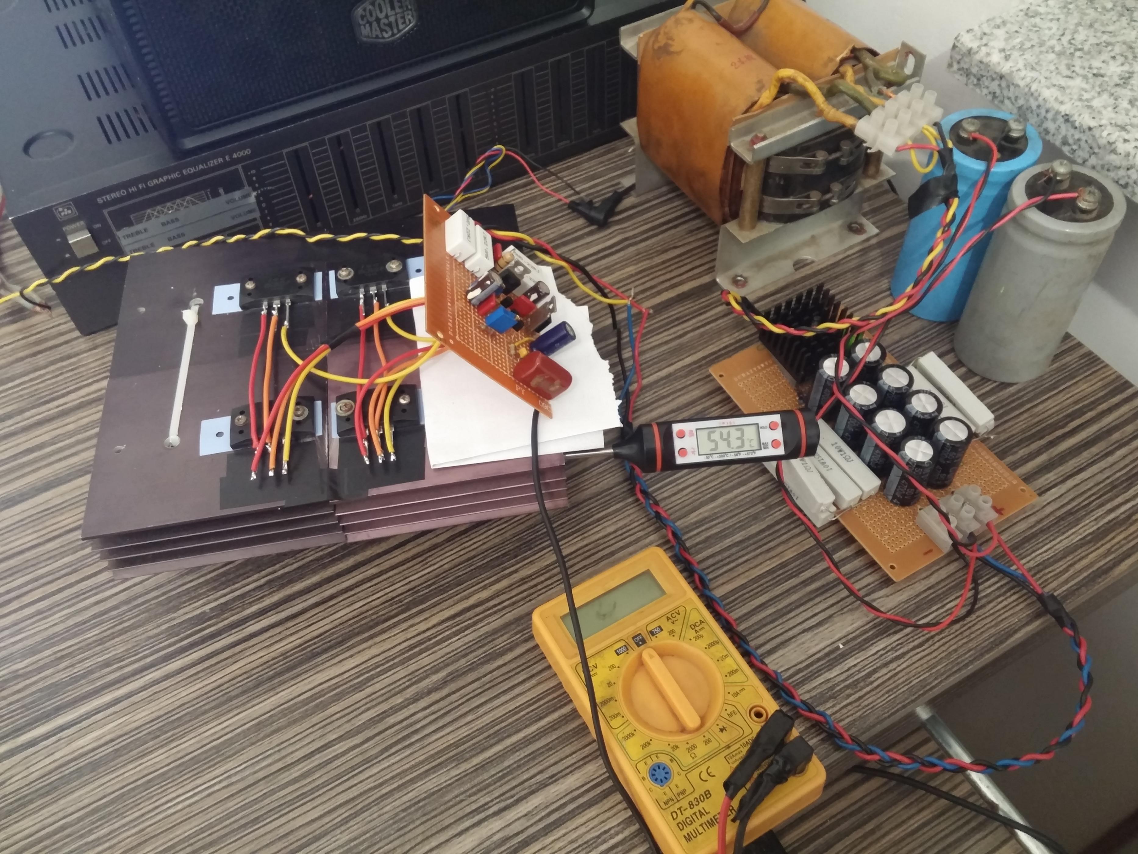

I bought some 2sc2922 from kessler-electronic at ebay, seems like a legit german seller. Works fine, pushing 1,5A per transistor in jlh 2005 test channel, sound is excellent:

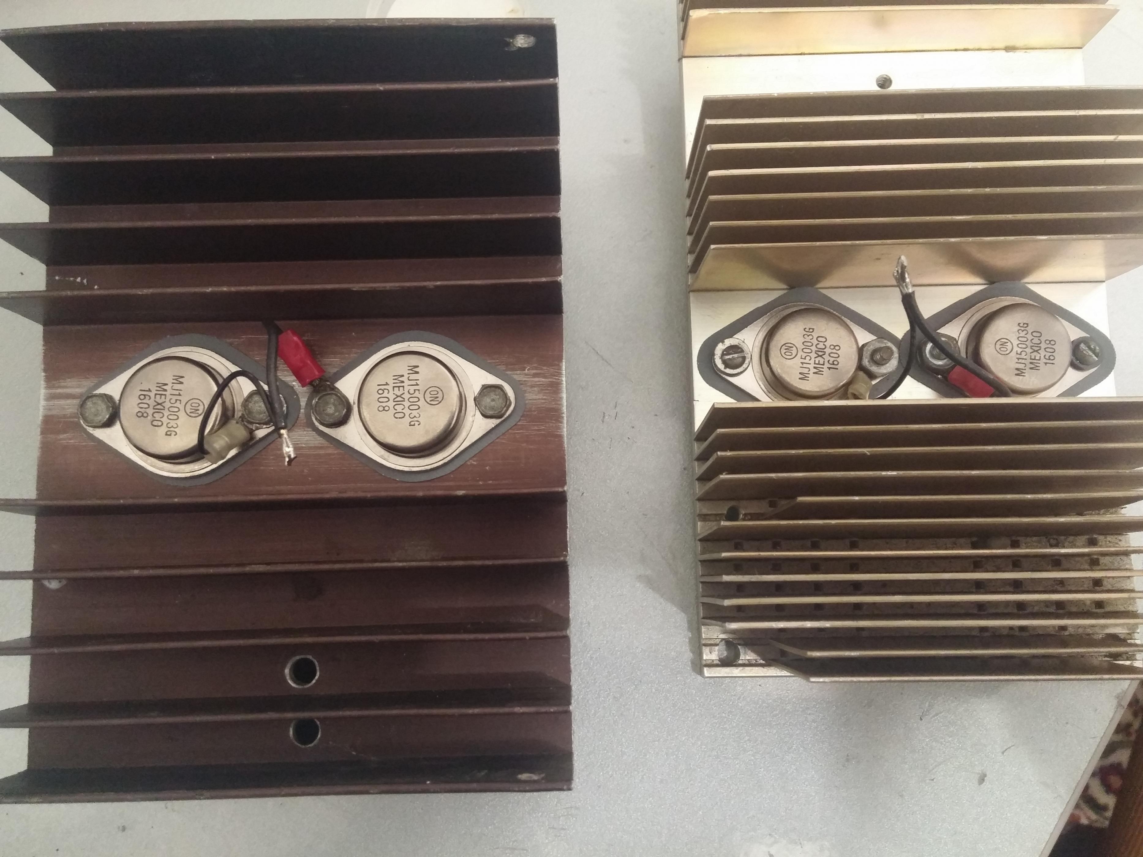

1pcs MJ15003G ON TO-3

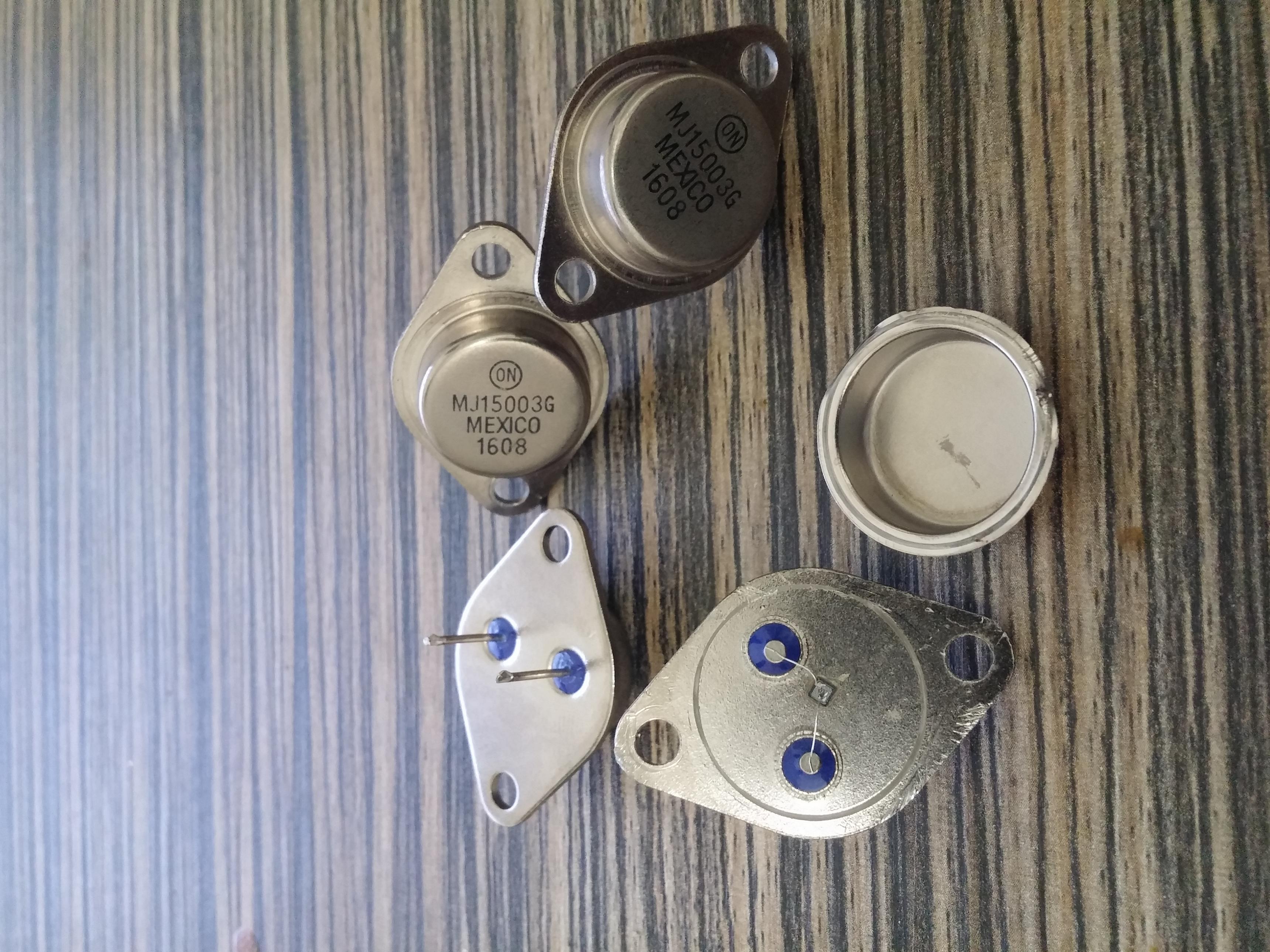

Right now preparing to test some cheap ON 15003Gs, I cant scratch or erase marking on them, looks good for now, but I'll wait for burning test in jlh 2005 test bench.

Those 2SC2922 in your first picture is produced by Chinese company ICS.
Inchange Semiconductor Company(ISC)
Whether they are good or not is not decided only by power handling, if those ICS generics have less linear Hfe, Ft Cr etc you may or may not notice much difference

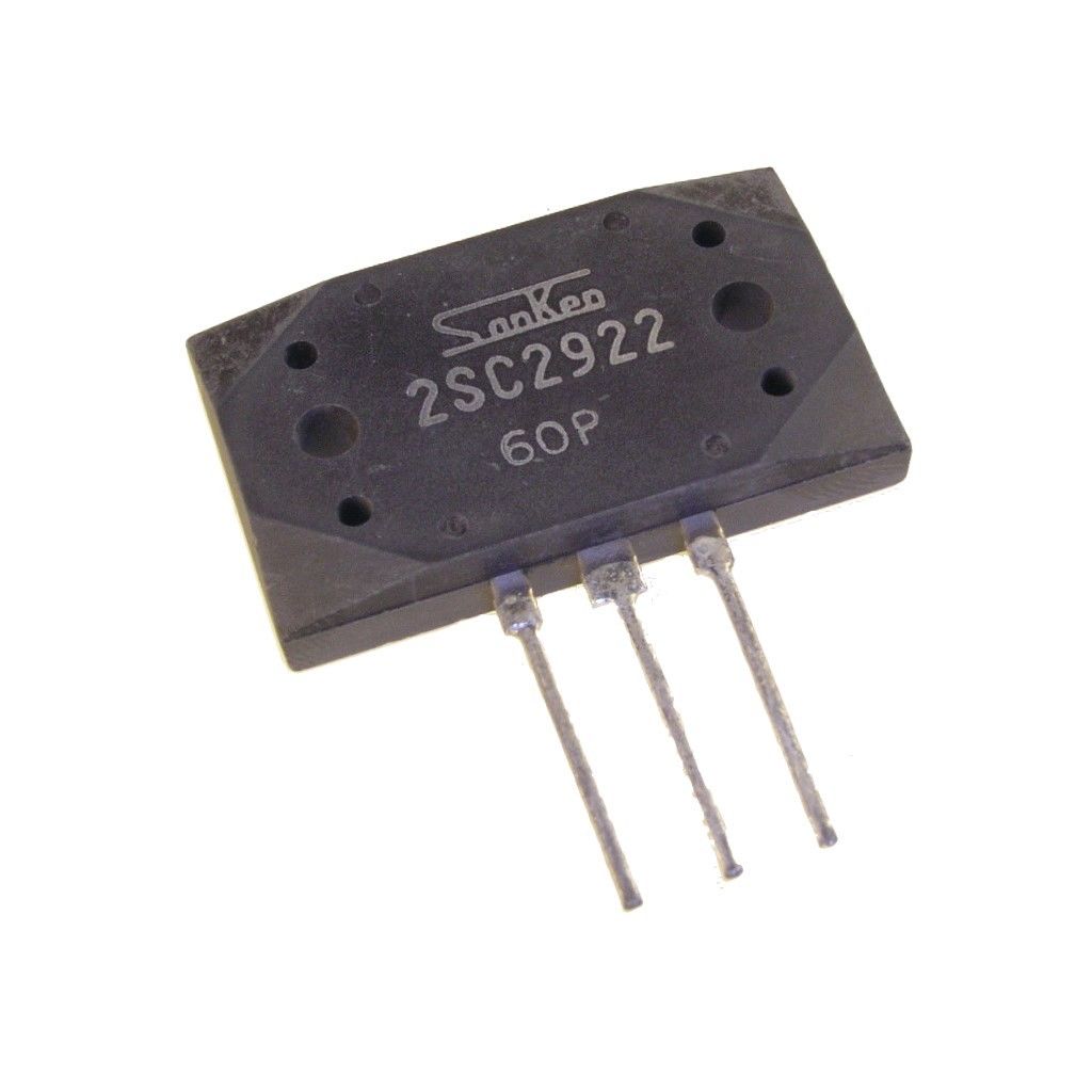

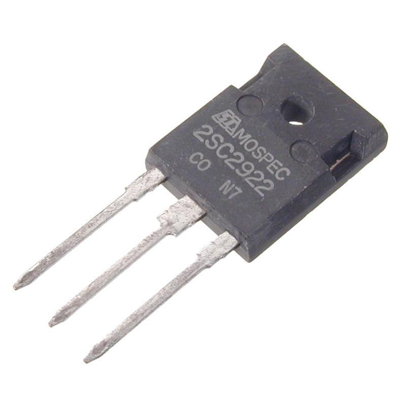

On Kessler Electronics eBay store I didn't find the one manufactured by ICS, but two others.
2SC2922 MOSPEC
and
2SC2922 SanKen
I'm aware of that, I ordered mospec version and got isc instead. Anyway, my experience is positive, no overheating, no smoke and they do sound excelent - better than my old original EI Nis 2n3055s. I guess they are not remarked fakes as cheap 2n3055s I got last time. And they pretty cheap too.

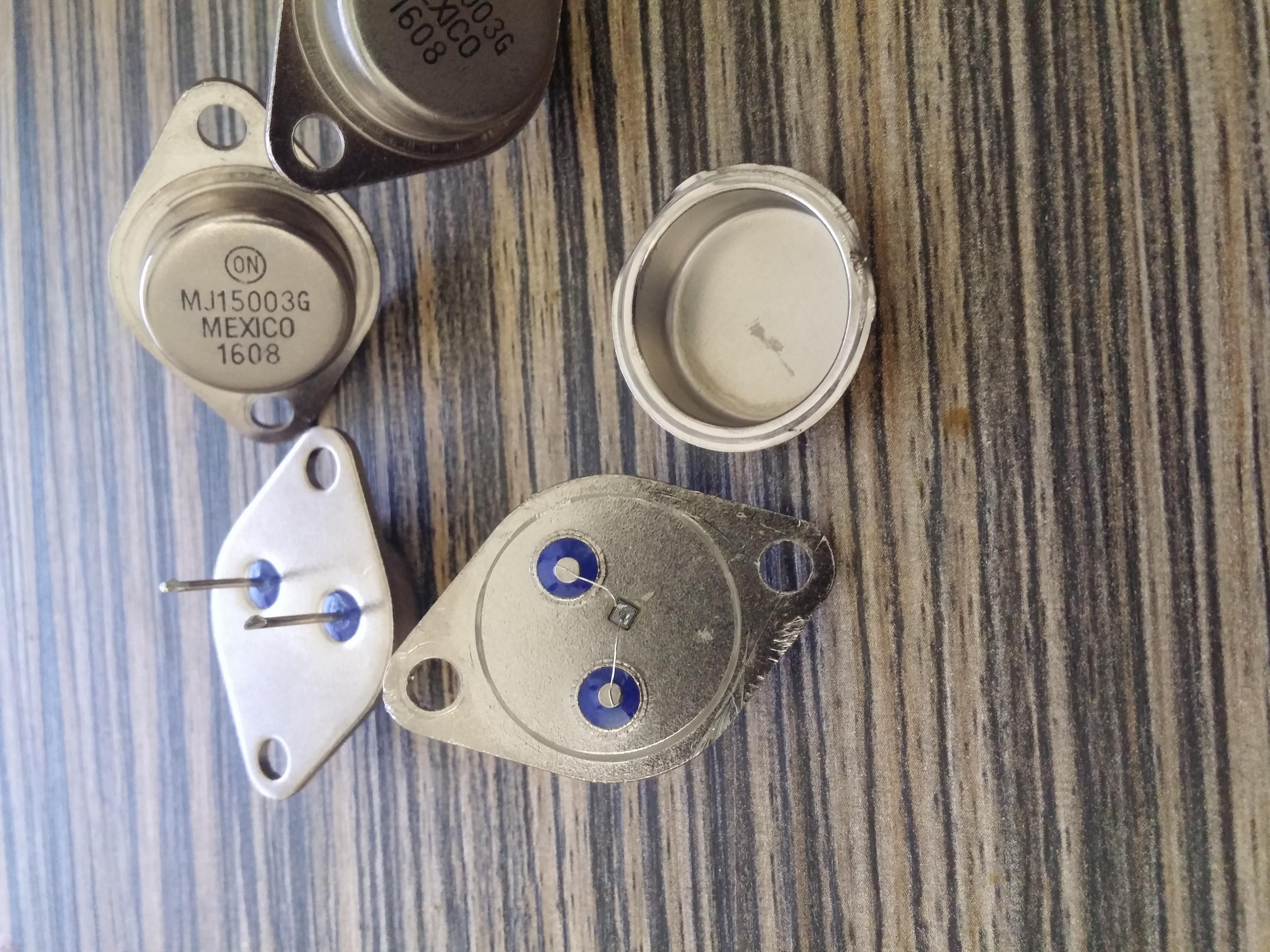

Just to inform you guys that my ON 15003Gs died instantly, luckily nothing else died so I replaced them with 2sc2922 and JLH 2005 is working fine .
I cracked open one of them and it seems that core is super small, so I guess fake 100%.
