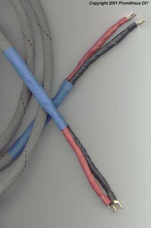

This is what they look like braided.

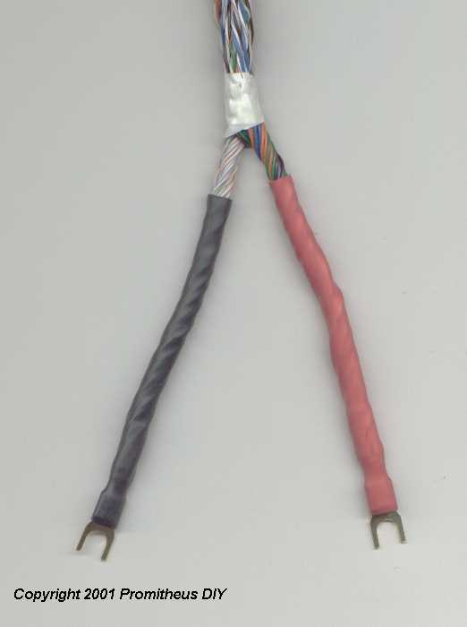

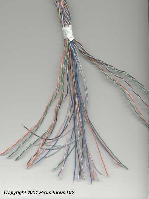

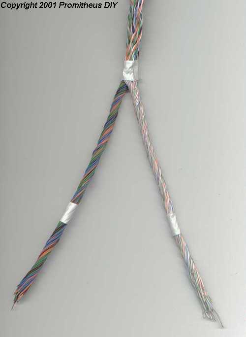

I once tried a CAT5 braid (after reading rave reviews all over the internet) as a speaker cable. My Adcom GFA 535 II went crazy (even though the clipping lights won't light up I could hear strange distortion). By the time I realized what was going on I had a blown tweeter on hand :(
