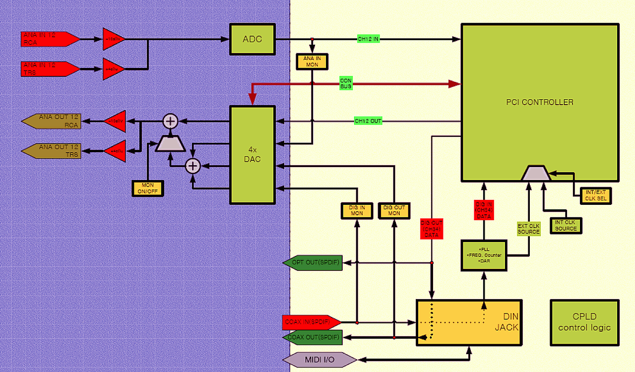

What I'm going to do is use the existing adc, dac and analog stage of a soundcard and replace the pci interface with an usb one, so that the soundcard can be used outside a desktop computer, from any laptop. The reason I'm doing it is that the Juli@ has extremely good performance for its price, especially on the adc side.
It is made somewhat easy by the fact that this particular soundcard is composed of two pcbs, one for the controller section, one for the audio processing.
Attaching some useful stuff. Here are the datasheets of the dac, adc and te7022l, as well as the block diagram of the card.

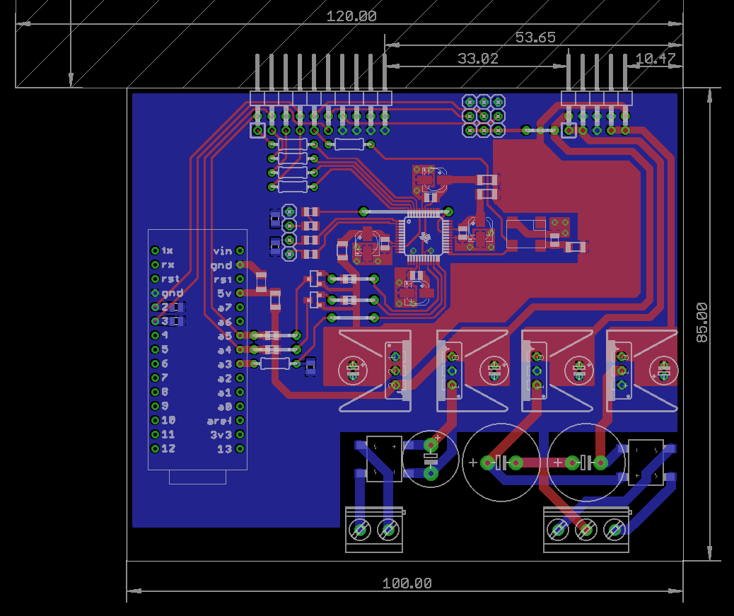

Having a bit of fun with Eagle. It all seems to fit on a 10*8.5cm board.
I'll post schematics later; they need clean up.
The overall config:
- an src4382 or 4392 serves as interface to the outside world. External I/O are made through spdif. The incoming signal is passed through the ASRC. A local 11.288mhz master clock is provided to the src and to the juli@ board, which runs at 24/48 (256fs).
- an arduino nano controls the DAC and the src through I2C. As the src runs at 3.3V, some level shifting has to be performed. The nano is also in charge of pdwn and reset condition as well as analog muting.
- the jumpers network on top is to control the analog mux (74hc4053a). I've no idea how they're setup so I can either tie the control lines to gnd or 5V.
- the board needs two ac inputs, one for 5/3.3v and one for +/-12v. The regs are simple lm7805, 7812, 7912 and 1117-3.3. The big plane on top is 3.3v.
There's one thing that still needs to be addressed and that's the lack of gnd lines on the big connector. It's frankly surprising from ESI's engineers. :confused: There was ample space to use a bigger connector and add some return lines. I think I'll do as they did and provide a metalized hole connected to gnd to strap the board together. Still not too happy about this.
