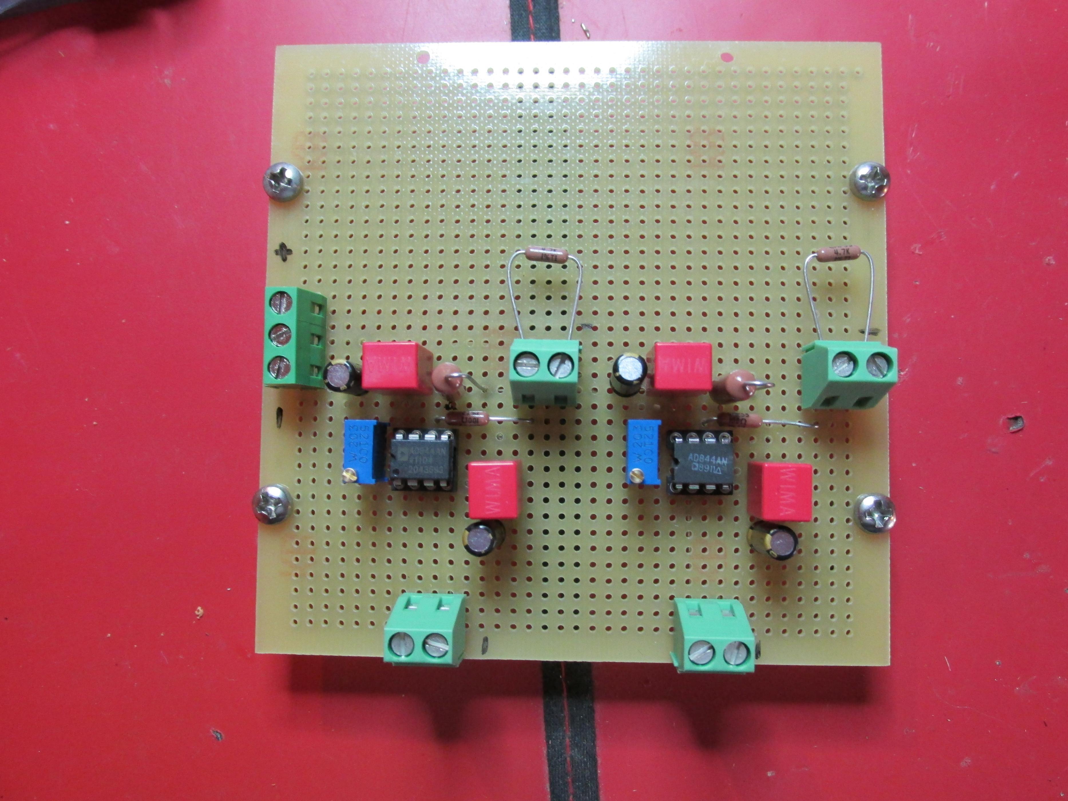

AD844 stage is up and running
Yes a test disc at 0dbf to make the dac give full output and work it's hardest, but you need 0dbf of silence to be able to view any noise without being swamped by the music. Then there's the glitches, they happen who knows when and need to be stored and frozen, and you need to see what the I/V stage is doing at that split second in time. (My head hurts). best off having no feedback and not tempting fate.
Cheers George

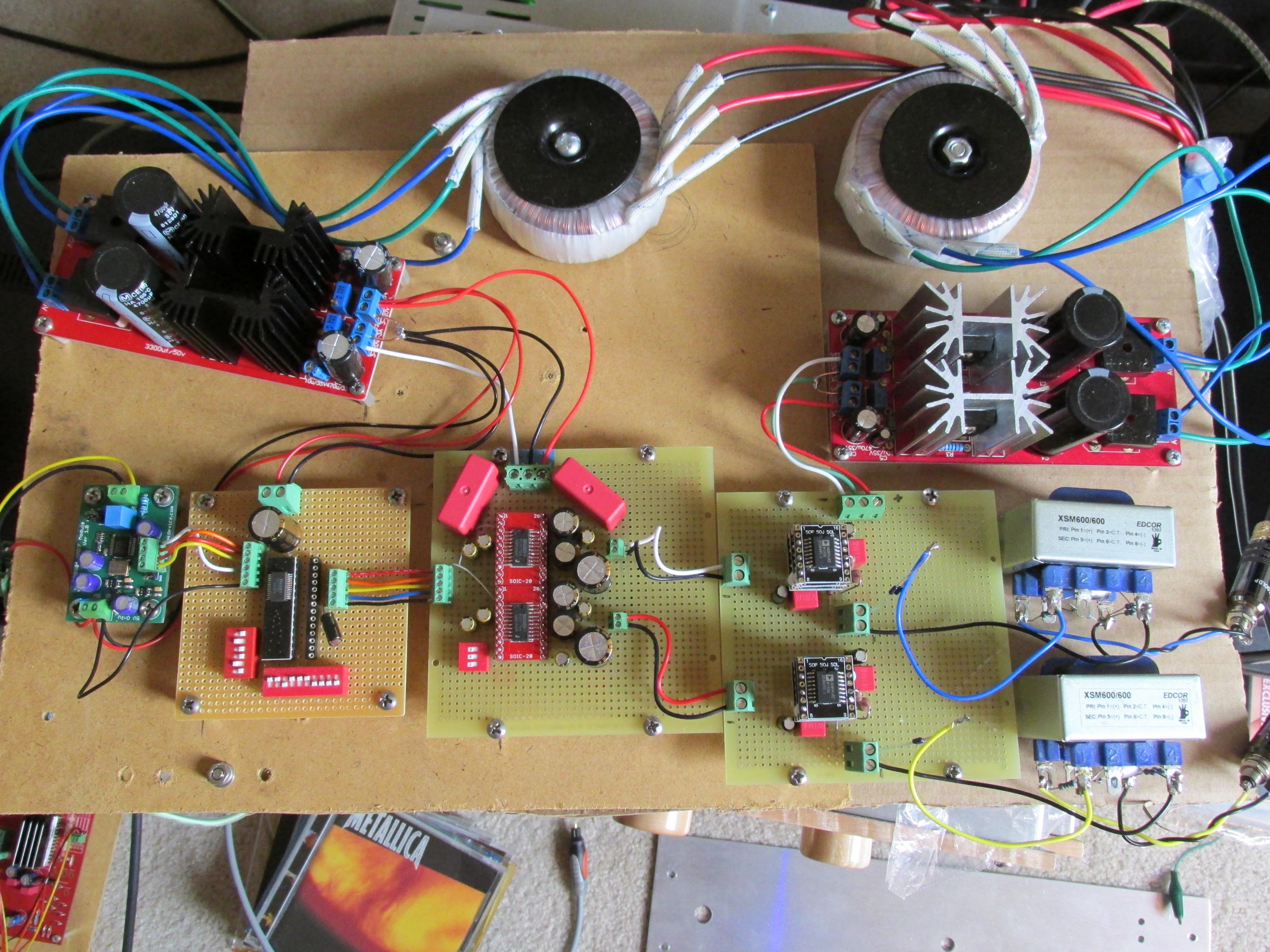

Hi George, Just finished the basic PCM1704 AD844 I/V stage. Just taking a first listen. For now single AD844's to test the board. One triple stack has the 100 Ohm resistors installed, the other when i get a chance. I also wired up the nulling pins to my adapters for just the bottom chip. I think you mentioned that is all that was needed? I am using a passive filter for now. I can say it sounds pretty smooth. I have enough room to add the AD825 buffer stage too. In a mad dash to get things done. Looking at open shoulder surgery in as few as 2 weeks. Ouch... :eek:

Looks good wait till you hear the triple.
Yes the 1 x 20kohm dc trimmer goes only on one as I did it, don't know what would happen if you have on all three, it worked fine for me on one of the Ad844 nulling pins, stable dc offset +- 1mV.
As for the passive filter, it's the cap across the TZ resistor, I used 2.7kohm for the gain I wanted with 470pf across it which gave -3db at 125khz.

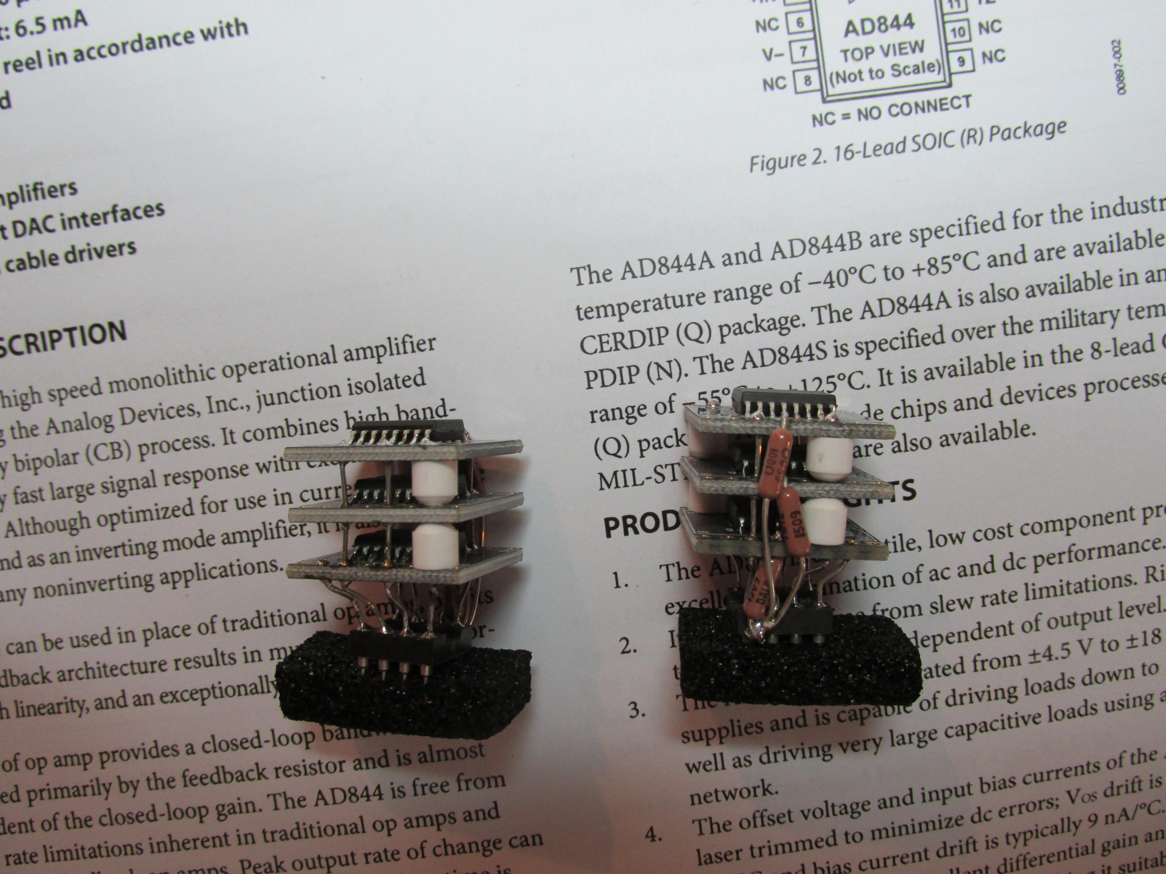

AD844 Triple stack
Cheers George
Hi George, Installed the triple stack just 2 hours ago. No problem getting much less then 1 mV offset. Sound is very clear. It seems with the PCM1704 this is very good. I'll need to do some more listening however I am impressed. :D

Have been following along with the developments over the course of this thread. Thus far I have made the IV conversion to stacked AD844s to replace the factory Denon dvd-5000 IV/buffer system. I was using the signal from the paralleled buffers to start with then only the output from pin 5 for some time. I also installed emitter follower supplies for each of the chip sets, one for the PCM's, AD844s and the nulling circuit. Each supply was loaded such that the plus and minus legs were loaded the same to match and reduce output impedance of the supplies. These were located over the chips. This seemed to improve the sonic balance and definition and the sound stage but I never got the wow factor that would of replaced my Meridian 596.
I went thru the process of installing the series resistor on the buffer outputs and connected them back to the Denon's outputs. Nice but still not what was being raved about throughout this thread.
I began to suspect my thru hole parts and layout(quite the mess) for the unanswered improvement. I then traced the signal path from the AD844 to the PCM1704s. The signal path to the AD844s was direct but the return was mind boggling on the factory board. I took the suggestion that it should be short and direct from abraxalito, I believe mentioned in this thread. Well, I installed a short jumper back from pin 3 of the AD844s to the analog ground of the PCM1704s. Holly DACMAN.........
Now I understand what the fuss is all about. Might want to make sure that the analog signal path between the chips is short and sweet. I am using the Meridian as a transport into the Denon as a dac at this point. This makes for a very nice improvement over using either the meridian or the Denon by themselves. I now understand the talk about dynamics. The snap of the snare drum or any percussion instrument is terrific. The biggest surprise for me was the amount of detail that came to the forefront. The accompanying instruments/singers are now a part of the picture not just in the background. The overall presentation is detailed and smooth.
