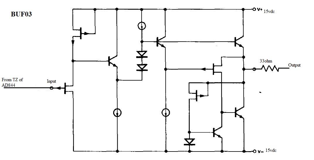

hello, what input impedance this buffer?
1Meg according to the first schematic in the first post. However that's a gate resistor and can be changed if you don't want 1Meg.

I could easily be mistaken here too but it looked to me that 'this buffer' referred to what was pointed to by the link following - the JLH-based buffer. Seems he wants to use that instead of your BUF03.
@donovas - yes you need to provide some kind of DC path for the JFETs, but the I/V resistor does that well enough. I'd keep the 1Meg for whenever you wish to disconnect the buffer as JFETs can be damaged by static.
no input resistor needed?
I fed my TZ direct (5mm) to input of BUF03 which has I think 50 billion ohms input impedance (5 x 10 to the 11th power) whatever it's high!!

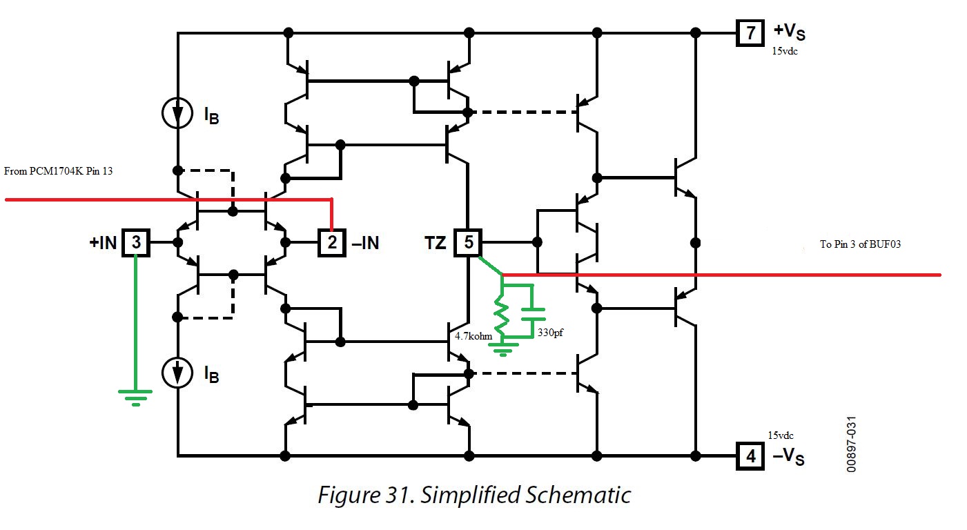

As for the TZ resistor, I get as much gain from it as I need to get 2v with a larger resistor and a smaller cap for the low pass, as maybe a larger could cause instability in the I/V stage.

I can help explain why you got the result on the cope you describe.
May I point out, hopefully without George getting nose out of joint, that the difference between 820R and added 250K is 817R, that the difference between 2K7 and added 250K is 2K67, and likewise 1K5 is 1K49. So it is clear that there will be hardly a measured difference.
And that is what you saw on the scope.
But if instead of adding 250K with 1K5 where the Tz resistor was also 1K5, you would be the voltage on the scope to be exactly half.
It comes down to pure Ohm's Law.
And it comes down to what the nature of TZ is and that it is NOT a normal output.
So it should NOT be looked at as a normal output. In theory the TZ pin should be infinite output impedance (the ideal buffer output is supposed to be zero Ohm). In reality these are only ideal, but one is high (TZ) and the other is low (buffer).
Lets say that you measure 1V RMS signal at Tz into 1K - that means that the output is actually 1mA (0.001A). Note that it is NOT voltage but current. Hence if you increase it to 2K you will see 2V on TZ, if you increase it to 3K you will see 3V on TZ and so on. The output is always 1mA and the voltage is that current times the value of the resistor, straight Ohm's Law stuff.
Of course this means that TZ is extremely load sensitive (in voltage terms only) and whatever voltage is developed at TZ (which is a function of current times voltage) ideally needs a buffer to prevent the output moving under load. But if the load is 250K, then the 1K or 2K or 3K is only reduced by about 1% or less, so you are getting away with it and if you like what it does in the context of your system, then that is fine (of course this is an OK DIY solution, but no manufacturer would ever do it that way).
It is not a schematic that explains TZ, it is the maths and pure Ohm's Law. And just as we can have a 'voltage' output, so we can also have an unconventional 'current' output. One is very easy to understand, the other needs a different mindset but its behaviour is still explained by Ohm's Law and Thevenin's Theorem which is also related to Ohm's Law, it works with both AC and DC.
Hope this is OK with George - I am only trying to explain what you are doing and why you have the results you are getting.
Interestingly, it is not possible to overload Tz as it will produce 1mA into a dead short. It is producing zero volt, but it is designed to deliver current and it will do that into any load. It cannot be overloaded like a conventional voltage output can.
My own solution would still be a buffer as I have clients who have expectations that things should behave normally - and Tz does not do that.
To cap: Voltage output is insensitive with load as it has a low output impedance. Current out is also insensitive with load, but with respect to current which will always be 1mA no matter what the load is. The are BOTH insensitive to load, but in DIFFERENT WAYS.
And that is confusing until you actually figure it out. You can easily confirm the above by varying TZ value by 2:1 and you will see the voltage there also being 2:1 and that means the current output on TZ has not changed.

Thanks for the info Joe. In my thinking, it would then act similarly like a CCS almost(with constant input signal). I have to believe that there must be an upper limit in the value of the resistor on TZ. The value of this resistor would then determine the gain of this circuit, there must be a limit, right? Also, the type of resistor affect the sound, if you believe resistors affect sound production. Not wanting to hijack the thread. Using a vintage RN65 mepco resistors results in the best 20/20k amplitude sweep I have seen from any player I have tested.
That is exactly how it acts, but with respect to AC (audio signal) rather than DC.
For sure, but I have used a filter circuit at Tz and that shows/indicates it is many MegaOhm because I was able to get gains of near 80dB with it (going a bit from memory here), using around 700-800K - only using very small input signals of course on input (+) and (-) grounded.
