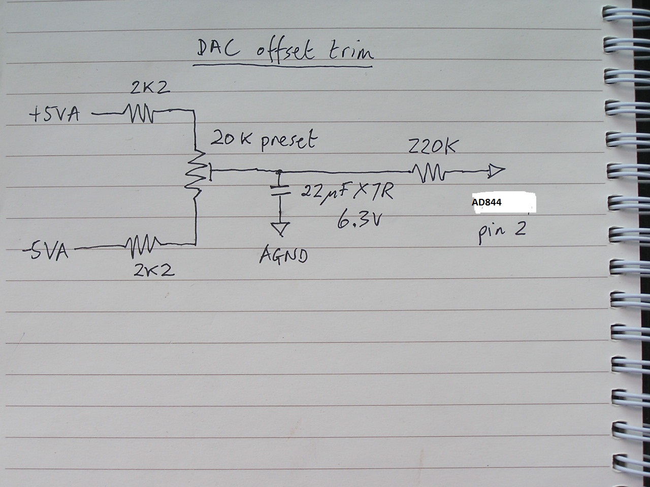

Got 2 from from here via Torchwood421 he's kindly going to post them to me at least I know they will be originals. Fingers crossed these will be even better than the Ad844's own buffer.
The LME49610/49600 have got the specs, but to get rid of the 60mV of DC without dc servo I have no knowledge how to do, maybe another offset nuller that abraxilito did for the PCM1704 for me would work here to? But it's getting complicated.

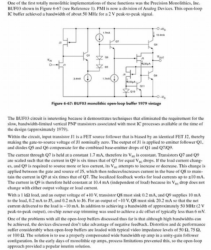

The reason why I would like to try the BUF03's, is that the internal buffer of the AD844 in open loop mode has got a question on it.
As good as it sounds, and it is very good, when I load it down with 100ohm it's output has droped by half, this indicates to me that in open loop mode it's output impedance is not as the specs say 15ohms, but it is really 100ohm output impedance.
This is not a great concern, but with the halving of the signal with the 100ohm load there is also quite a bit of xover distortion (probably the internal 80mA short circuit protection being applied) as well seen on the scope, not that in pratice it will ever see 100ohm load, this is the questionable part for me, and why I would like to give the BUF03 a go.

Can't wait to get these BUF03's to see if they can topple the already great sounding internal buffer of the AD844, I also puchased a nice ready made pcb on ebay to make it nice and neat.
Ebay Item Number 121130571333
Also here is Walt Jung's take on the BUF03, he only seems to have concerns with distortion in openloop implementation when the load goes down too low, which will never happen in my case.

Hi George, Please let us know how it turns out... I hope to get the 844's in the next week or so. Going SOIC 16. I think that could be easier to stack.
Yeah, in audio we rarely see lower than 10K, so that should not be a problem. No 50 Ohm video drive.
The only think that concerns is DC stability without the use of feedback, but it should be OK, just null the final output, but there will be a small offset on Pin 5 of AD844.
Cheers, Joe
Cheers, Joe
That's already been addressed in previous posts courtesy of abraxilito's dc offset nulling circuit for the PCM1704k, which holds steady at .1mV on pin 5 TZ of the AD844

Got the BUF-03 yesterday put it in instead of the AD844's own buffer, dc offsets steady at .1 to .2mV after warm up, when cold I get around 5mV, also a mute circuit is needed as it in conjunction with the AD844 gives a hefty 5v switch on and off thump for a second. I have very nice TO-99 cast aluminium heatsinks for them they run HOT, and no they are not oscillating, 15v rails.
The 844's buffer will not drive my Sennheiser HD650 (300ohm) without gross distortion where the BUF-03 does it no trouble, the BUF-03 has far lower output impedance and higher current than the 844's buffer.
