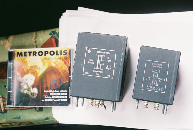

I've got these Telefunken Power transformers - They weigh a ton!<br>One is marked 177v 0,4 A (whats a comma mean?) and 7.2V 20uA?
The other just: 6.3V 3.7A

Please see the picuture. This is what I am trying myself to decipher.
It reads:
177V
0,4A
7,2V
20uA (with a strange little backwards 'u' character someone here might understang but i don't.)
on the bottom I also see: 1500 Veff 50Hz 120V 50-60hz
What on earth would 177V 0,4A be good for?
This is a titanic looking tranny. Weighs a ton. much bigger than the 6.3v 3,7A one I have.

In Europe, the role of a comma and a decimal point is reversed.
So you have a classy filament tranformer (6.3V @ 3.7A max) and B+ transformer (177V @ 400mA max) And even with the telefunken logo! With diode bridge rectification,you would be able to get ~240VDC with this, a little low but not too bad. With a voltage doubler type power supply and a tube rectifier, maybe 360V?
I don't know what the 7.2V @ 0.00002A would be any use for! :bigeyes: ("backwards u" = mu = micro = 1*10E-6 = 0.000001 or one millionth)

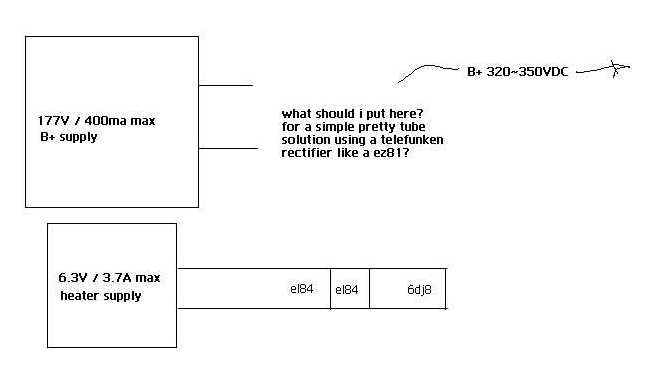

For the power supply, you will need to use a 6 volt heater tube rectifier with an indirect heater. On all the 5 volt rectifiers (5Y3, 5U4 etc), the B+ (high voltage DC) is taken directly from the filament, which is on their own 5V winding.
So use a 6-volt rectifier tube like EZ81 instead, and you can use your telefunekn filament transformer for all tubes in the amplifier. Or you could use a $2 diode bridge. :p
So here is where I'm at now.
I have all the parts to assemble a se84cs like amp with a bunch of old telefunken parts... but I need to make these ol transformers work. I want a simple solution with a pretty telefunken tube or something like that.
Shifty says to use the big one with an EZ81 and a voltage doubler for the B+ then use the other straight? for a heater supply?
what exactly do i need to buy to finish this? I don't know how to make a voltage doubler.
someone want to scribble me a diagram to complete this? pleeese. :)
A Parts list anyone? :)
Thanks a bunch. I can't wait to finally get this hooked up and see some kinda fire and squonk.
You all are great.

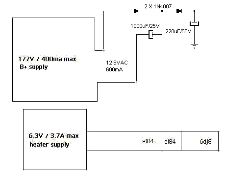

You need some higher voltage and have 177VAC at 400mA available so: a voltage doubler using diodes is the easy way out.
You get about twice the volts at roughly half the current:
Cheers, ;)
P.S. Ignore the component values, I borrowed from an existing diagram.
diyAudio Senior Member
Joined 2002
Quote from Glassware:
The Voltage Doubler power supply configuration allows the creation of a power supply whose output voltage far exceeds the peak transformer secondary voltage. Two diodes, two capacitor--that's all there is to it. Only one half of the voltage cycle is used in each leg of this circuit, that is, one diode conducts, then the other--each builds up a voltage in its associated capacitor, which are in turn stacked one above the other, thus, doubling the voltage.
So what you need is 2 * 1N4007s , a cap of say 470µF/250VDC that goes inbetween the tiepoint of the diodes and finally another cap of say 47µF/400VDC to build your basic supply.
It will yield a voltage much higher than you require for the EL84s and the input tubes but at least you can now smooth further by either RC filtering or better still choke filters.
Keep in mind that the total current available is only half of what the xformer could have delivered without the voltage doubler.
Cheers,;)

That will knock the voltage down a bit right?
The 5H will be fine, bigger is even better but since this is what you have...
The 60 Ohm DCR won't bring the voltage down enough, you'll only need about 250VDC and you're looking at about 400VDC coming from the doubler.
Actually if you'd had about 10VAC more from the xformer a bridge rectifier would have worked fine....
There are tricks to add another xformer to the secondary but I'm no big fan of those stunts.
I'm wondering now: where do I rectify to DC then?
Reread the quote I pasted in the previous post; it's done...finito, simple as that.
I still really want to use a tube rectifier if only for aesthetic reasons.
Stick a candle on top of it...??
Seriously, do whatever you fancy but you can't have your cake and eat it too...so it's either the diodes as doubler or a totally different project altogether.
