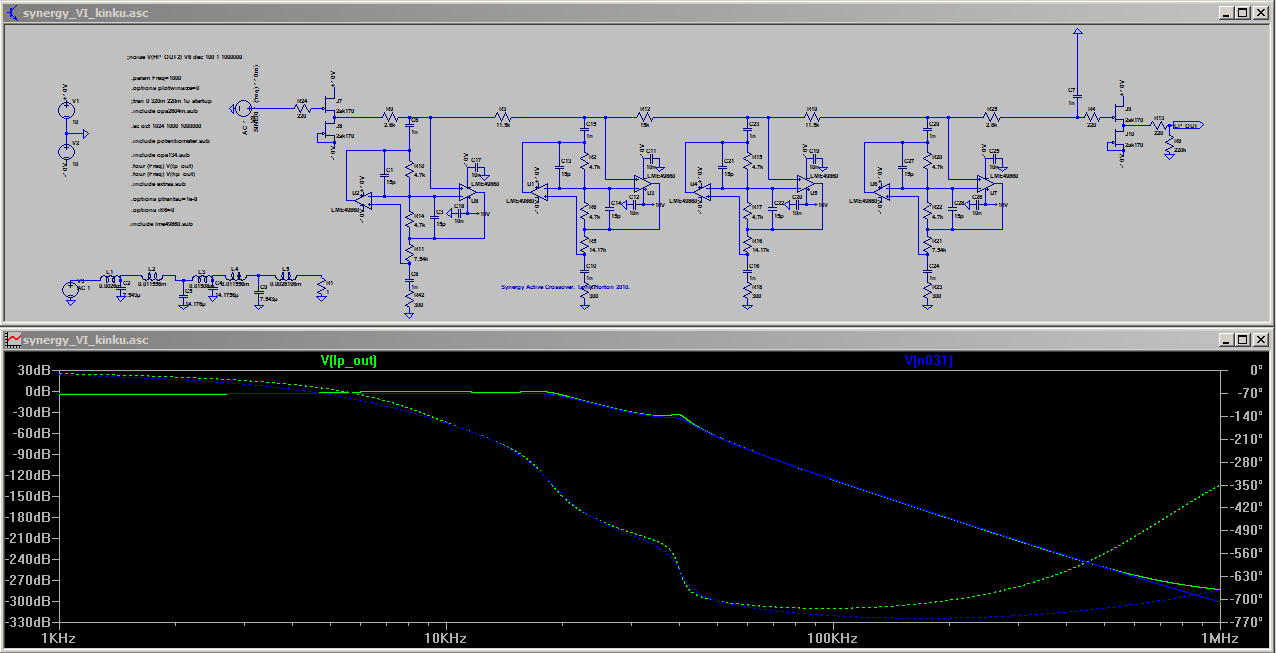

Hi I just found an online calculator which did up to 10th order butterworth. Nothing special :) I don't even know how well it works (and based on the sim below I suspect it is out by a reasonable margin). I simulated a 9th order passive and fdnr, and they gave quite similar results. Neither looked particularly inspiring! ;)
what is very interesting is how pathetic the passive filter is if you put in some realistic parasitics. The curve shown is with unrealisticly low DCR for the coils and ESR for the caps (with NO esl) Just enough resistance to tame the resonance (at the unfortunate frequency of around 40Khz).
I think you are best of looking at app notes for NOS dac chips and seeing what they recommend. I've not looked at this stuff before but it is becoming apparent very quickly why oversampling was introduced!
