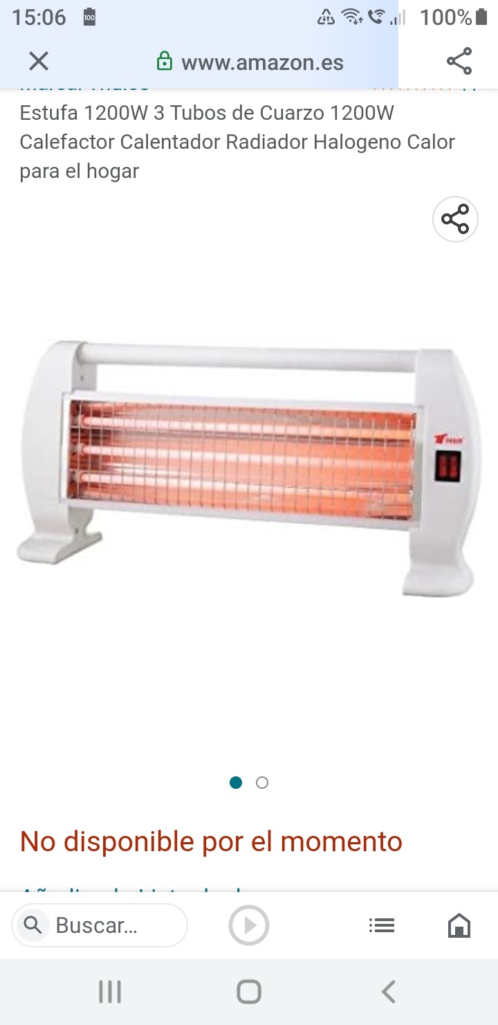

@jean-paul :
Yes, a dummy load composed of 12 quartz heaters 600W each (220V), like one of those inside this one
