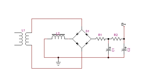

I got a nasty buzz after I switched to that choke in the ground leg setup. It occurred to me that I have no ides how to orient the first filter cap with that setup. I had it tied to the "power" lug on my 2 point star ground layout. Is there a better way to do it, and could that be my buzz issue?

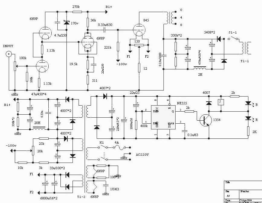

Example of chokes in ground side
Alethian,
Here is an example circuit (the Chinese "Music Angel" 845 SET). Both the main HT and the Driver HT use chokes in the ground side. Note where the earth connections and the caps go. If you put the ground connection in the wrong place you will certainly get a nasty buzz.
Hint save attachment to file and then open it full size using Windows Picture and Fax Viewer. Any missing lines will reappear.

This HV power supply is the same as the one that I use on the 845SE except I use tube rectifiers.
The Buzz can be caused by grounding issues, or the buzz can be caused by the voltage transients that occur in the choke.
Remember from electronics 101 that an inductor tends to keep the flow of current constant. It does that by releasing its stored magnetic energy as current. When there is no place for that current to flow the voltage will rise abruptly often to kilovolt levels. In a pure choke input filter, there is a period of time where the diodes are reverse biased, so there is no path for current flow. The inductor voltage rises to the point that the diodes break down. This fast discharge of energy will cause a raspy buz in the amp. It will also cause blown diodes.
OK, now how do I fix it? Try a small cap across the bridge rectifier, like a cap input filter. 1 uF . Try a resistor across the choke something like 5K 5W. I have heard mention of snubber networks across the choke, but I haven't tried them. The problem is less obvious with tube rectifiers.
Your circuit is correct.

depends upon Cjo of the diode and L(leakage) of the transformer.aletheian said:Sweet.
Would you recommend bypassing all the bridge diodes with capc or resistors, or just one from AC to AC, or B+ to ground (well, to choke more like)?
