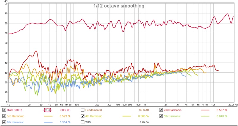

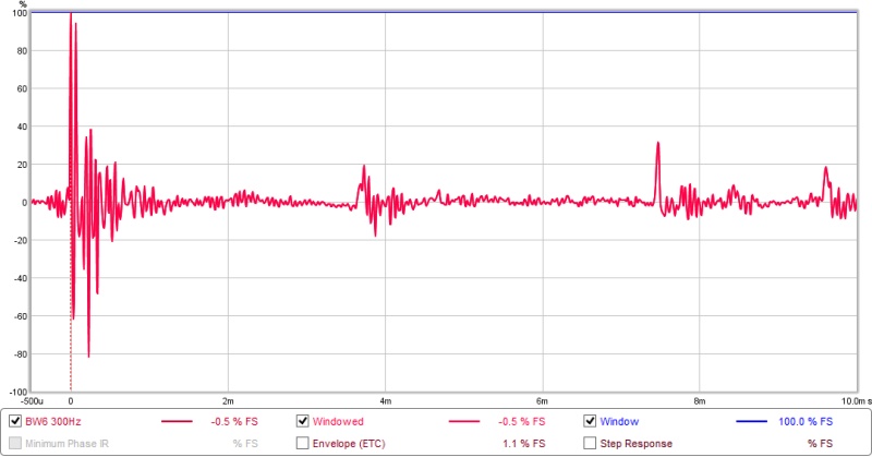

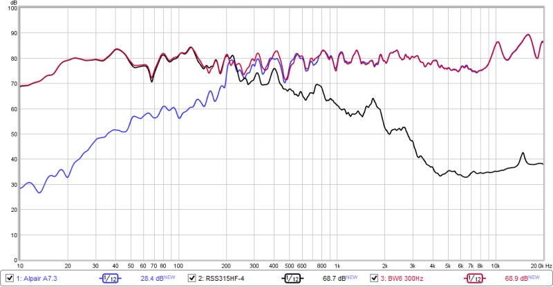

OK. I'll play. The room is 25'x13'x8'. One long wall, with the speakers centered, and the floor are cast concrete. The left short wall, the back wall and the ceiling are drywall. The right short wall is glass with a heavy cotton curtain over the windows. The left rear corner is open into a 6'x10' landing for a stair will. The floor is covered with carpeting and there is a fair amount of soft furniture scattered about. The speakers are 3' from the wall, 7.5' apart and the chair 7.5' from the speakers. The bass speakers are Dayton RSS315HF-4's in 2ft^3 sealed boxes that are 24" tall. the treble speakers are Alpair 7.3's in folded TL's sitting on top of the bass speakers. The microphone is centered on my head and 2" above my head.
Have fun.
Bob

It's not an issue of trust or whether or not I believe someone's sim. I design and model speakers too (check out all my builds in the FC thread and other threads), and I also make measurements and even provide sound clips if anyone is interested. Measurements don't always agree with sims, and some speakers cannot be sim'd properly unless you go with a 3d finite element approach. Again, it's not just the room effects (below 200Hz), we are interested in intrinsic speaker response above that which is independent of the room.

Thanks for playing along. You have nice measurements frequency wise and HD wise. But the one thing you have is a lot of acoustic 'after taste' due to the impulse response ringing - corresponding to the two cone breakup peaks above 10kHz that the A7.3 is known for. I think percussive sounds will have a shimmer and voices will have a sibillant quality. As I recall, this driver behaves better 15 deg off axis where these peaks go down. However, this acoustic aftertaste may actually be pleasing sounding to some - I believe this acoustic aftertaste makes soft impulses more audible. What this means is that it gives an apparent enhanced audibility of soft sharp sounds that otherwise is not there in the original recording. Some folks may call this "enhanced detail", or it might be the same as DDR to some? This seems to be more common in aluminum diaphragms.

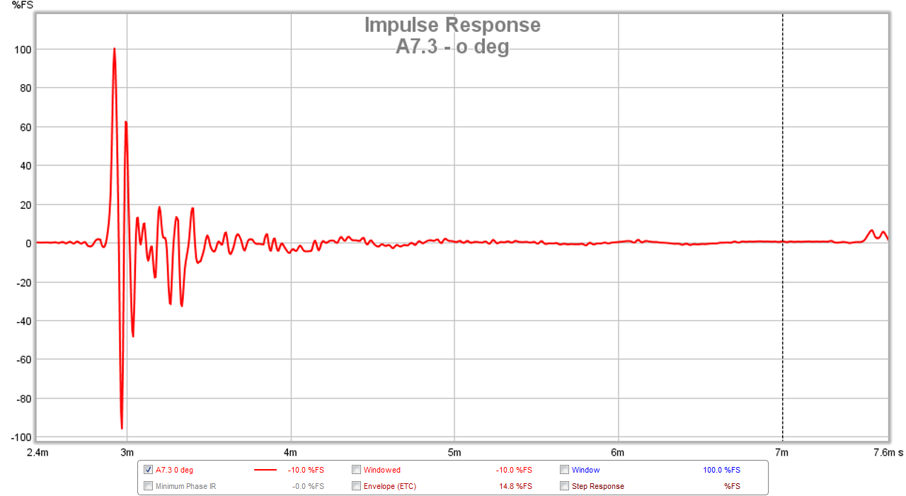

If we look at the comparison between the A7.3 and the TC9FD's impulse response as previously seen here:
http://www.diyaudio.com/forums/full-range/267966-why-bother-frs-5.html#post4184730
Here is the A7.3 IR from pnix's measurements, it looks very similar to your IR:
Here is the IR from your measurement:

Now listen to what an impulse response sounds like from each driver, which one persists longer and is more audible?
