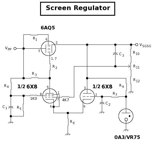

6X8's are very useful as voltage regulator error amps. (Attached). This way, the VR just draws its own current. You can include an RC noise filter since you're not connecting a capacitor across the VR tube (makes an oscillator).
The pentode is also a high gain device, and that's always good for any voltage regulator. Most people don't like 'em and so they aren't pricey.
Thanks Miles for the info...do you have the values to play with?...i have a more than a dozen NOS of this tube and any other use will be better.

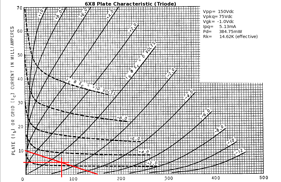

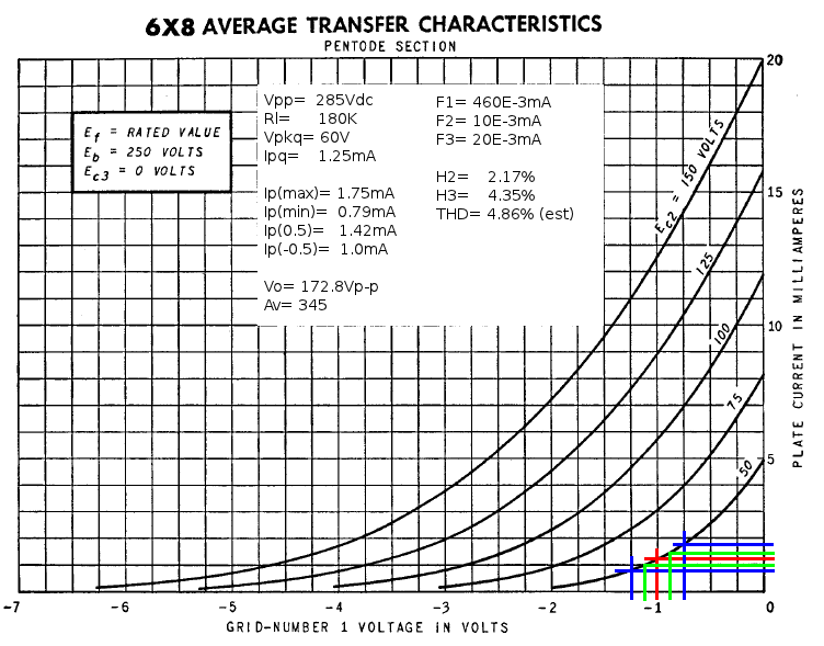

Design example attached. If you have 'em, might as well use 'em. The pentode half of the 6X8 is quite a linear small signal pentode. You can always use 'em for low level amplification as an unbalanced differential with the triode half being the input. It might save you a few pF in device capacitance.
You could also use 'em to implement a kind of paraphase splitter.
Another possibility is trioding the pentode half to get a dual triode. Pentoded, the pent half is very similar to the triode half.
