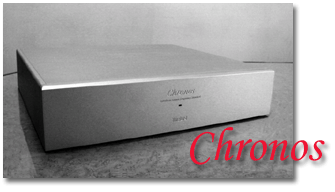

We've been using and selling a 10MHz Rubidium oscillator (called Chronos) for the past 2 years (now discontinued, all 75 pieces sold).
It was designed as a master reference timing source for digital audio.
It can be interfaced to a dCS 992 master clock.
The dCS 992 has a reference input which can accept this 10MHz sinewave as it has a 'software' DDS.
The DDS controls 'computer temperature calibrated' VCXOs. The PLL has user selectable time constants.
Output frequencies are 44.1 or 48kHz and multiples.
The result is very low jitter and a huge sound improvement.
The only slight drawback is the output stability is governed by the VCXOs, but we typically get +/- 0.002ppm.
We can also recalibrate the VCXOs (whilst in the unit) automatically by using the 10MHz source as a reference, you will need an oven and a day or two!
For Chronos go to: http://www.timelord.co.jp/consumer-audio/audiophile.html
under Product Search click Chronos (sorry, only in Japanese).
For dCS 992 go to: http://www.dcsltd.co.uk/clock.htm

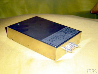

Wow, that canned Rb XO draws 1A @ 5V when warmed up...
We have a Rb standard at work. Like others have said, there's a lamp and PLL in there to generate the 10 MHz from the atomic transition.
