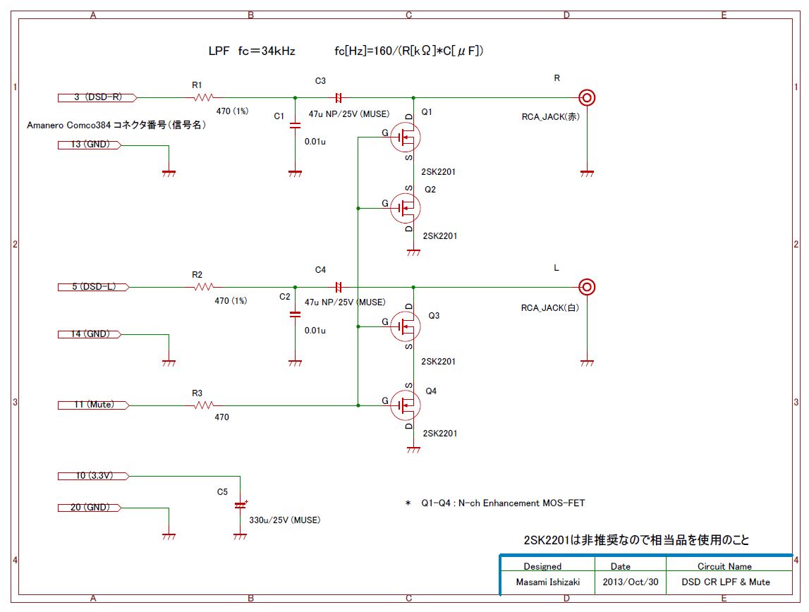

hello,
I wanted to do a give DSD, I did everything to give work .It only problem was that when changing tracks give crackles (shot), I used a 2sk2201 as in the diagram but it does not work.
do you have any idea?
and as it does lampizator in your dsd dac?
LampizatOr DSD DAC
p.s sorry for my english

Hi tonnytonny,
Very simple and interesting.
In google translate it says:"Pretty big pop noise will be appeared at the beginning of the first song, ... " but not sure whether there is pop/crackle after first track. Do you have after first track?
Also http://www.diyaudio.com/forums/twisted-pear/260950-dsd-initialization.html here page 2 it is stated that its a general player issue. Have a look at that thread. Don't remember what was the user using as player (foobar etc.) and source (PC etc.)... Also what you are using as source and player.
Also how is the sound, how would you describe or compare to something else?

hello,
LampizatOr DSD DAC
Amanero Combo384+CR LPF DSD256 unnecessary DSD DAC
I have the same problem and try work with cpld to controll dac chip. pin 'Mute' on Amanero not work correct for that diagram...
