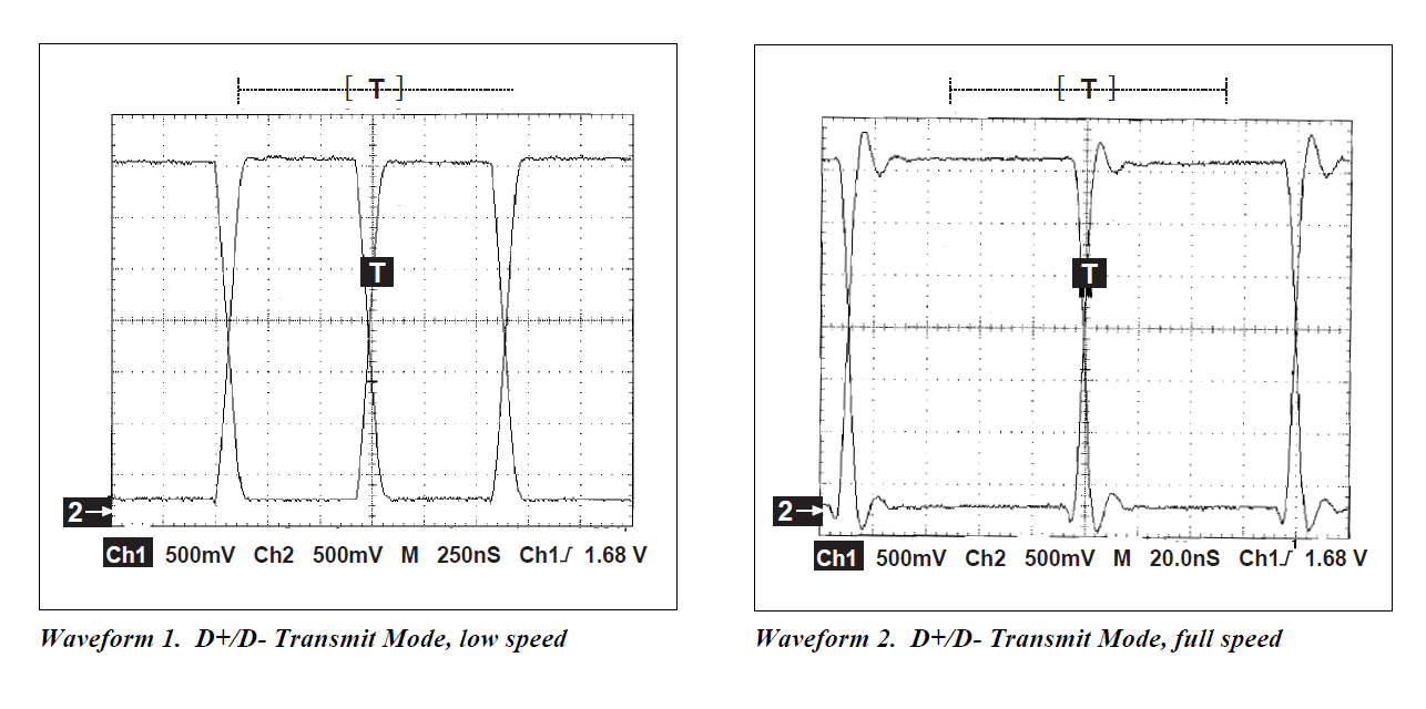

Digital zero and one, two states no inbetweens, I would suggest the book "High Speed Digital Design" by Howard Johnson.
USB transmits digital data, digital data consist of two states hi and low, it is transmitted as differential digital square waves as the attached picture shows, and you employ digital transmission design techniques...
If cables sound different then somthing is wrong with the digital data transmission and the only way you will understand what is going on is to use a scope or network analyser.
99% are flawed how, there are billions of USB interfaces in the world, how come all the Audio ones are flawed!
As to $150 for a USB cable all I can say is "An Audiophile and his money isare soon parted"

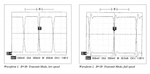

One would hope with USB there is a transiever at each end (or reciever and transmitter at opposite ends)
Simple question: do USB DACs buffer and reclock the data or do they rely on incoming data timing (but smoothed by a PLL) like most SPDIF DACs? If the latter then cable quality might make a tiny difference - probably too small to notice and not necessarily better with 'audiophile' cables. If the former then cables can make no difference.
For short cable runs correct termination is far more important than cable quality. To the extent that cable quality does matter, it is engineering issues such as characteristic impedance consistency which count rather than esoteric materials.
