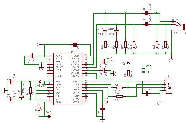

Hello everyone,
I have connected a PCM2705 on a breadboard.
I've connected the IC as shown on TI's data sheet on figure 32 but without the power amp. Instead i used the filters shown on the next example (figure 32).
When i plug my circuit to my PC I get the message:
One of the devices connected to the PC has malfunctioned and windows cannot recognise it.
Any ideas what went wrong? i have checked my circuit and it seems to be correct.
Maybe has been damaged through ESD? How sensitive this IC is to ESD. I touched it without a strap and used a plastic bag to carry it.
Shall i throw it and buy a new one??
Thank you

If you want to use an external DAC you can use the PCM2707 or PCM2706 for USB with S/PDIF or I2S output to a separate DAC from any vendor you like.
Your issue is probably caused by miswiring something, most likely one of the USB pull-up or pull-down resistors. If you're sure the wiring (and soldering) is correct, chances are that the chip is fried somehow.

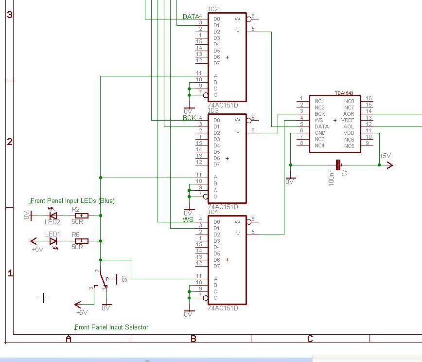

I'm useing the attached setup in order to switch between two I2S.
If you rememer, i'm completely new to electronic design so i would really apreciate your comments.
Is the 74HC151 acceptable for audio application?
Is this setup correct?
Shall i change this setup with 3 relays?

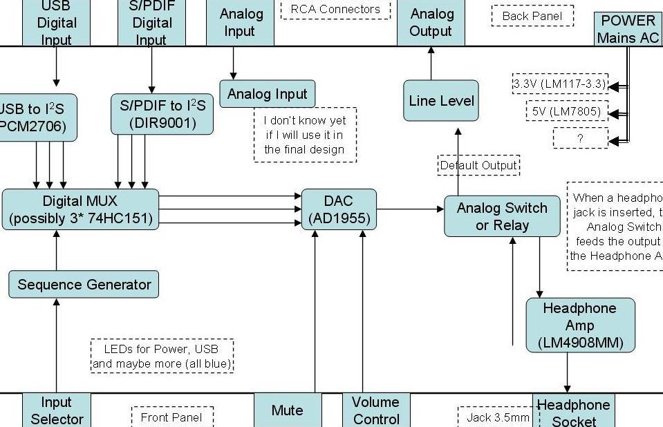

I'm a big believer in the AD1955. It's a dynamite DAC. The I/V from the Analog Devices eval board uses AD797 opamps. It's the best I/V I've heard for this chip. Very detailed yet not overly clinical and it's not bright sounding. The only downside of the 2706/7 is the limitation of 16/44 source content. You're right that the chip is easy to implement.
I've started working on an ethernet connection to the AD1955 using a Blackfin DSP running Linux. So fat I have Linux up and running on the DSP and have successfully communicated to both Mac's and PC's via ethernet. There is also a small web server running on this DSP which is great for user configuration of options. The Blackfin provides I2S output and controls the DAC in software mode. I'll post more information as the design becomes more practical.

Hello, I had about three failed tries to make a PCM2706 work.
I'm using the Figure 33 on the page 29 of the datasheet (bus powered, internal dac). A copy is attached.
I would like to ask, what am i supposed to do with the pins 4, 5, 6, 7, 8, 11, 18 and 19. They are all Function and HID pins.
If i don't want to use those functions, can i just leave them open?
If I want to use those functions where am i suppose to connect this labeled suspend arrow showing in figure 33?

I would like to ask, what am i supposed to do with the pins 4, 5, 6, 7, 8, 11, 18 and 19. They are all Function and HID pins. If i don't want to use those functions, can i just leave them open?
Thats a bad idea when working with logic level devices. Either connect them to Vdd or ground. Page 7 of the datasheet explains the function (active high or low).
