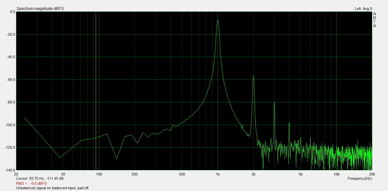

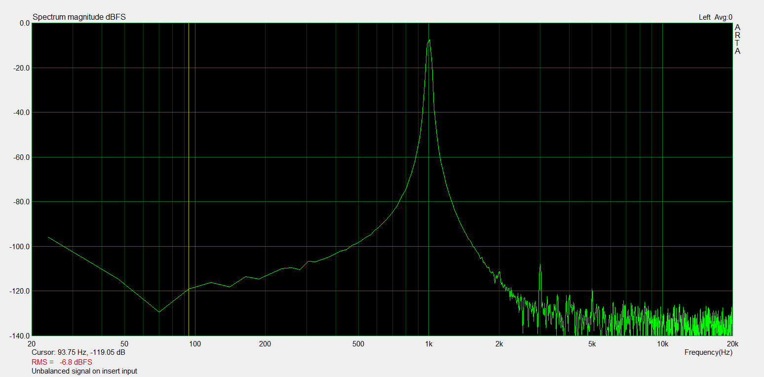

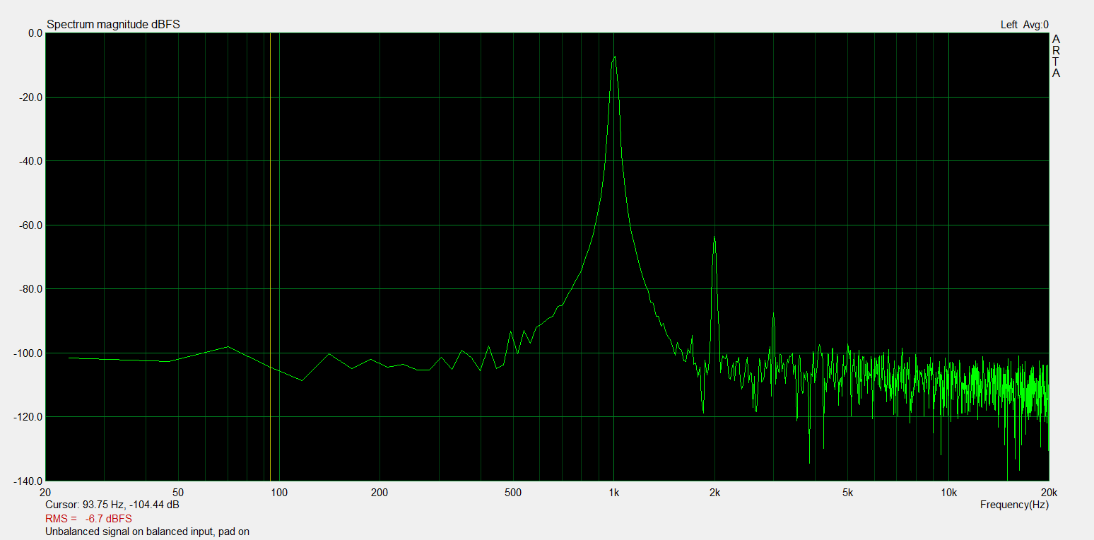

Finally got a chance to try this and yes, the insert input can be used for unbalanced signals instead of the balanced inputs on the front. :)
Some comparisons. Here is a -6dB signal looped back from the unbalanced line output to the balanced line level input:
643776d1509743215-usb-audio-interface-measurement-balanced-input-pad-png
You can see high levels of 2nd harmonic distortion as well as some 3rd and 4th. Here is the pad enabled and gain turned up on the unbalanced input:
643777d1509743215-usb-audio-interface-measurement-balanced-input-pad-png
Reduced distortion especially 3rd but a 20dB increase in noise floor due to turning up the gain.
And finally here is the same -6dB unbalanced signal fed into the unbalanced insert loop at the rear which also bypasses all the preamps:
643779d1509743348-usb-audio-interface-measurement-unbalanced-insert-input-png
Very low noise floor and almost no second harmonic distortion. Also the insert input is able to take the full 0dB output of the line outputs (not shown in these measurements) without additional distortion while the balanced inputs cannot.
I should point out that there are no problems with distortion when the balanced inputs are provided with a balanced signal such as a transformer coupled signal, only when connected to an unbalanced and/or high level signal.

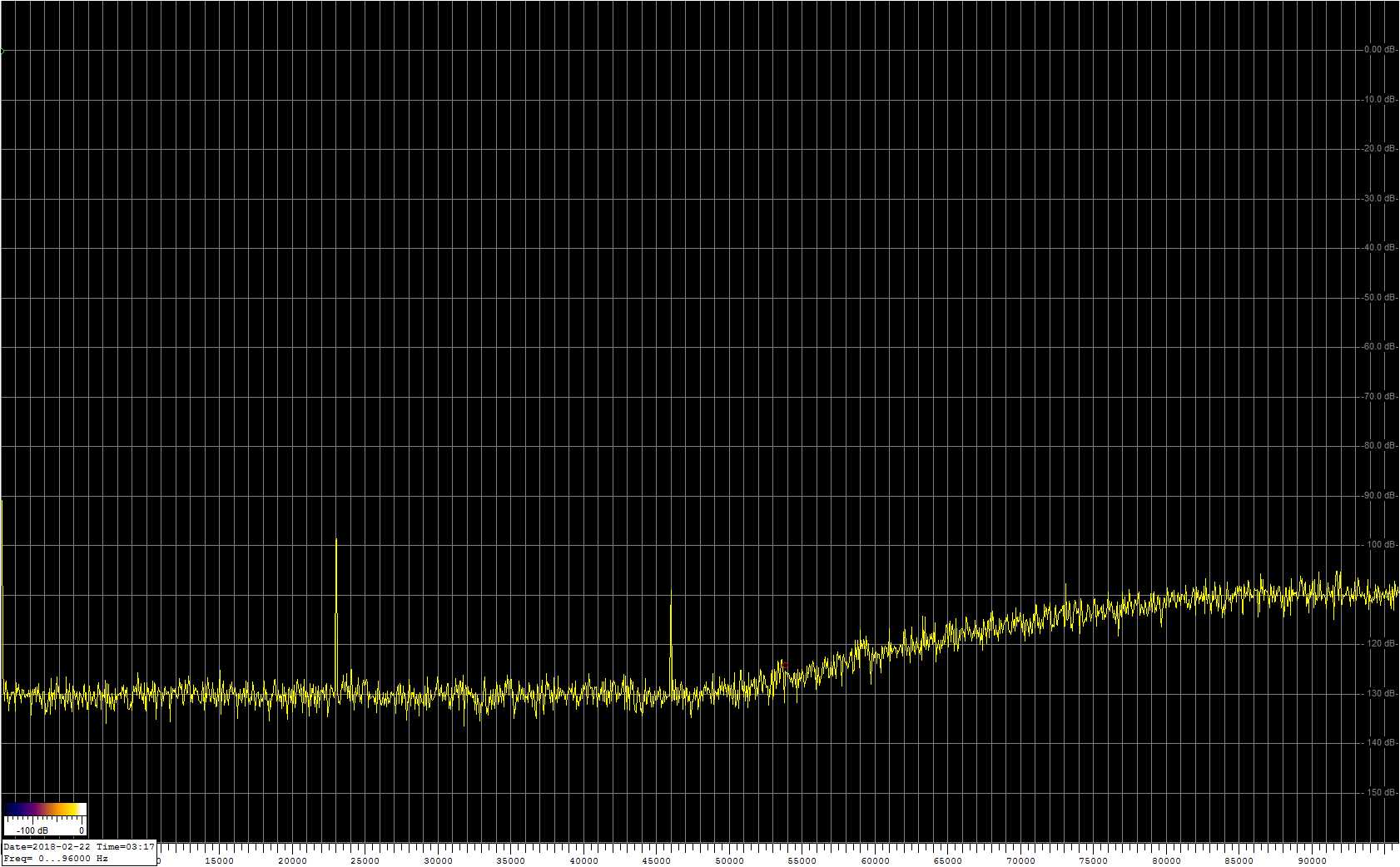

Hi Simon,
Regardless of the configuration (sampling frequency, resolution, + 48V power supply, computer / laptop battery ...) my UMC202HD has a quite strong peak around 23kHz. This is my second unit, because in the first UMC202HD this tone was much lower (10 kHz) and I could literally hear it. So I sent it back to the seller. Is your UMC204 silent?
Witold
Hi Simon,
Witold
Keep in mind I have the UMC204HD so I can't speak for the UMC202HD.
However, it is probably noise from your laptop - try a different USB port on your laptop or a different laptop.
What I found with mine is that one of the USB ports in my laptop has a problem - I'm not sure exactly what is wrong with the USB port but I suspect it is a dodgy earth connection.
When I run the interface from this port if I wiggle or hold the USB plug in a certain position I see discrete noise spikes appear on the spectrum analyzer view in ARTA which must be coming from the laptop itself.
If I plug into the USB port on the other side of the computer I see no noise spikes at all, just a flat, clean noise floor and certainly not what you are seeing.
So I would be suspicious of the USB port or induced noise from the laptop. Try another laptop if possible or at least a different USB port.
Another possibility is the laptop charger - do you still see the noise spike with the laptop running from battery ? I do see a little bit of noise from the laptop power supply on mine as well - but goes away if I run the laptop from battery.
Some laptop power supplies are extremely noisy, so I do all my measurements while the laptop is running on battery.
The problem is in the 48V step-up converter. In my device this converter works with 126...127kHz (126,8kHz) and creates peak around 24kHz (23,7kHz). When I raised frequency to 143.5kHz spurious peak moved to 7kHz. 143.5-126.8=16.7 and 23.7 - 7 = 16.7, so there are no doubts.
The switch on the back panel doesn't turn off this circuit, it only disconnects 48V from front connectors.
Witold
