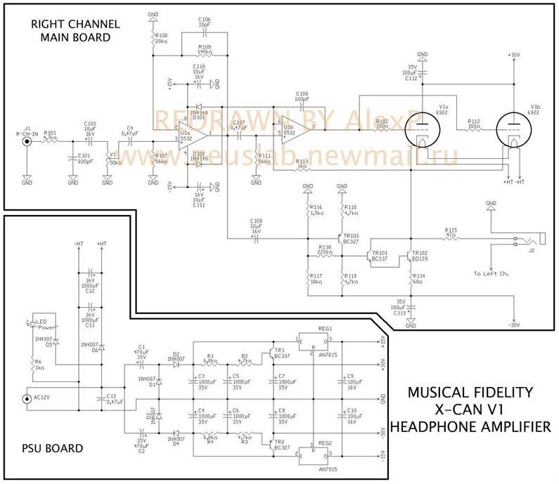

Here is my question...it uses two OPAs, one NE5532 per side. Would replacing these with OPA2134 improve the sound?

I guess there is not much interest in an old headphone amp...I do have it on the bench right now, I put sockets in it and OPA2134s, and NOS 6H6P, the sound is great, smooth, and with authority. Now I need to find new box for it, as it does not fit in original box, and I do not like the original box anyway, it was cramped inside.
I am thinking I can add 4 input switch on the front, and besides headphone jack one more output and use it as preamp, if needed.
Is there anything else I can modify? While its on the bench?

That's an eccentric circuit to say the least. I'm not sure whether I fully understand it tbh. Some sort of dynamic class A job? In any case I would assume it to have low enough distortion unless running out of current, since the output cathode followers are in the feedback loop.
Are you happy with the amount of gain it provides? Currently it's at 8x or 18 dB, which is mid-highish for a headphone amp.
In any case the gain-setting resistors look a tad too large for lowest noise and distortion. R108 and R109 could be reduced to 1/10 their value while simultaneously increasing the value of C106 by a factor of 10. If you don't have 2k and 14k at hand, 2k2 and 15k should do fine (1/4W metal film jobs). With the stock values, you never ever get equal impedances at +in and -in, not to mention that resistor noise dominates output noise.
As far as further tweaks are concerned, I'm not sure what sort of R115 value the circuit needs to remain stable under capacitive load. 47 ohms generally is low enough for less finicky cans but may be too much for pickier ones (or too little for others that are a bit thin on the bottom). If you've got a scope, try loading the output with 10 nF or so and watch out for oscillation with various resistor values. What would you want to be driving with it?

I was hoping someone will explain that output circuit to me, I am no expert. Seems like some sliding bias of sort. Currently the headphone amp is plugged directly to azur 640 cd player and sennheiser hd600 headphones. Sound is great, well balanced, smooth yet detailed. Volume pot is at 1/3rd, seems plenty of gain, but I am going to put it in the big box and make it a preamp/headphone amp, so higher gain may come in handy.
At this point I was only thinking if I can replace some caps for better quality while it is accessible. Thanks for the comment.
18 dB is plenty for a preamp, actually. With a power amp of 26-30 dB, you're looking at 44-48 dB total gain, which is a common range for integrated amps (~100wpc units tend to be around 46 dB). Some attention to noise is highly recommended in this application if the speakers are to remain dead quiet. Even when modified as suggested, noise level would still be only average. You're well advised to calculate how much power amp gain you really need.
You could use film (~1µ) or bipolar for C103, and bipolar for C109. The rest ought to be fine assuming they weren't junkbox quality parts to begin with. (And if they were, I'd swap the 16V ones.)

@ sgrossklas, yes, 18dB gain might be too much if you use it with normal amp after, but I have few amps with no gain, or very little gain sitting on the shelf... I got Nelson's Sun of zen, I got Andrea's Power follower, and some other class A buffers, which should work nicely with higher gain preamp

I am tempted to change the small alps pot for big stepped attenuator, I just do not have one at hand, but I should be able to get some stuff from ebay
as I mentioned before, it sounds great now with opa's and tube's upgrade
Anyway, I have upgraded it, see below some pictures for my modification.
One the up board: Added LM317/337 for main output rail regulation to stabilize the power rail ~ +/-25V, LM340.LM320 to make +/-15V instead of original 7815/7915. Replaced double voltage caps to 50V from 35V. Output caps to Fine Gold type, +/-15V output caps to UKZ type. Added 0.1uF CBB caps in parallel with all big Al caps.
