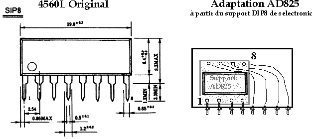

Hi there I have a TEAC DT1 serving DAC duties and was wondering if I would get any worthwhile benafits from chaging the opamps in the IV stage.
Currently the devices uses NJM2114L in the output, these are dual ops in a SIL package, very annoying that they dont use DIL but what u gonna do about it. Anyway would it be worthwhile replacing these with OPA2134's.
On paper the 2134's are better with lower distortion etc and everything after the DAC is a 2134 or better in an active xover so I would imagine there would be gains to be had.
Just wondering what you lot think.

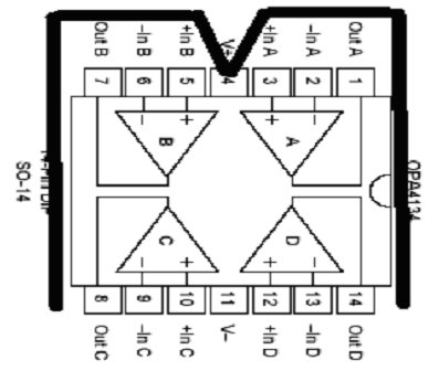

I would give it a try.
I used a quad op-amp for the conversion once, just straighten the legs on one side, worked great,
-or just solder extension-wires to a 8-DIL.
Picture : Quad...
Arne K

I've played around with a few, on a friend's old Cambridge CD2 that I've been slowly improving, some months ago..
It's been a while, but I think I used an AD825 with rather audible improvement over the 5534's that were in there. Actually an AD826 is much better, but dual, so it wasn't a easy drop in test. I have had audible improvement in a phono preamp over the OPA2134 with this chip. Maybe in doing that DIP to SIP conversion you could try this one.
I turned up a very nice chip, the AD797, that is used for I/V on the data sheet example circuit of AD's top DAC chip.. it is a single, but unforturnately it's very high freq response caused it to oscillate in the Cambridge.. (not a good layout on their boards) Didn't have time to play with it more and tame that oscillation and give it a good review...
Both of those are very high gain/hi frequency chips, so layout and just enough of capacitance in the feedback is critical. But if you can tame them, they should be excellent..
