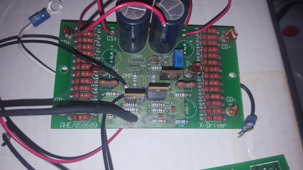

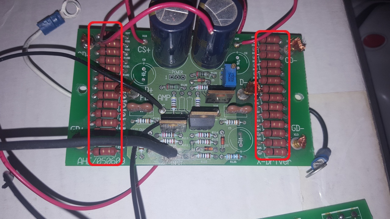

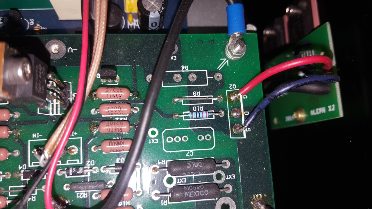

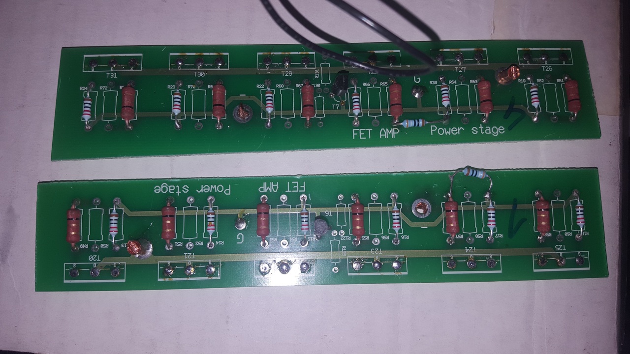

I had recently a upgrade done on my Monoblock Aleph-x because one of the amplifiers did not worked anymore. I asked an engineer-friend to do some research and he advised me that I could better go for another Aleph-X board. I did so. During this upgrade I have asked him if is possible to make upgrade from IRF9610 to JFet`s. So we did that. On another hand he said that my MOS-FET ( see picture) boards ware like crap soldered and he will make some of his own.
After that upgrade the Amplifier sound was very different from that I was familiar. Very transparent , fast and with no color , warm sound what was my best things in this Amplifer. So I thought maybe I have to burn the in. After 1 month the sound remain that bad. Just nothing special. We removed the JFETS and putted IRF9610 back in. No change in sound character.

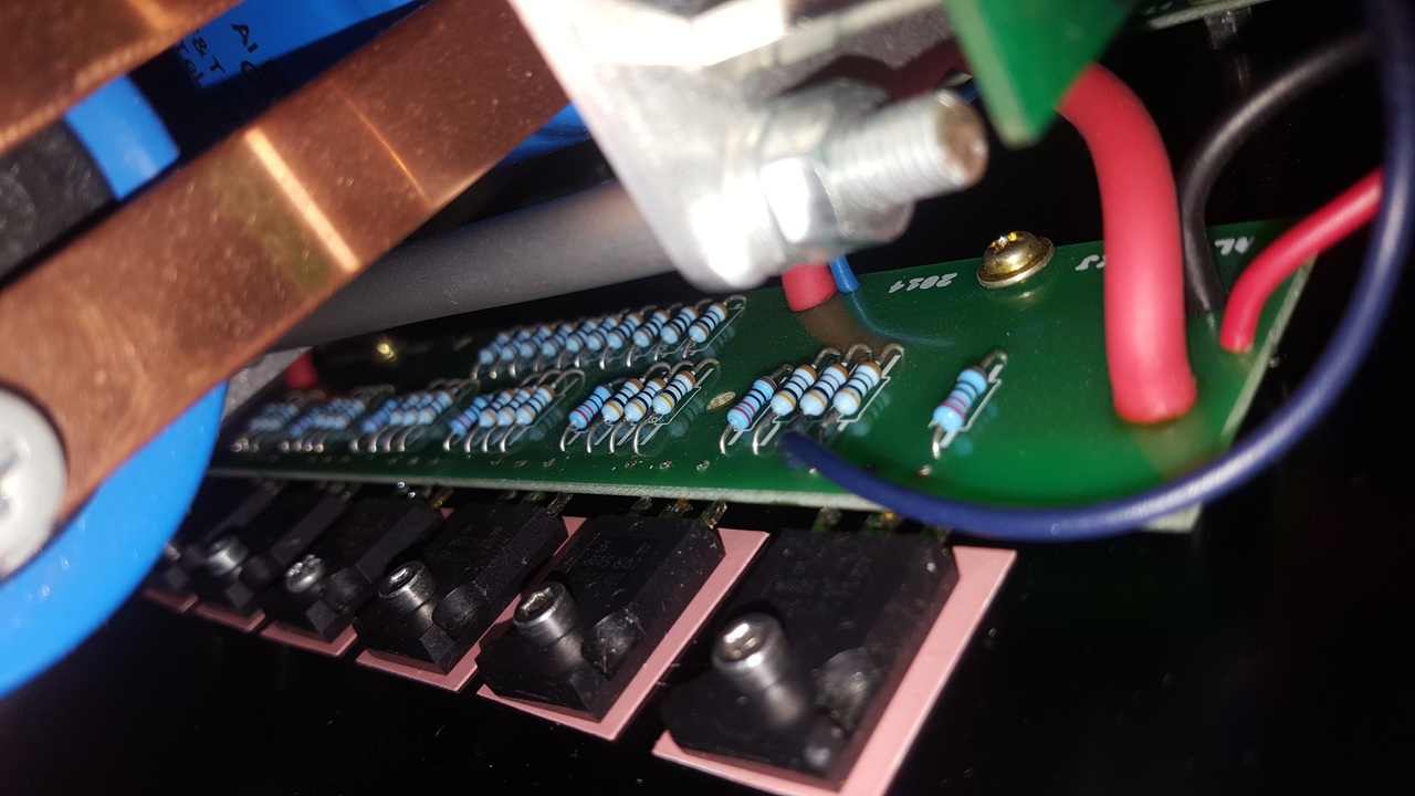

I told him this , and he answered that I wanted to have some more speed on the sound so he have assembled it with other resistors war ware according to him better ones. I had this brown ones and now they are smaller blue ones.
The question is if is that important the resistors on the MOS-FET boards , and could have that influence on my sound reproduction? And if I go and change them wil I get my Pass back to the musical and warm machine?

I`m just asking about the influence of the resistors on MOS-Fets PCB. Are those essential for the sound reproduction , because my friend says that it is not that important any that the new Head PCB is the main reason to this reproduction of this sound.

NP is using MOX as source resistors , while you're using paralleled MF ones
dunno which type were your old ones , but there can't be any dramatic difference , sound wise , between any of them
problem certainly lies in difference between your old main pcb and new one ....... and I can bet that's difference in schematic/some part value(s)
Brand is probably an irrelevant element here. If you are interested in replacing or replicating these resistors (mosfet source resistors?) in a new build, just choose any non-super-cheap resistor that can handle some power. They are used to bias the mosfet, no audio signal passes through them. In my AX build (~100w monoblocks, each with 12 mosfets), each mosfet has three 1-Ohm 1-watt 1% Dale resistors in parallel, thus forming a 0.33ohm 3w resistor. They don't get very warm at all.
Thanks Eric. ZenMod had told me that those 600mW x 3 = is little too low for it. Normally this should be 3W. So I have to change those.
At my Gate the resistors are also different from the original. Unfortunately I don't have 1 of the old mos-fet pcb. So I have to change those with different ones. Many people have on those places the Panasonic ERX or ERG. Are those the best choice for my audio preferences?
I have now ordered 100 Vishay BC 2-Ohm 2W resistors for the mosfet and also 60 Vishay BC 1-Ohm 3W for the output
