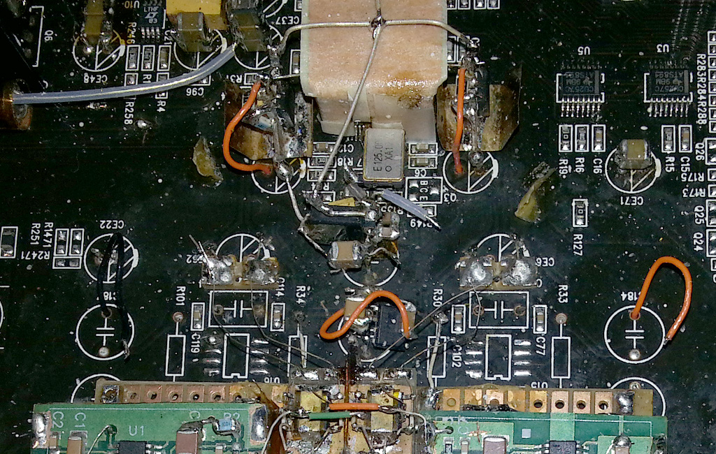

What savage beast attacked that device ?
The drawbacks of a public forum. I can post what I want as long as it is not against forum rules and you can post pics of mistreated equipment as much as we both want.

Coris your contribution here has been large. Please ignore the 'mistreated equipment' comment by jean-paul. Its a test-bed I'd suggest, and YOUR equipment. (Close-up of some my work would not look pretty).

Of course those kind of "comments" are only to be ignored. I think one do not have to spent more time end energy to respond such out of topic stupid posts.
DIY is first about improvisations, DO IT something, and have results. When is about prototyping no one care about how it looks inside the box, but how it works. In this case the way it works is just because it looks like it looks...
Anyway this forum is meant first for the connoisseurs. Some who do not have a minimum idea about, appreciate how it looks the things... This is a known phenomenon.

aaahh... but will it blend? or you have already attempted this?
the use of SMD is not just to make things shorter, it can be to make LOOPS shorter (which you most certainly have NOT done) but there is something missing here, a ground plane. You may have the illusion (I would use another similar sounding word) of making the circuit more compact, but in reality I doubt very much the current paths are shorter. the 'prototype' posted on the previous page cannot be improving anything, its amazing it works at all, which is a testament to the original design. You honestly think youve reduced parasitic effects? how is it you know this? you can hear, see, perhaps sense parasitic effects?
aesthetics are most certainly part of good design, generally something that has good symmetry and flow to the eye (particularly a trained eye) will often work very well also, something that looks like it been subjected to and failed extreme stress testing...not so much.
prototyping? I dont see a prototype, you are planning to release a dac of your own? its a modified finished unit, modifications do not have to look like that. Even the soldering is sub-par, i've seen deadbug scratch builds that look much neater. I lump this in with the lampizator, teaching people that may be new to the hobby bad habits based on ideas that are based on half truths, so sound slightly feasible, but in execution...fail to meet those very same goals.

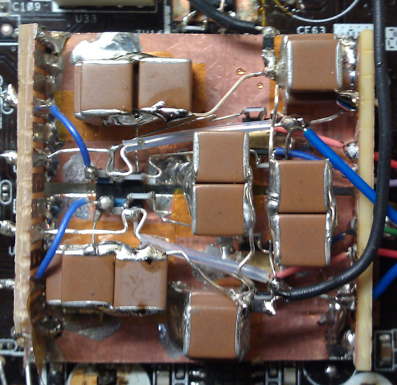

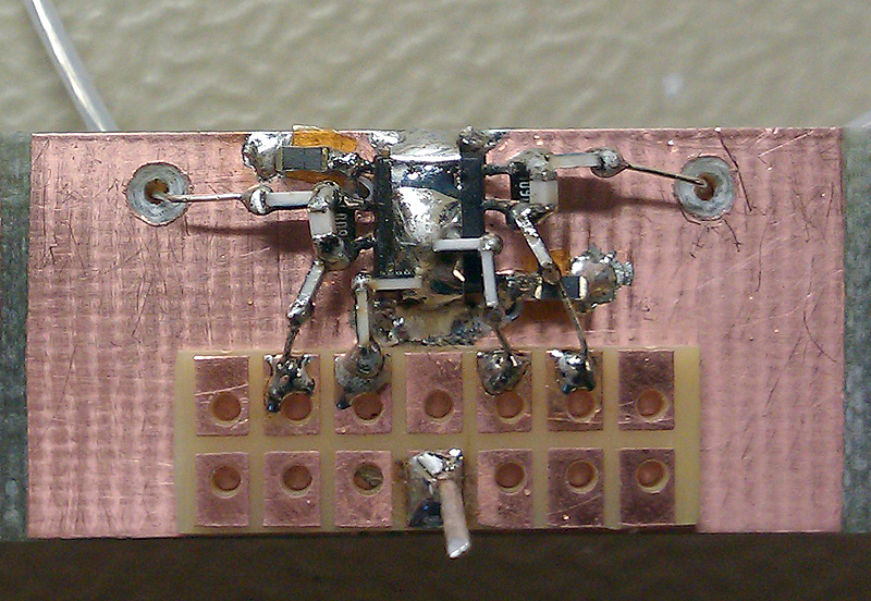

Some examples here of my technique. It works like a charm all those and another ones build in this way...
I promise that the next mods on BDP105 will look much better than those on BDP95... It were really heavy experimenting on this player audio board... The results are over expectations. Real and very high fidelity! It looks bad? Who cares... Only someone...
