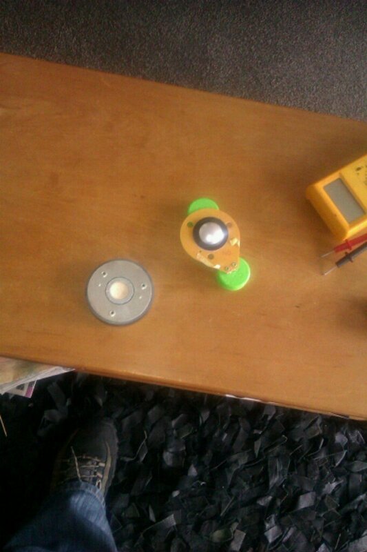

Yes I have found the break, just where it might be expected. The Celestion tweeter is one piece in as much as the voicecoil former is formes out of the same aluminium foil as the dome. This has the voicecoil wound around it and presumably epoxied to it, the break is where the voicecoil wire leaves the former. The wire is hair thin and I doubt I could make a solder joint strong enough to withstand the flexure at that point.Now if I had access to a laser welder and had hands like a pixy instead of a coal miner I might have a chance of repairing it. The other side of the voicecoil has some tell tale roughness in the same spot, this looks like it will fail too.
Post some pictures of this speaker because it sounds like you can help other users here. Measure the cabinet driver cutout sizes.

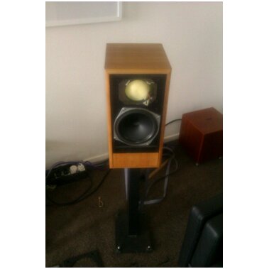

Here are a couple of low resolution pictures. I may post some higher resolution ones of the dead tweeter and measure the mounts shortly, when and if the mood takes me.

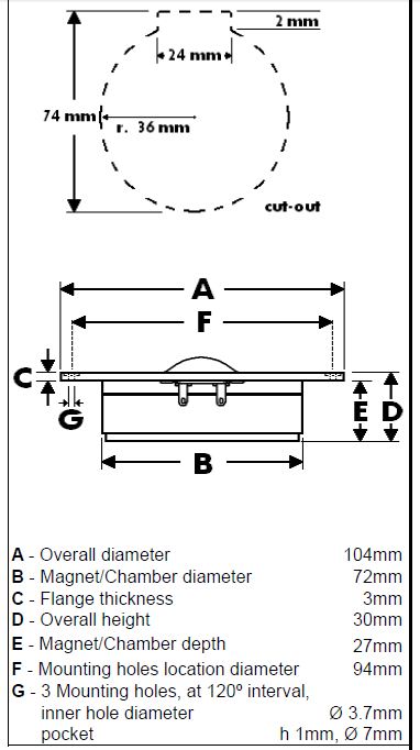

Lots of possibilities for improvement here. Just it ain't been done yet by any of the pussies on the web. As you doubtless know, I am very enthusiastic about carefully placed panel damping to upgrade speakers. But here's the Morel CAT 298 tweeter details to get you measuring and sorting out these piffling tweeter troubles. See if that'll fit. Crossovers to get it all working well are really kinda easy. We can do this. :cool:

An update though I got the tweeters successfully repaired thanks to some fine work by a local speaker repair shop-Axent Audio, very cost effective too!
Having completely dismantled the tweeter, I noted Celestion used a circle of felt to damp the chamber behind the tweeter. Just for the sake of experimentation, I substituted a similar volume of angel hair. A bit hit or miss but totally reversible if I don't like it. As it happens it was well worth while. Benefits include a more seamless sound and once again more headroom and low level resolution.

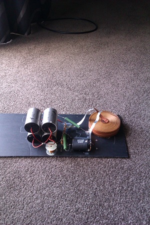

The parts arrived for the speakers. Crossovers were built temporarily on foam cored cardboard cut to size to fit inside the rear shelf of the Celestions.I will get around one day to fitting them into a box.
I took the opportunity to compare box to box with old crossovers. Tonally pretty much identical as expected but with additional high treble sparkle. They are clearly smoother particularly in the crossover region.
After fitting both crossovers and doing some extensive listening, there is substantially more headroom before the onset of hardness, the presentation is more detailed yet easier on the ear. I am quite pleased but I was hoping for good things after a substantial time and monetary investment.
