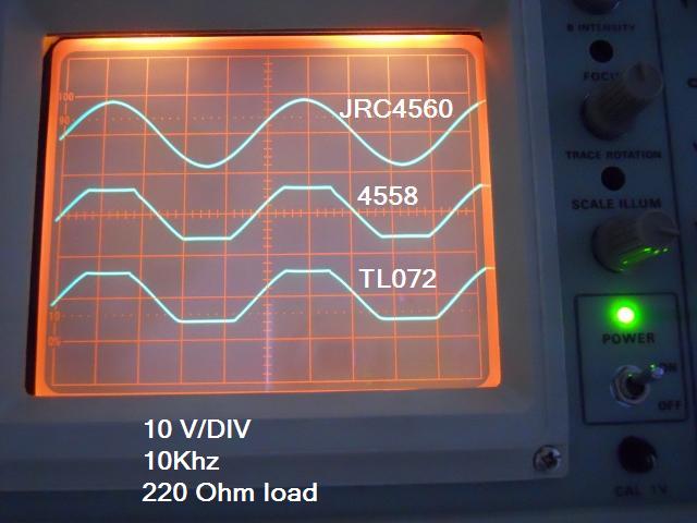

The BA4560 (I had to look up the RC4560 opamp to get this) has a high drive capability, twice that of the LM4562. I wonder if the impedance of the filter network is just loading the opamp output stage too much. That distortion looks like an output stage loaded to heavily. So you may have to use the 4560 where originally fitted.
The other issue is the PSU loading with all those LM4562's. They do seem to be loading the rails and causing a lot of high frequency hash on the supplies.

The OPA2134 is a possible choice for the 4560 as it has a good drive ability but I would say not for the 4558's as the power requirements stack up.

Choose an opamp with good drive ability for the BA4560, this is one area the LM4562 is not as good.

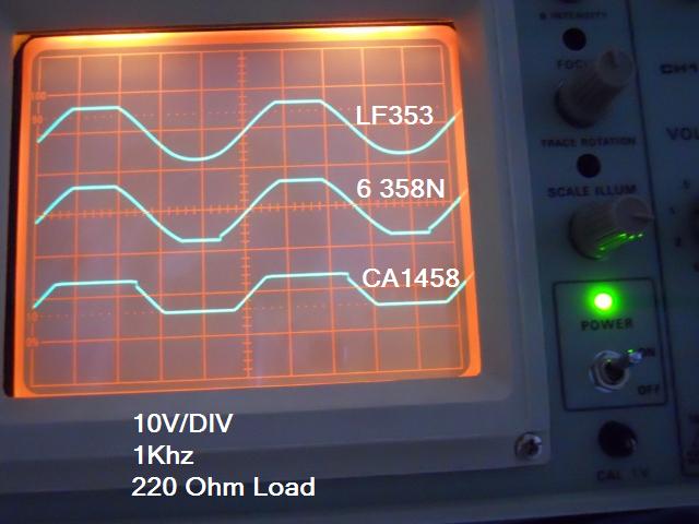

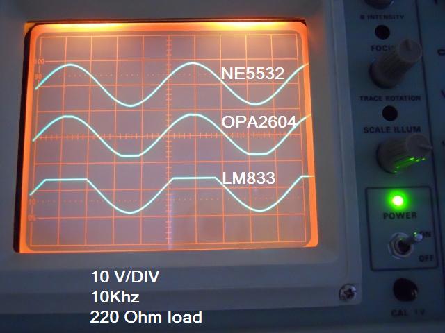

It's the ability to drive low impedance loads at full voltage output. Most modern opamps are specified as being able to drive 600 ohms fully. In the data sheets a clue is in the maximum available output current. You also have an additional problem of a PSU that is very limited in output and so that means the IC's used must also have a low quiescent current as well as good drive.
For example if you can draw say 100 milliamps max from the supply before problems occur and you have 10 opamps that draw say 4 ma each then you are already drawing 40 ma. Drive the opamps hard and there is only 60 ma "left" for the opamps to pump into the filter networks. And that is OK.
Now swap the opamps for some that draw say 8 ma and you are already pulling 80ma from an 100ma supply. So there is nothing left when the opamps need more current to feed the filters.
Theory into practice
Different opamps when resistively loaded.
