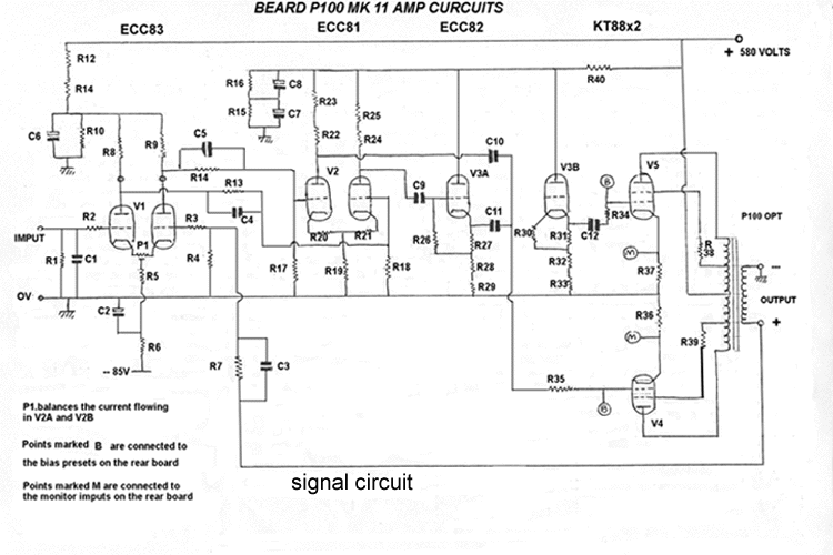

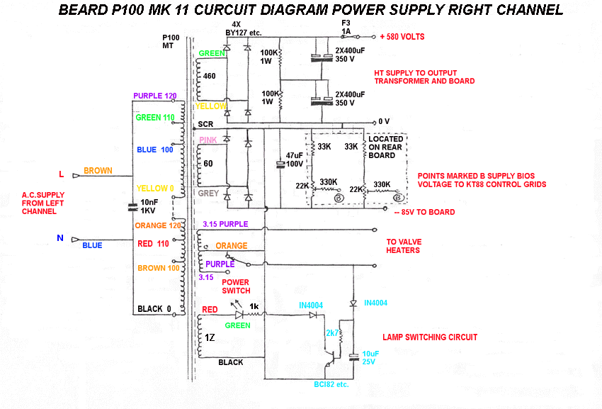

The P100 evolved over a few years from its original concept, the P80; when the USA wanted a more powerful amplifier and hence the MK1 and MK2.
Depending on the age, you will see major changes to the biasing and even the driver circuitry, so it is important that photographs be sent to me
chris@beardaudio.com together with the serial number for me to identify.
I will also warn people, this amplifier is one that will bite; it has up to 600V per channel and can be very dangerous to everyone including the cat, so if you intend working on this you need to have special equipment and gear to protect and inform you.
The schematic, because of its generic nature, only applies to the MK2.
DO NOT RELY ON IT.
Be very careful this amplifier can kill you, if you do not feel qualified do not go inside.
Yes, I know it is tempting to go inside but I am sure your family would not be happy with you in hospital or even dead.
We are not liable for any damage or loss of life if you disregard our instuctions.

Why don't you try PM Chris above?i really really need its schematics for phono resistors values
