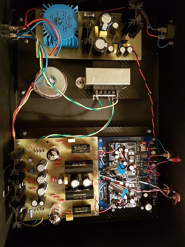

Hi Simon,
Thanks for the note. I was sure I had seen comment to the fact that more than one board is needed for the cinemags, but happy to be corrected if 1 is sufficient.
The BCF user guide can be found here -
http://glass-ware.com/User_Guides/BCF 9-Pin.pdf
Photo of my DAC below.
I am already thinking about stage 2 on this, as I ideally need a little more gain, so am looking at the Broskie Unbalancer which is basically the BCF with a differential gain block on the front. Will let you know how it goes.
Steve

Hi Steve and others
I am very interested in you experience with the BCF/unbalancer. I have an older DDDac(without Tent reg) and need to make a decision on the path ahead.
I run it into a single-ended hybrid integrated amp and it has served me well over the past 2 years but in comparison to a commercial NOS pcm1704 dac(aqua La Scala) it just doesn't have the verve and drive of the higher output unit from Italy. A bit higher output might come in handy as well as the ability to convert the balance to the SE output.
I use the DDDac without output caps and one of my concerns is the signal caps of the Valve buffer?
I also wonder what valves you use, ecc82 and ecc99 would be my 1st stab if I had to make a call on it?

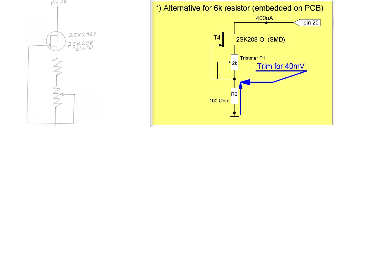

Ok, also late at the party. I built the ccs with the 2sk246y.
I made it on a protoboard and checked it 4 times. I'm getting 2.4V when connected to lab power supply and in my DAC but no current anywhere I connect my multimeter.
I'm not building this on a DDDac but in a different 1x PCM1794 DAC and it worked but I can't say that it was better than the 6k resistor.
Anyone have a clue? Am I doing something wrong?

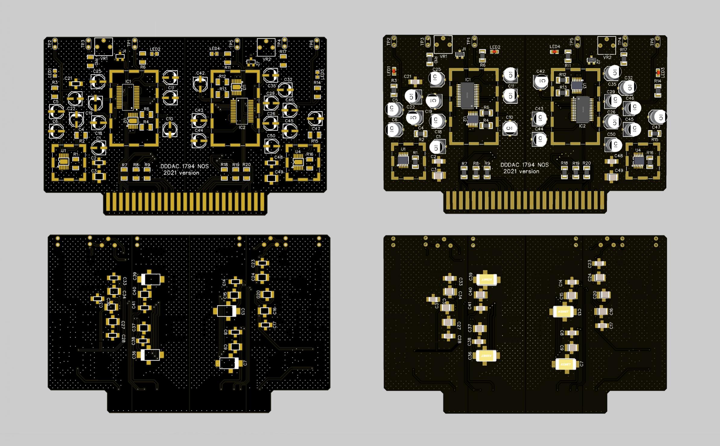

Okay guy's, I think I feel comfortable enough to make this entry so here we go :)
I've been on an audio quest for some time. It started in late 2014 with a "simple" question: "What is a loudspeaker?" While such a question might seem trivial to many of you,
for someone who had no experience in engineering and designing loudspeakers, it is an important question which leads to multiple ways to answer it. While this thread is not
about loudspeakers, I just wanted to share the beginning of why I am here and what I am doing.
I came to a point, about 1½ year ago where I realized that in order to properly evaluate my loudspeaker designs, I need reference level equipment. Since I have a limited budget
and can't afford stuff that would cost me tens of thousand dollars, I figured I could spend some time reading and researching what is worth chasing down, and while I have been
rather successful doing so for power amplifiers, what remained was the preamplifier, d/a converter and music server. That's when I ran into the Burr-Brown PCM1794 Delta-Sigma DAC chip
which seams to very popular and can be found in many converters and one of these converters is the DDDAC 1794 NOS designed by Doede Duama. I was initially going to build
the Yamamoto YDA-01B with a tube output stage, but reading some reviews about this paralleled DAC made me curious, curious enough to wanting one for myself.
But it's not a perfect DAC and some of the "flaws" was covered by another member who also designed his own improved version. This edition was covered earlier in the thread and was
designed by Enrico. And just like Enrico, I wanted some improvements, ontop of what Enrico already did, so I started studying components and what's important when designing PCB's
and arrived at what you can see attached bellow. It's still early day's and the main-board as well as the PSU need to be designed and optimized, but I can share some of the structure
and components which is part of the project and DAC module (seen in the attachment).
The DAC module.
- Separate Left and Right analog & digital power supply.
- Separate left and right analog & digital gnd.
- Separate A.D LT3045 LDO voltage regulator for the analog & digital side of the PMC1794 d/a chip. There ar 4 LDO's per card.
- Each PMC1794 and LT3045 is protected by Laird Board Level Shield. That is the weird rectangles you see on the front.
- Resistor are Susumu RG 1206 thin film.
- Bypass capacitors are:
  • Panasonic OS-CON Polymer (SVPG) - 15uF - as the main bulk capacitor on the analog side.
  • Panasonic SP-Cap (LR) 3-terminal for very low ESL - 68uF as the main bulk capacitor for the digital side. 50% lower ESL than your common 2-terminal capacitor.
  • These are accompanied with a MLCC of the X2Y variant which is also a low ESL variant. Values here are 1.0uF and 0.1uF. The MLCC is placed very close to the operational pin of the PMC1794.
    Which you can see on the backside of the PCB.
- The variable resistor is Vishay Accutrim 1240 foil type.
- Each 3.3V & 8V line has test points for monitoring, placed at the top edge for ease of access when the cards are installed.
- As you can see, this PCB feature the card edge connector style for easy installation and removal if the card need service or repair.
I will give the main board and PSU a similar treatment as I did for the dac module, so expect more to come as these are finalized. The full realization of the project will take a few months
as it also need it's own bespoke chassis.
Comments, advice and general feedback is welcome :)

Hi ... A suggestion could be to dismount the CCS board and connect the pin going to pin 20 (Iref) to a 2.4 VDC voltage source and check if the CCS works as intended (may also be e.g. a LiFePO4 battery). And, if you have been soldering near the adjacent pins then check that none of the pins has been shorted.
Jesper
I had some problems with mine. Checked the schematic and it was correct. But I rotated the part 180 degrees on my board and it worked like it should. I don't know why but it did. Maybe something to do with the internals because I thought they worked both ways. Seemed it didn't.
Joined 2007
Which one is the right one?
Well, they basically are both right - they just do the same (adjusting the voltage drop from the JFET's gate to source and hence the drain current) in different ways. The right one is the one Doede Douma (DDDAC's creator as you may know) shows in his schematic.
Anyway, personally I would adjust the CCS to the right current, unsolder it and replace the trimmer and 100 ohm resistor with one fixed resistor (can be less thermal drift, smaller (EMI reduction), and closer to the underlying GND plane). Just my thought about this.
Susumu RG or RR1220 could be resistors to use (but there are of course other options).
