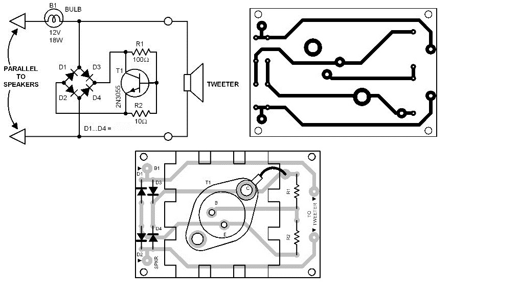

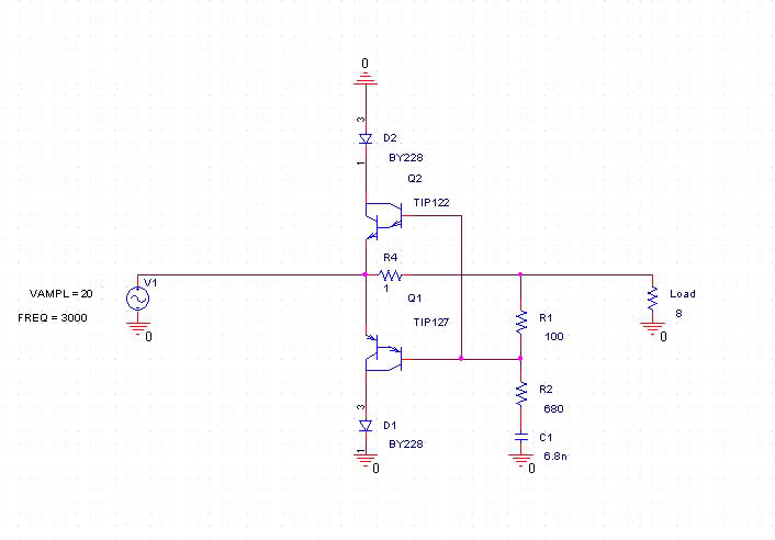

Even though I have a more updated crossover and polyswitch The rx22's are "over powering" compared to the 14xt's, they must be more efficient or something, I am going to try tri-ampimg this setup and remove the passive crossover, I have a three way crossover, that way I can adjust individual volume levels to my taste. I will try to utilize the cd's polysitch protection circuit though. Why didn't I think of this before ordering the passive crossovers?
You can also consider using in line self powered tweeter protection techniques. They are quite effective and superior to the regular poly-switch lamp arrangement. There are ,many approaches towards this direction. Search Google to find out schematics related to this.
I searched few & had attached them here. Rest you have to decide.
