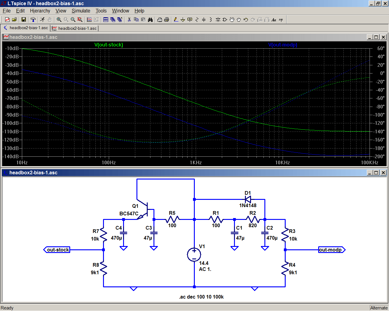

The concept generally looks sensible enough (clearly designed by a veteran or at least someone familiar with tube circuits), bar a few things I'd take a closer look at:
1. The capacitance multiplier for bias / virtual ground supply looks like it may have too little voltage headroom for ripple IMO. Not sure why they chose a 100 ohm base bias resistor - there would be precious little voltage drop across that, and it makes the 47µF less effective than it could be (why use a cap multiplier when you might just as well go poassive instead?). I would propose the following mod:
a) replace 100 by 1k and add 12k in parallel to 47µF (you may be able to go even higher, like 2k2 + 27k or 4k7 + 56k/62k)
b) swap 10k and 9.1k R3 (I chose the resistor ratio in (a) specifically so you can do that, hopefully I didn't screw up the maff)
c) add reverse protection diode across NPN E-C (cathode to collector) - 1N4148 may do, 1N4001 would be better.
Honestly I'm not convinced that this setup (as shipped) even is more effective than some passive filtering. You could rip out the NPN, replace its B-E junction with 820 ohms and still add the protection diode (c), and I bet you'd be no worse off than stock.
Well what do you know, LTspice agrees with me. In fact, ripple rejection at 100 Hz goes up from 37 dB to 64 dB. How silly is that. (And no voltage headroom issue either!) In fact, I have to go with 2k2 / 27k in (a) before performance of the modified stock circuit becomes equally good, and with 10k / 120k for a marked advantage. (Attached simulation with 47k / 560k delivers 88 dB.) Let that sink in, you could have made this circuit simpler, more robust and a smidge cheaper with better performance, or squeezed out even better performance for the grand total of one more 1/4 W resistor and one more diode.
Hence why all the world uses passive R/RC filtering for such virtual ground bias and gets away with it.
2. Of the 3 output stage bias diodes, move two to touch BD139/140 transistor cases (e.g. thermal glue, epoxy). That should improve thermal stability, especially when the whole affair is pushed into AB operation (which it will handle but not particularly gracefully). Responsiveness may be improved further if one diode leg is moved directly to its corresponding transistor base leg (thermal conduction through metal is much faster than through plastic). With the bias diodes running warmer, the 22k resistor may have to be adjusted up a bit.

Thank you sgrossklass for your interest.
I have never taken care of the power supply for the virtual earth, and perhaps I have even misrepresented the function of the transistor: I thought, with the 47uf capacitor, they wanted to delay the entry into operation of the circuit at power on. In fact, if in its place we put a 22uf cap, the starting time is halved..
Incidentally, I checked the resistor, and its value is actually 100 ohms.
I have no power rejection problems (I am convinced that the problems of willemhoekstra depend on mass loops - see the attached photo), but I am interested in your modp, in order to make the circuit more robust (in fact I have already fried two transistors in that position).
In the next few days I will try the change and publish the result here.

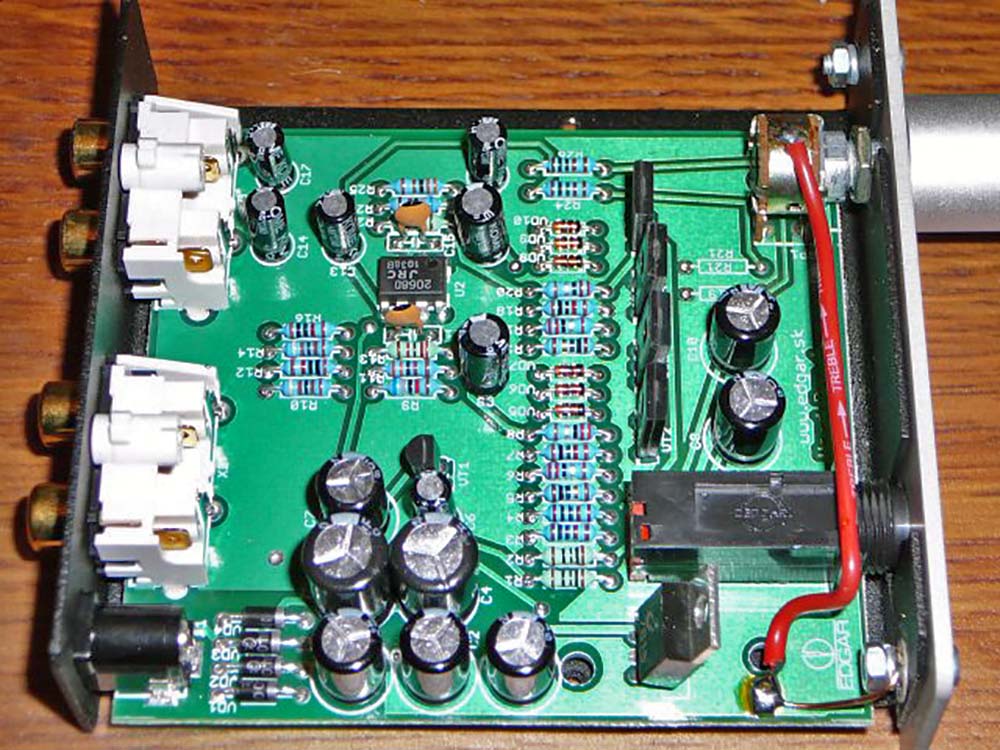

Regarding the ground connection of the case, I found this photo on the net.
Ouch. The protection diode may have helped avoid this, at least it's a proven approach for regulator pass transistors when sizeable capacitors are present on the output side (which is the case here). Otherwise said output capacitor may keep its voltage high for much longer than input voltage stays up, subjecting the poor transistor to substantial C-E reverse voltages up to the point of breakdown.
So basically case front connects to grounding point on PCB, then the case screws together and is all grounded that way. I can only assume that willemhoekstra's unit might have been tampered with before or there is some sort of bad solder joint, loose connection or oxidation going on. With the picture for reference, it should be easy to find the issue.

About the humming noise, the photo with the red wire was very helpful. The unit I got had not any effectieve connection of the PCB ground the chassis. Just a wire from PCB ground to the chassis I tried but was not very helpful. Inspired by the photo I grounded the housing of the potmeter too. The Axis and housing were floating wrt ground and the case although it is fixed using a nut to it.
After soldering a connection of PCB ground to the chassis AND to the potmeter housing the humming disappeared. Thanks very much !!!! I use this amp to be able to listen using headphones on a SONOS.
Willemhoekstra, I am happy that the photo I found on the internet was useful to you: at least we have achieved a concrete result. It is true that it would be better to dedicate the summer (always more beautiful as the years go by) to other things, but I am in a fairly advanced experimentation phase, and I need little time to publish the updates here. Do not forget to check this discussion, and then, next winter, we will be able to compare our changes. I promise some news, fireworks, hopefully with little magic smoke ...
I must point out (also to Stephan sgrossklass) that the photo of the red wire does not belong to the stock, but it is already a modification by someone who had the same problem.
Quote sgrossklass: Ouch. The protection diode may have helped avoid this
Yes, after you wrote this here, I realized it could, like as it is recommended with Lm317.
Quote sgrossklass: ]the supply voltage likes to sag under load .... and then tweaked values for maximum output in a given load impedance range.
Very clear explanation, thanks. I would never have gotten there alone. However this design could be inherited from an unstabilized supply. Here it may not be necessary, as we have a robust 7812.

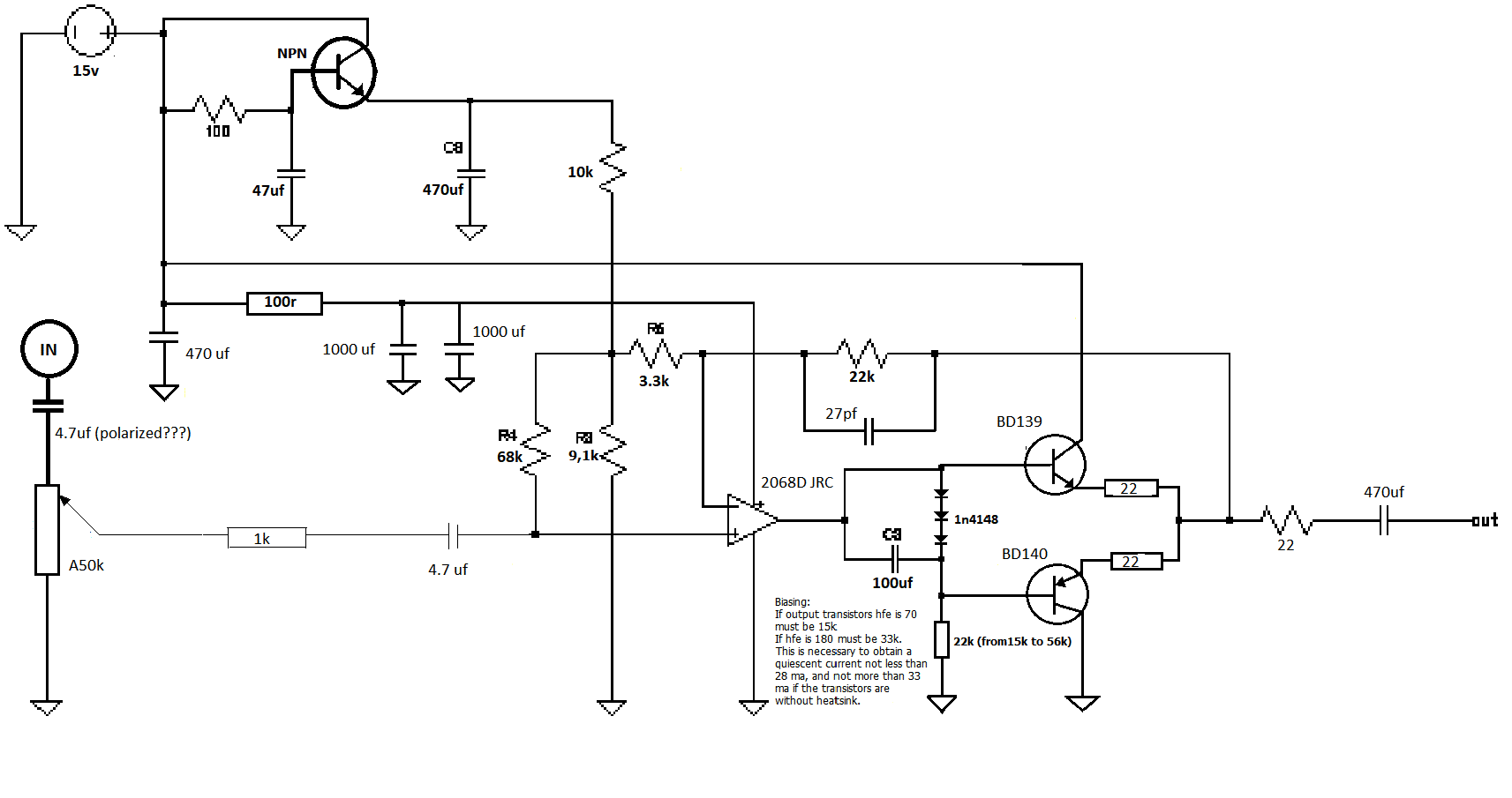

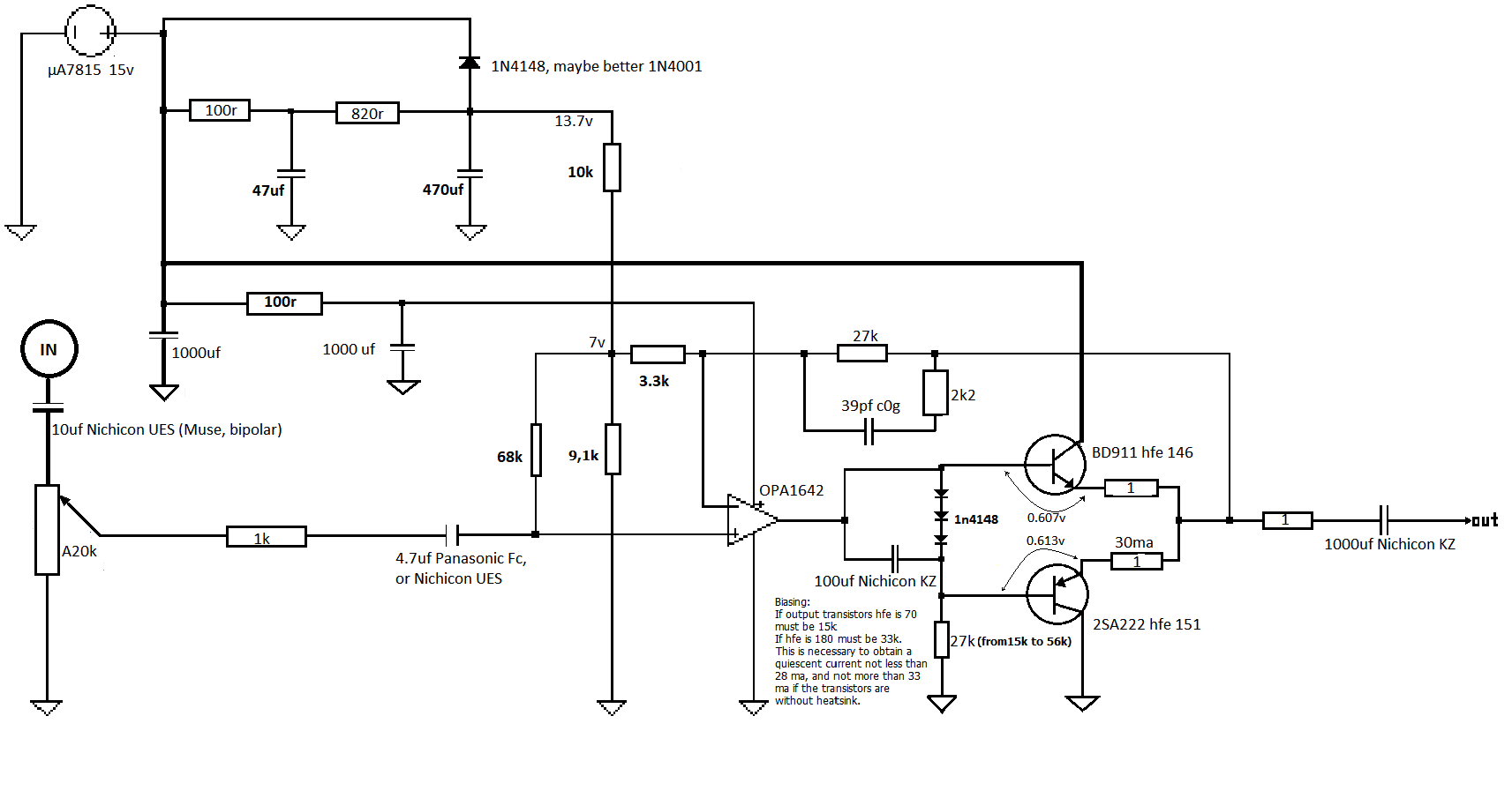

Here is the schematic of the amplifier how it is working right now.
The choice of the final oversized tranasistors is not part of the 'recipe': they are the ones I managed to combine according to my idea (it is possible that it is not new, however).
In any case, in my opinion, the BD139-140 of current manufacture are not suitable for authoritatively driving headphones, and they give a flat sound.
Someone said a long time ago, in the seventies: "NPN, PNP transistors are as truly matched as men and women of the same height and weight".
So I matched them following another theory.

I followed the suggestion of sgrossklass:
I can't say for sure that it's better, but it's certainly not worse. It is certainly more robust.
The amplifier thus described sounds quite good. We will see if we can understand the nature of the problem that occurs in some passages of the female voices.
It must be remembered that there is a review on Head-Fi entitled "Pro-ject Headbox II: First impressions" which, unfortunately, is perfectly in agreement with my own impressions.
The final transistors are matched of HFE and VBE, but also of a third characteristic, which is my 'trick' (or my illusion).

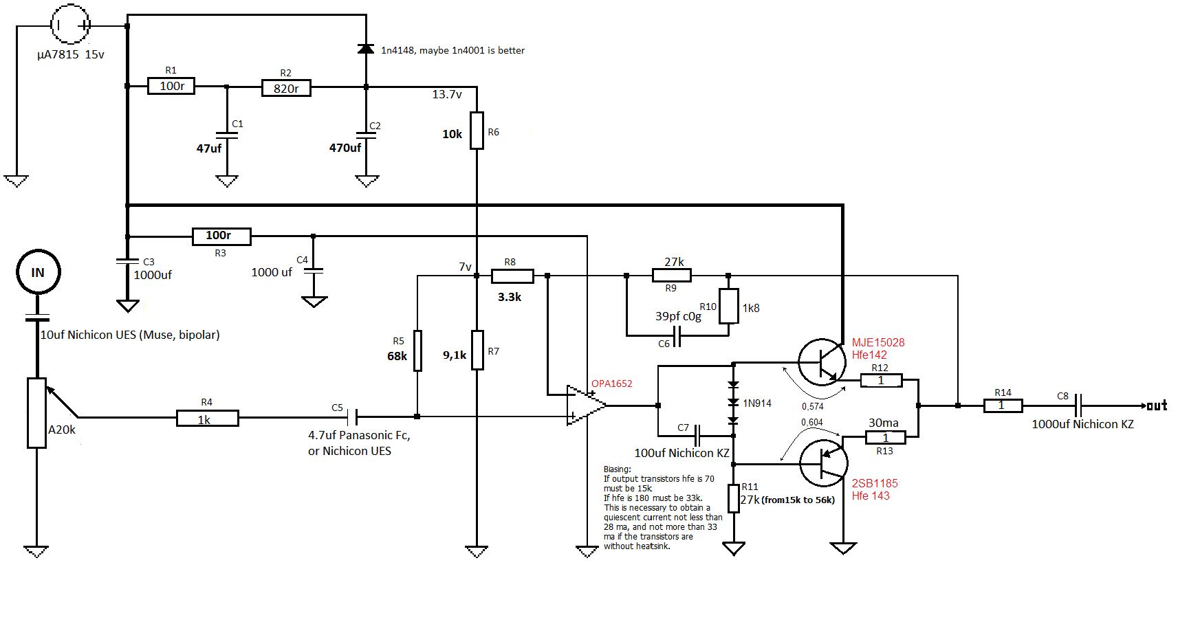

Pro-ject Head Box II - las mods (maybe)
Hi folks!
Perhaps the time has come to close the case: the final changes should be that of the attached diagram.
There are two important changes compared to the latest version.
I have definitively adopted the OPA1652 (18 Mhz) instead of the OPA1642 (11 Mhz).
In this configuration, for me, it is by far the best compared to many tested.
Here is the list:
JRC2068D (stock), JRC4562D, JRC5532D (good, better than NE5532), LM4562 (National), NE5562 (TI), OPA1612 (here it oscillates heavily), OPA1692, OPA1656, OPA1642, OPA2209.
The replacement of OPA1942 only occurred when I replaced the ouputs with the following 'married couple' (remember Vereker's phrase): MJE15028 (30 Mhz) + 2SB1185 (Rohm, 70 Mhz).
I paired them based on HFE (measured at 6ma, having only a Mega328), and the VBE, unfortunately, is adapted with a 5% deviation. This is probably the limit to be respected.
I think I understand (this is the trick I was talking about) that the most important thing is to synchronize the phase of the two half-waves of the signal, as happens in the famous Naim amplifiers with the adoption of two compensation networks. Here another method is used to achieve the same result.
Now the amplifier sounds 'good', balanced throughout the sound range, with deep basses. I can listen it for hours without fatigue.
Thanks again to Sgrossklass for the suggested modification (a resistor instead of a transistor), which proved to be perfectly effective.
