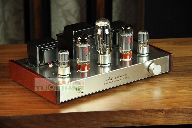

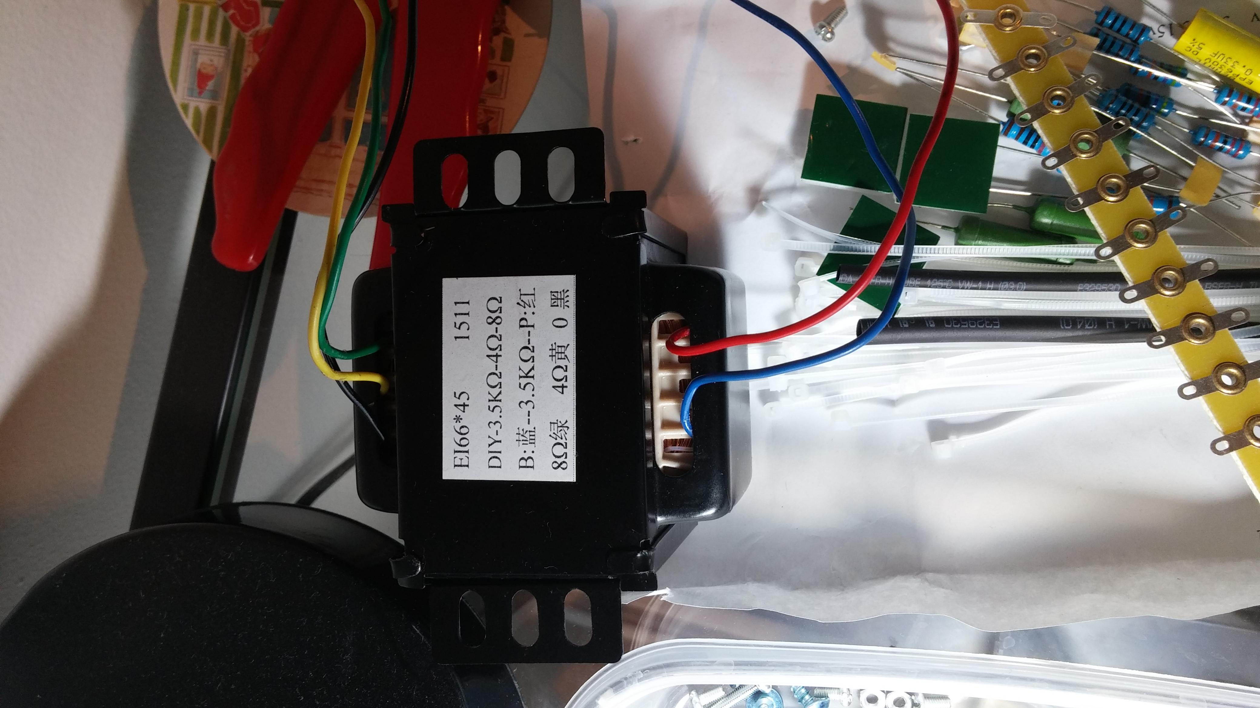

Hi everyone,
I've recently put together a 6CA7 (EL34) + 6SL7 (6N9P), 15wpc DIY bought from the internet, I'm looking at improving the sound as much as possible mostly for my own learning and enjoyment
I want to upgrade the output transformers. The ones that came with the project are 370 ohm on the primary (measured with power off), with 4 and 8 ohm outputs (see attached pictures).
I've been looking at Edcor and Hammond, I read the Hammond are better but I'm not sure how to choose them.
How important is the impedance and how close should I match it? Is is measured with power On or off? Do you have any other suggestion for output transformers than Edcor and Hammond? What about inductance (henry's), how important is that?
Sorry for so many questions, as you have figured, I do not have an background in electrical science...

Whoa, hold on cowboy!
The primary AC impedance of the output transformer is not the same as the DC resistance (AKA DCR) of the primary. When you measure across the primary with a multi-meter, you're getting the latter and it isn't all that useful when transformer shopping because they're rated with the former. You're looking at OPTs based on the wrong spec.
In the schematic, your primary impedance appears to be marked as 3,500. You're putting about 340 V on the output stage at 50 mA (based on the schematic, tube is biased at 15V with a 300 ohm resistor). It is also connected as Ultralinear.
This is what you want in a replacement:
Primary Impedance 3,500-5,000
Includes Ultralinear tap (AKA UL tap)
Single-ended output transformer (AKA air-gapped)
DC current rating 75 mA+
Multi-tap secondary if you want to use 8 and 4 ohm speakers
Wattage rating 20W+
Appropriate from the Hammond data sheet:
1630SEA
1628SEA
Edcors don't usually include multiple secondary taps, so you'll want to pick the CXSE that matches your speakers. The model numbers follow the pattern CXSE(wattage) - secondary impedance - primary impedance. If you have 8 ohm speakers, look at CXSE25-8-3.75k (or 5k). If you have 4 ohm speakers, CXSE25-4-3.75k (or 5k).
Also, check out Transcendar outputs. They are very nice and reasonably priced. He probably has a 15W that would work for $100 each.
That's a pretty looking amp. Welcome to the hobby!

It isn't necessarily the case that there is anything wrong with the provided output transformers, and it isn't necessarily the case that replacing them with something else is going to net you any significant improvement in performance, and the reverse could well be the case.
You need to learn a little more before running off and making such a significant change to the amplifier. At the very least you ought to know what the maximum output power is at clipping for a range of frequencies, what the actual frequency response of the amplifier is at a couple of power levels commensurate with how you use the amplifier, and what the distortion performance is like.
Changing the output transformer is not going to increase output power capability very significantly, if the transformer quality is poor it might give you a little more power at the extremes and less distortion overall, but just changing it does not guarantee that outcome.
If you have insufficient power for the current speaker in use increasing primary Z to 5K will just reduce output power while potentially improving average linearity until you run out of headroom.
I seriously doubt that most Hammond output transformers are going to be significantly better than what is in there now. Something from Electra-Print, James, or Transcendar might be worth the trouble if your unknown OPT is as mediocre as you think it is.
I don't follow your comment about bias measurement at all. The output stage bias is calculated by measuring the voltage across the 300 ohm EL34 cathode bias resistor, at the given 15V that would be equivalent to 50mA. (I=E/R)

I'm glad you figured it out I noticed that there are two 6N9p tubes in the picture and that the schematic makes it look like both triodes in each tube are connected in parallel. So you have a full octal socket dedicated for the input on each channel. That leaves room for a lot of fun experimentation and optimization down the line. Have fun!

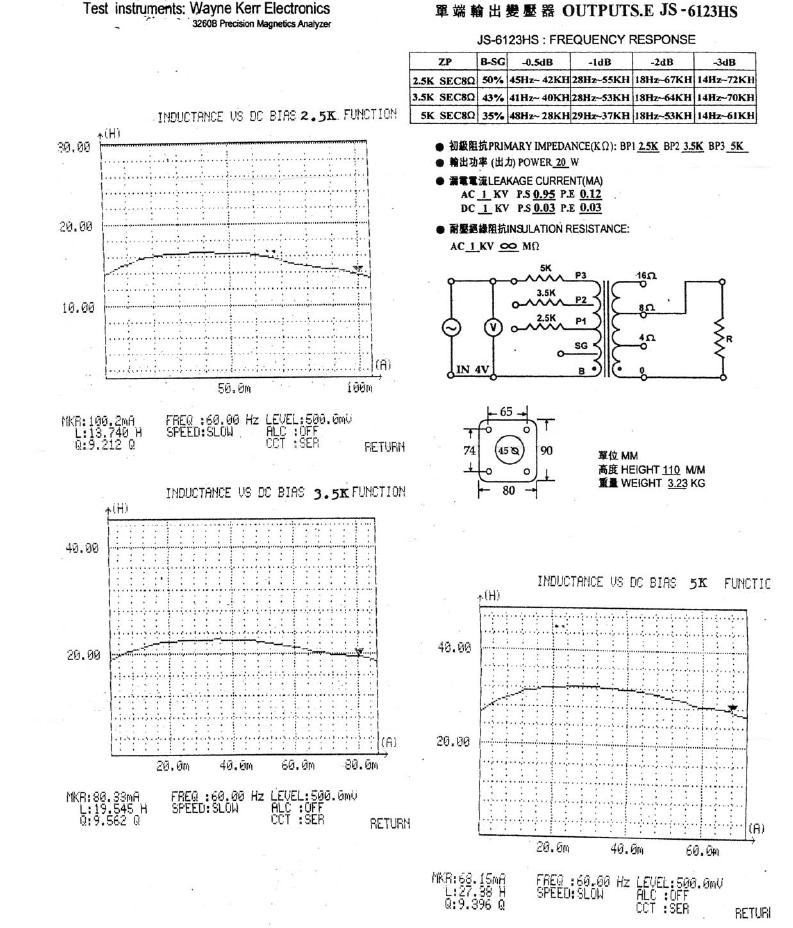

So, following Sodacose's advice on specifications for the OPT and following Kevin's advice on brands, I came up with the James JS-6123HS OPT since they come in three different built-in impedance (2.5k/3.5k/5k) and they are fairly priced in comparison with the electra print especially and even the Hammond.
Am I ready to order?
James Audio JS-6123HS Output Transformers - factory matched pair
on ebay.ca:
Black JS 6123HS Jame Audio Tube Output Transformer FOR Western Electric 300B | eBay

Those James will work and they'll let you try more than one primary impedance (great for experimenting). I haven't personally used James, but I have heard another James model in a very nice push-pull amp (SY's Red Light District).
Just to muddy the waters, here are the Transcendar 15W options:
Transcendar Transformers - 15 Watt SE
There's a 5k with UL and multiple secondary taps for $100 each. I have used Transcendar and think they're the bee's knees. I've read plenty of positive opinions about James too, though.
If you use either of these options, you can rest assured that the output transformer is not holding back the amplifier's performance. On the other hand, that may already be the case with your current output transformers. On the third hand, you'll have an extra set of output transformers to build a new amp around.

The amp has 15 wpc and I was told I should aim a bit higher than the amplifier's output power, so I was looking into 20 watts, should I go for 15?
Only the 15 watts 5K has the 40% UL tap
The 20 watts only comes in 3K or 5K both with UL 40% tap
I can't find if the James have a UL tap but it doesn't seem so.
I'm not using the tap as it is now. The 2nd grids are currently on B+.
Bottom line its either
Transcendar 15W, 3.5 K without tap
Transcendar 15W 5K with tap
Transcendar 20W 3K or 5K with tap
James 20 W 3.5K without tap
