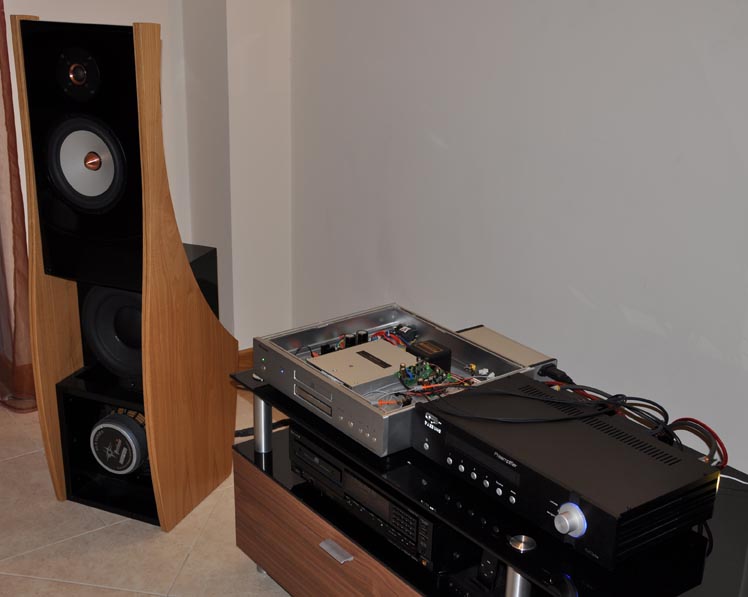

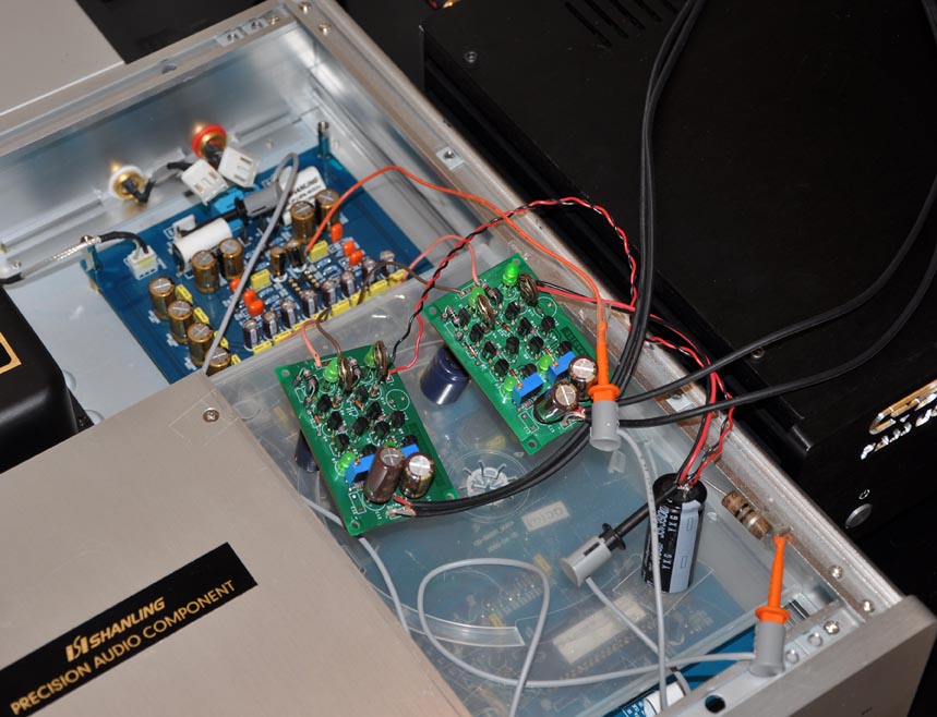

First some pictures,
1 - Playing
2 -Test Rig
3 -Signal and power connections.

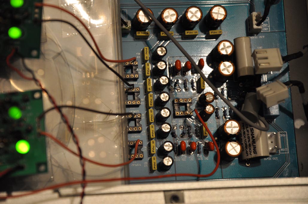

1 - First of all i adjusted the voltage at each DAC current out put to 2.5V with the trimpots, no problem.
2 - verified the Shanling board and noticed that in my enthusiasm i had cut the DAC current ref resistor, so i reconnected it.
3- Verified that indeed that all old analog section was disconnected from DAC chip.

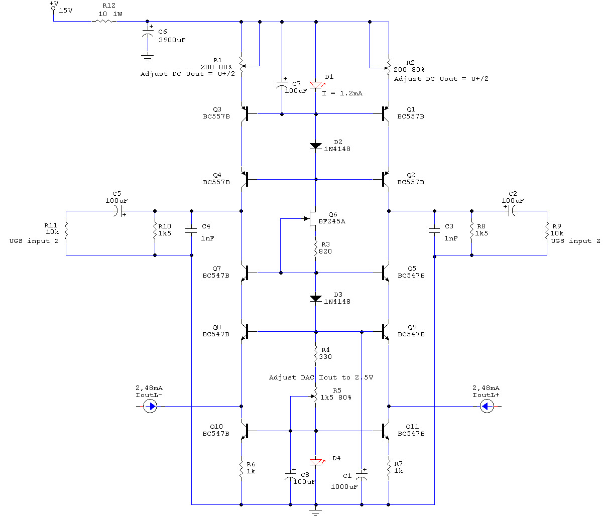

More tests

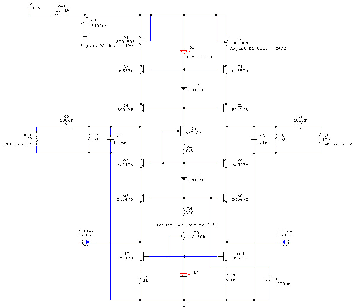

Hi again,
I figured out why the bass wasn't as deep as was expected,.....my BAD !
The V/I resistor ! ( R9 and R10 in the schematic ), the higher it is the better bass gets but is limited by the value of R1 and R2, if it is too high( above 1k8 ) then the pots can no longer adjust symmetric Dc out and uneven clipping occurs.
With the values shown sound is as described in previous post, fantastic.
The 47 Uf cap at the output is just for testing, will have to be optimized.
Further note: present circuit is easy to adjust to optimum values of 2,5 V on DAC Iout and center leg current to 1,2 mA ( these values are measured ! ).
Joined 2006

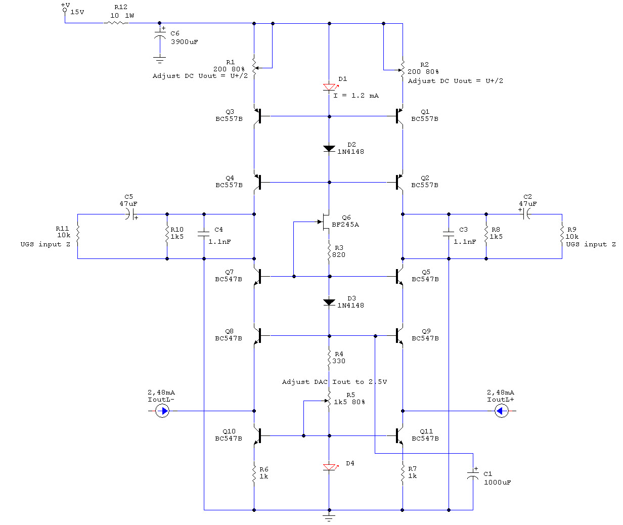

RED Leds
During the weekend i decided to go over the alignement to see how stable it was nad to change the leds for matched sets, in this case red leds.
Since i had read somewhere that they can cause noise, i had done some searching on the web but came up emptyhanded....
The sound seemed a little cleaner after the change and realignement, but these are tiny details but since i'm finishing the PCBs i'd like to consider everything so i will not have to change them.
I did come across a coment that was supported by measurement, that bypassing the leds with 100U caps will lower LED noise and significantly improve PSRR....i would apreciate any input on this.
outstanding poits i would greatly apreciate input on as well are:
1 - output cap, which to use, right now i have 100u/25V ELNA.
2 - IV resistor, riken, Vishay dale ??? and more importantly 1k5 is recomended value ?
3 - bypass cap, right now is Wima FKP2 1nF.
Judging by my ears sound is very very good but if choosing the right components will improve it, obviously i'll do that....within reason:cool:
updated shematic:.....i haven't tested the LED bypass yet!
:D
1- use your own poison - Silmic ,BG ...... whatever ; you can always try to bypass it with 10n polycarbonate cap
2- same as (1) - some ppl prefer even plain Alen Bradley carbons .... I'm not loosing much of my sleep regarding issues like that one . 1K5 is just starting value ... I'm glad that you found influence on bass there ....
as long you can set proper DC voltage for DAC chip takeout points , any similar value is good .
3- polycarbonate is always my choice for speed ( wtf is that :rofl: ) ; you can also try mica
regarding LED bypass - let your ears decide do you need them or not ; just try ,then decide .
Joined 2006
Thanks Zen Mod,
My ears tell me that i've never had better sound, i'm really happy with these thingies.
I was a bit surprised that i had to go all the way to 100uF for the output cap to get the Bass all in but the result is spectacular.
I'll try bypassing them with the 10nF caps you suggest and see what that does to the sound.
LEDs...if i remember well it seems that the LEDs will typically produce in the order of 40uV noise and bypassing them reduces that by +-10% but the impact on PSRR is much greater ( but then again i would suppose only if one has a really bad PS )... frankly i don't feel the need to try that as a priority, first i'll do the I/V resistor and output cap with bypass.
Thanks for the patience, from now on...only one project at a time...i like to finish them !

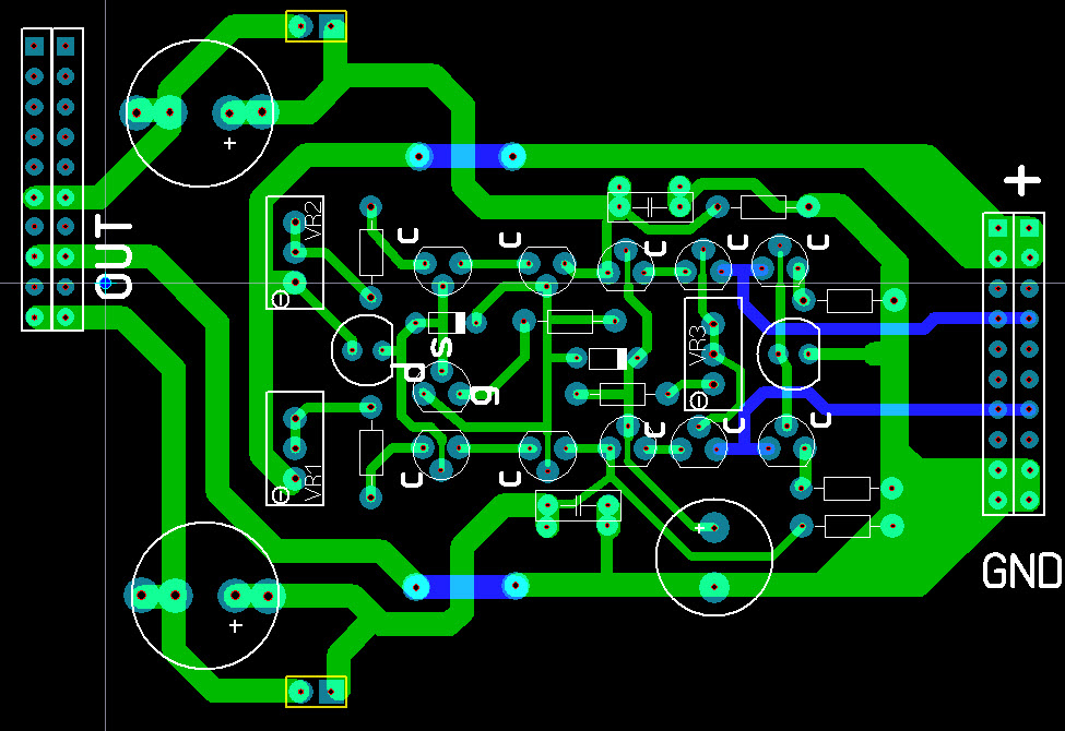

Joined 2006
Here are pictures of actual state, i'd say finished ...yes, Motherboard and module PCBs...so i can do some more development later...hehe.
You can and should ask...i'll send them today after checking the boards for errors.
meanwhile...pictures:
Before you ask...the MBoard connects piggyback to original Shanling board through y wirewrap sockets...dificult to find but i got them.
Joined 2006
Latest developments:
I had been wanting to try a little higher IV resistor, but knew i had to change the bottom resistor ( which was at 1K ) to be able to adjust the DC Voltage at the terminals of the IV resistor to +V/2...in this case 7.5V.
With IV resistor at 3k3...thinking that this should make life easier on the transistor delivering the current...since less is needed...
Bottom resistor is set at 100R.
All adjustments are made with no problem: DAC signal points are set at 2.5V and IV DC voltage at the mentioned 7.5V.
Listening:
Sound is indeed more relaxed...effortless, bass delivery in particular is amazing... powerful and well defined, voices seem even clearer and no harshness has crept in at the top end......simply gorgeous.
I hope some of you build this and compare notes with me, i would love a few more willing ears to sample the sound of this thingy and give me as impartial opinions as is possible.
Right now i'm going to enjoy the sound ......
