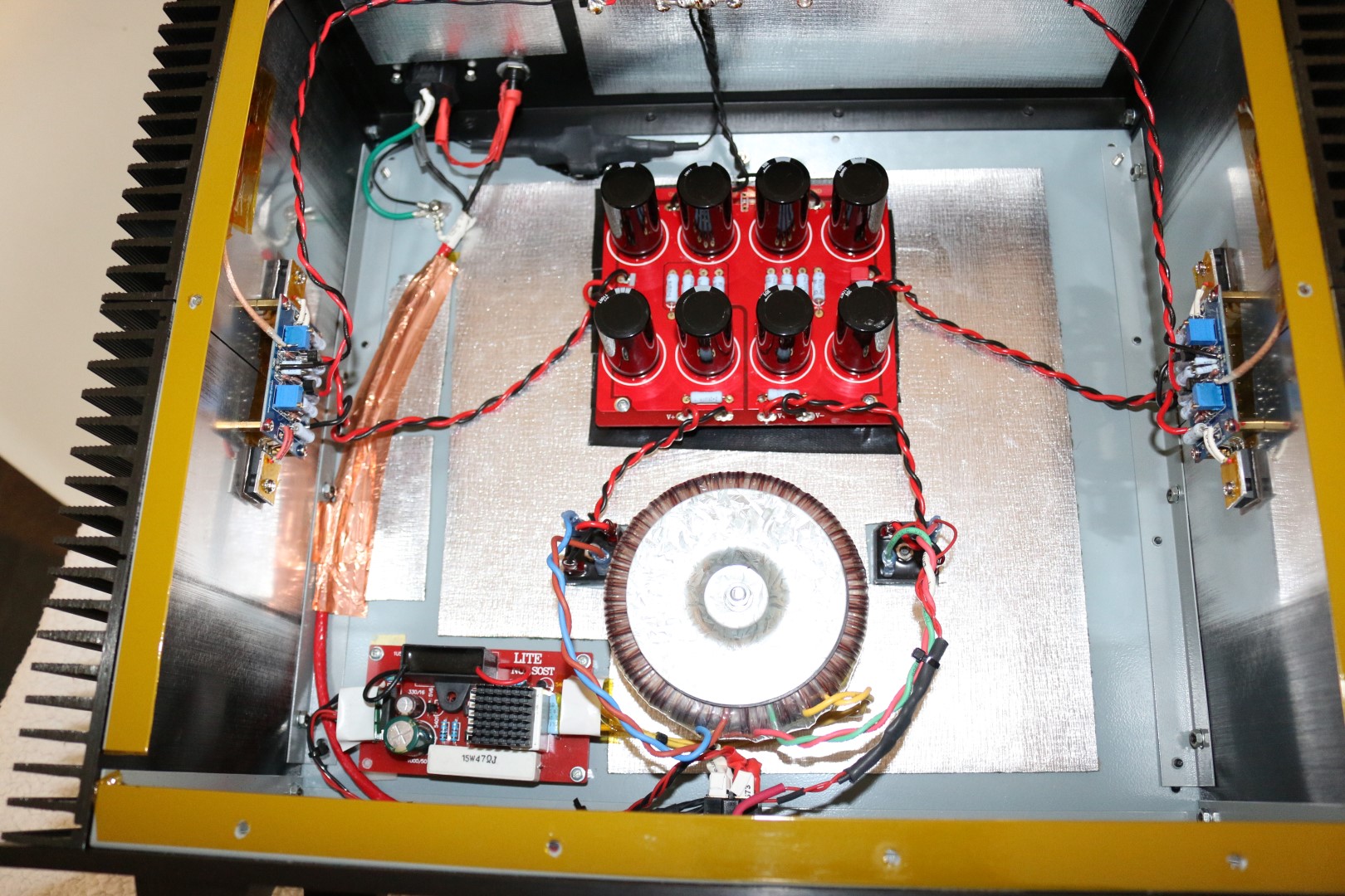

My associate and I are jointly putting this F5 to F6 Upgrade together
he is a lot better at soldering than me.
So the upgrade build has begun

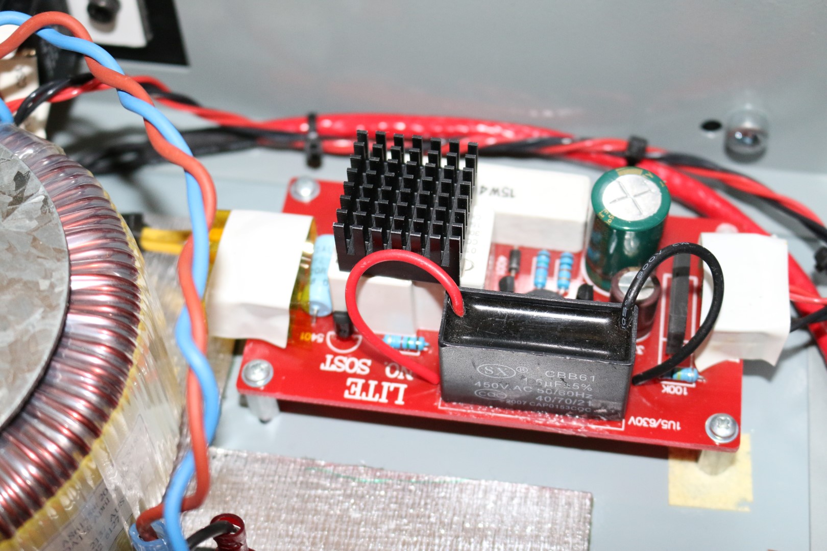

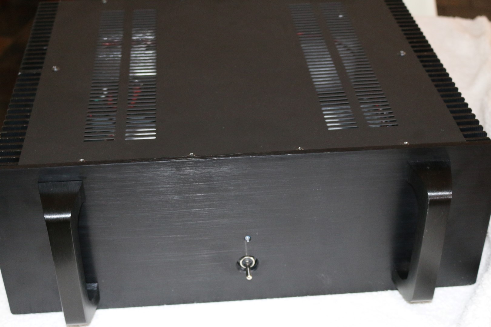

Before I start to show off the upgrade section its is best to start with the before photos that shows the F5 and then continue to the finish as an illustrated build of the F5 to F6 Upgrade progress
We have also decided to remove the soft start section and replace it with a resistor ( but keep it on hand just in case we want to install it again )

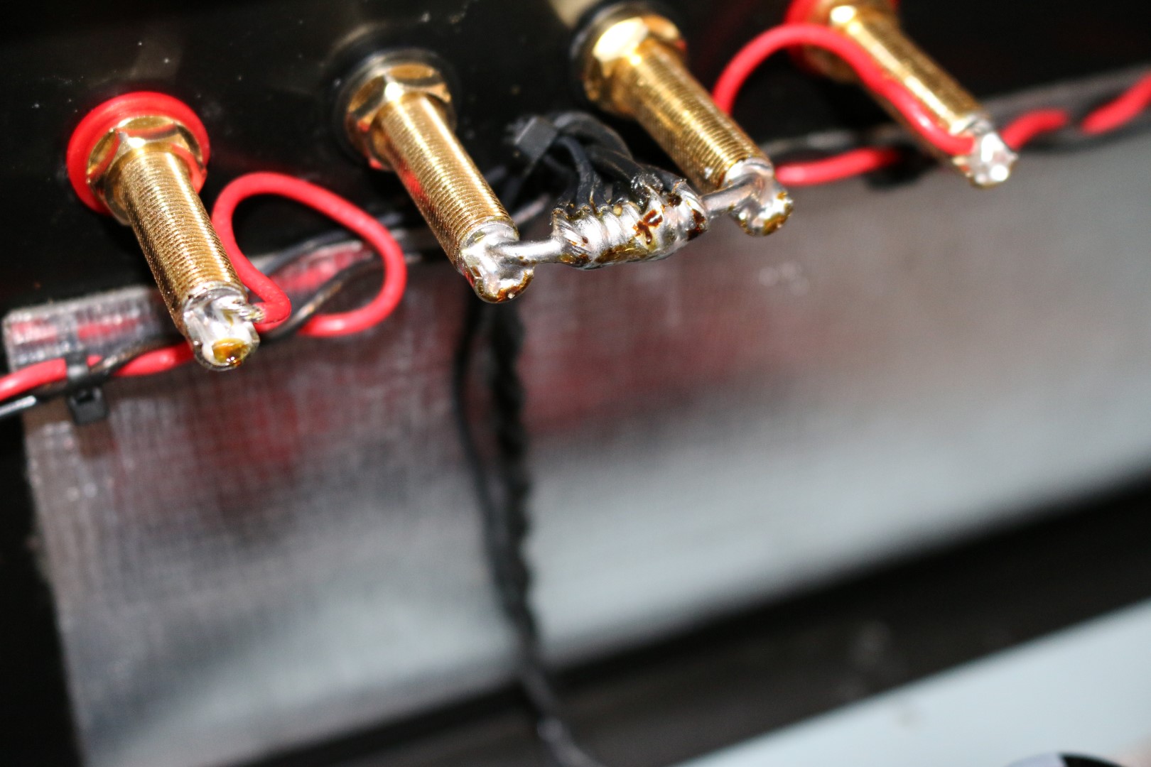

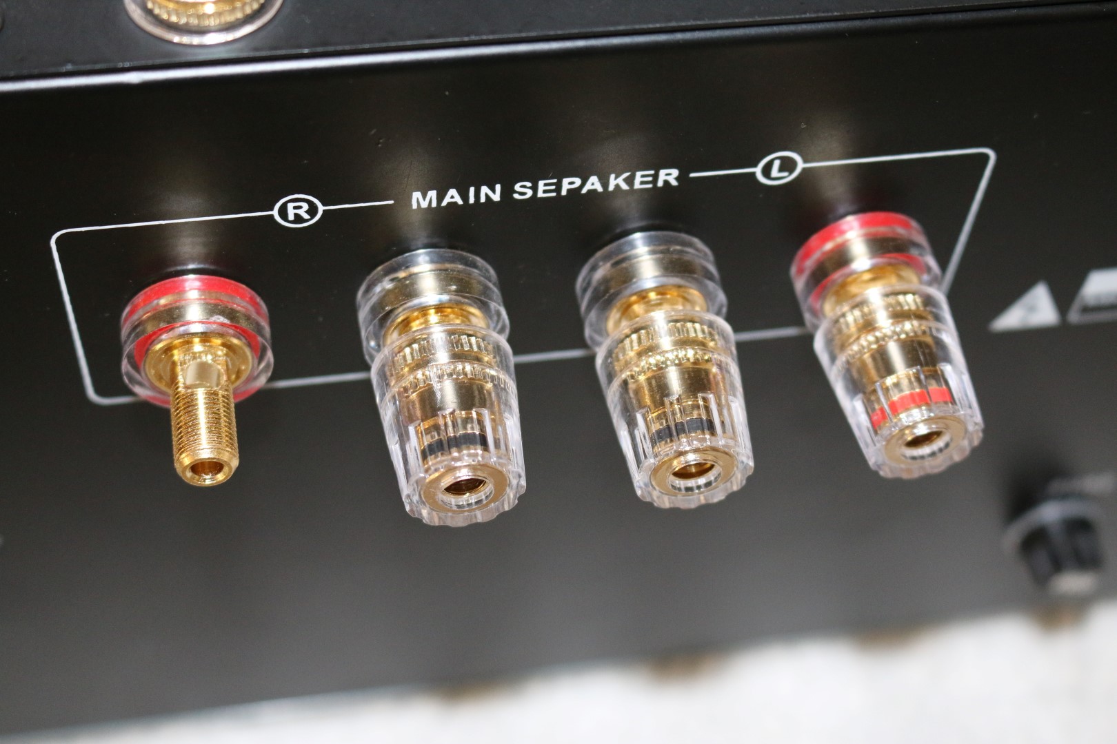

Please note my favorite speaker terminals that I have used on this Amp and others and also on my crossovers
they are available form Speakerbug - http://speakerbug.com.au/index.php?route=product/product&path=61&product_id=307
So all these photos are of the current F5 still intact

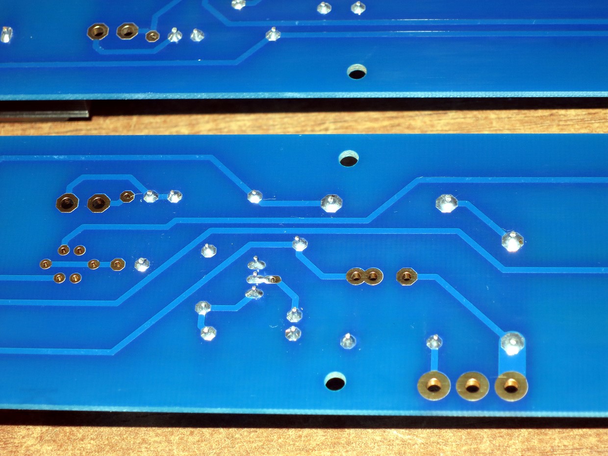

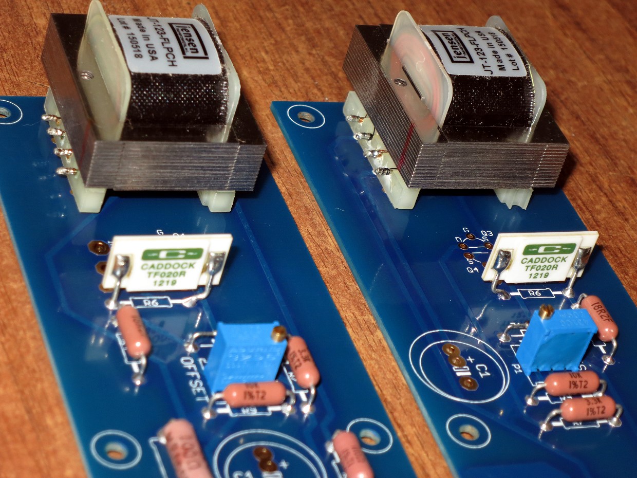

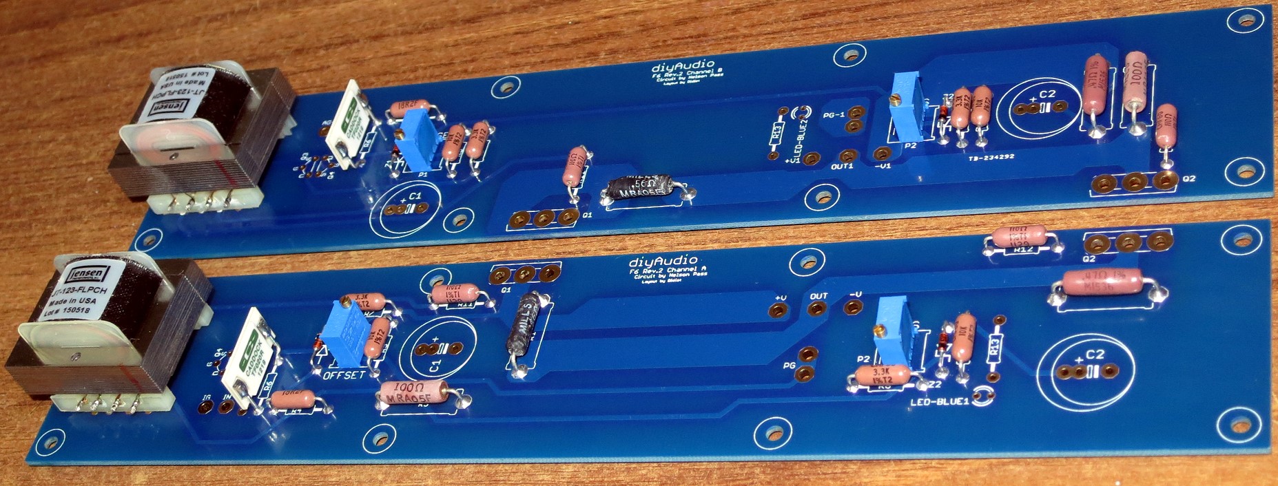

So the Upgrade has begun with populating the PCB's from the DIY shop
We have decided to get a start on the PCB boards while we wait for the remainder of the parts to arrive ( some things are just slow to arrive and your itching to start )
We haven't put the transistors in yet, as we want to check out some more
heat-sink options for another little mod we saw talk off.
Also note all components are raised 1.5mm above board level.

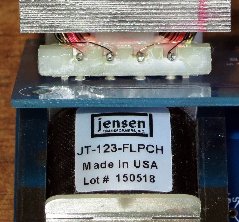

We take pride of good preparation and implementation so I have included an underside photo of the soldering ( my associates handiwork )
The photo of the side of the Jensen transformer is to show the solder wicking through the board hole properly.
Next update soon - It will be the rest of the components and fitting boards to heat sinks

I have one of those chassis with the "Sepaker" posts!
I know I know
You gotta love Chinglish - but hey its at the back and no one sees it unless a photo is posted
FR
Me too!
I don't understand this. Could you please explain the usage of a resistor instead of a soft start section?
Thanks!
