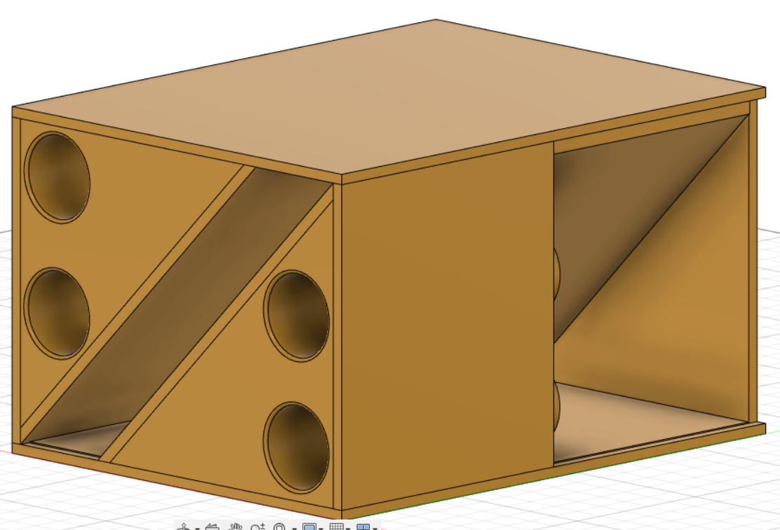

Unorthodox 2x18 slot loaded PA sub
HI Everyone
I'm Ale from Italy
My english is anything but perfect.
This is my second audio project and I know this is a strange way to do a sub.
I decided to build a sub for my coaxial synergy PA tops built in this thread with the help of many diyaudio guys
https://www.diyaudio.com/community/threads/2x12-and-1-4-coax-cd-synergy.373100/
My main limitation is dimension: 970x750x550mm ( my car trunk dimensions).
My goals are:
1- high spl that can match the tops (105-ish db/1m and about 3kw each)
2- not very low extension needed because I will use only for live rock music so from 45-50hz to 100HZ.
3-possibilty to transport and assemble secondary flare for bigger venues.
I absorbed some ppsl design principles reading a good part of the big ppsl enclosures thread here even if my design is push push.

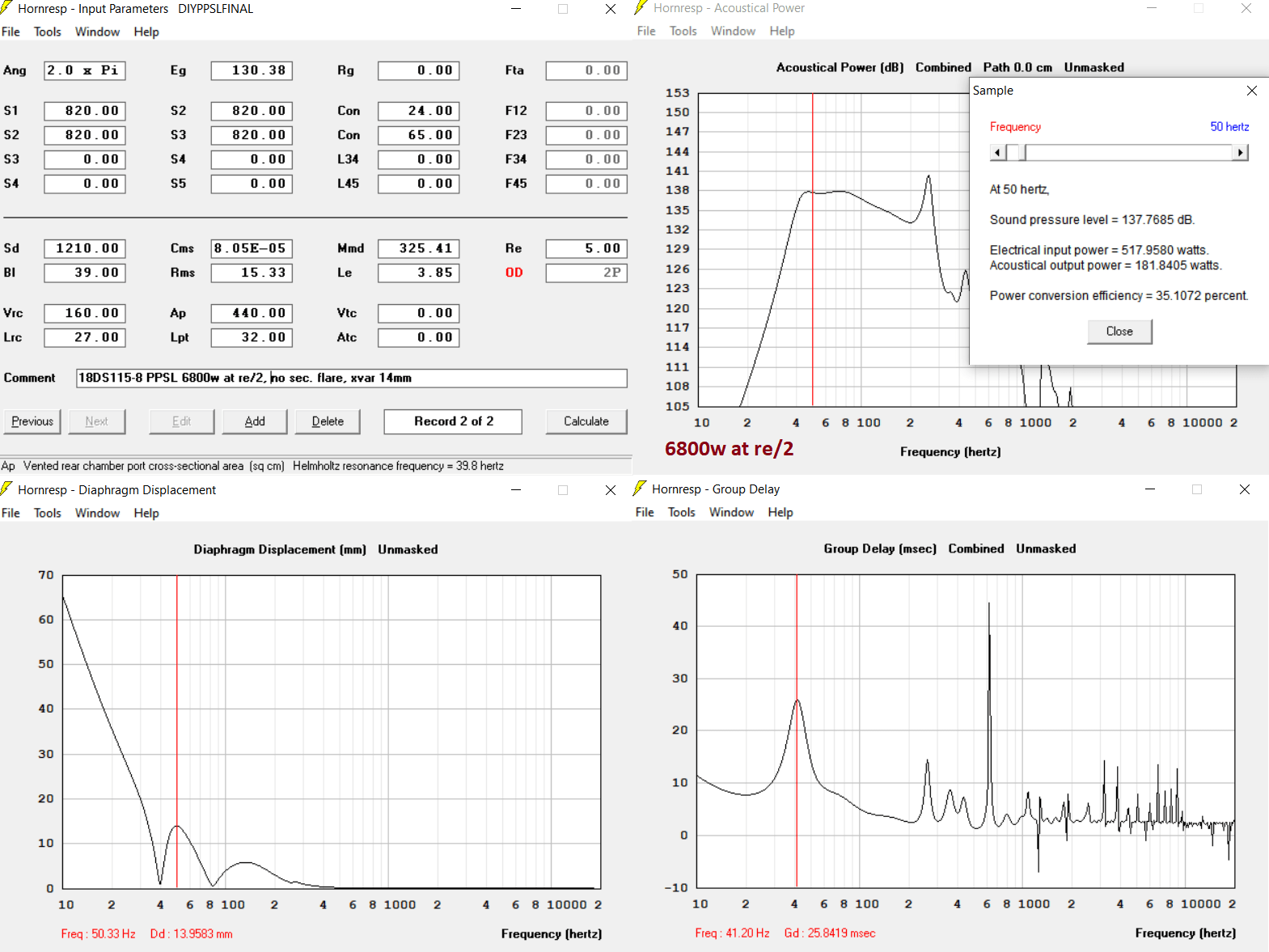

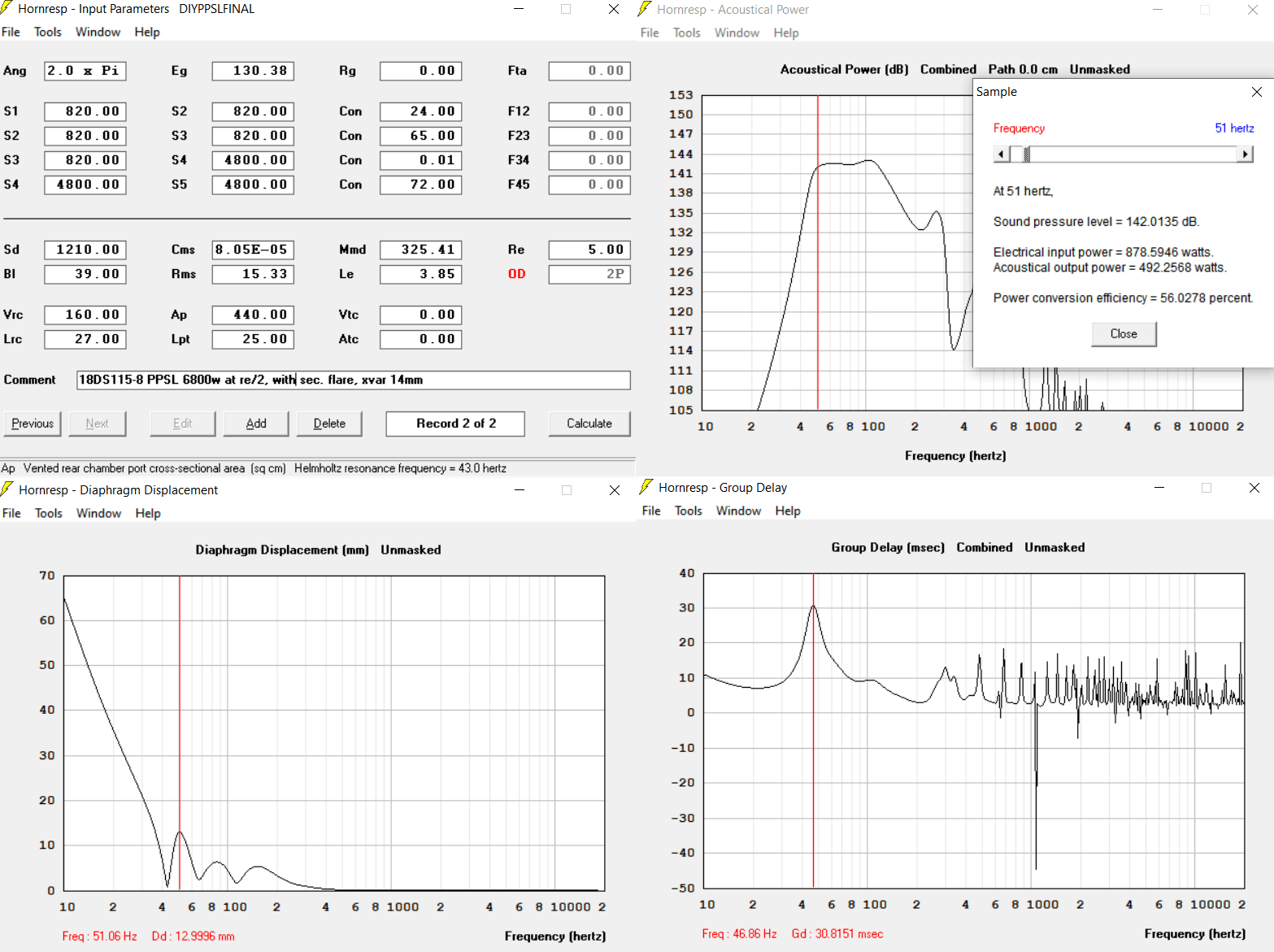

Usually the plenum depth need to be the smallest possible but with my data I can lower the highest peak down to 100hz using deeper plenum.
With 18ds115-8 I can use little box volume.
The driver chambers are separated.
The triangular BR ports are 440cm2 total (but I can modify easily) with 50m/s velocity at 6800w.

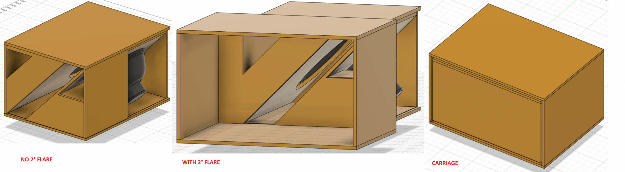

I want to create guides in the wood for the ports to shift it inside and outside and tune differently when I use 2 flare or not.
The secondary flare can accomodate the sub box for compact transportation.

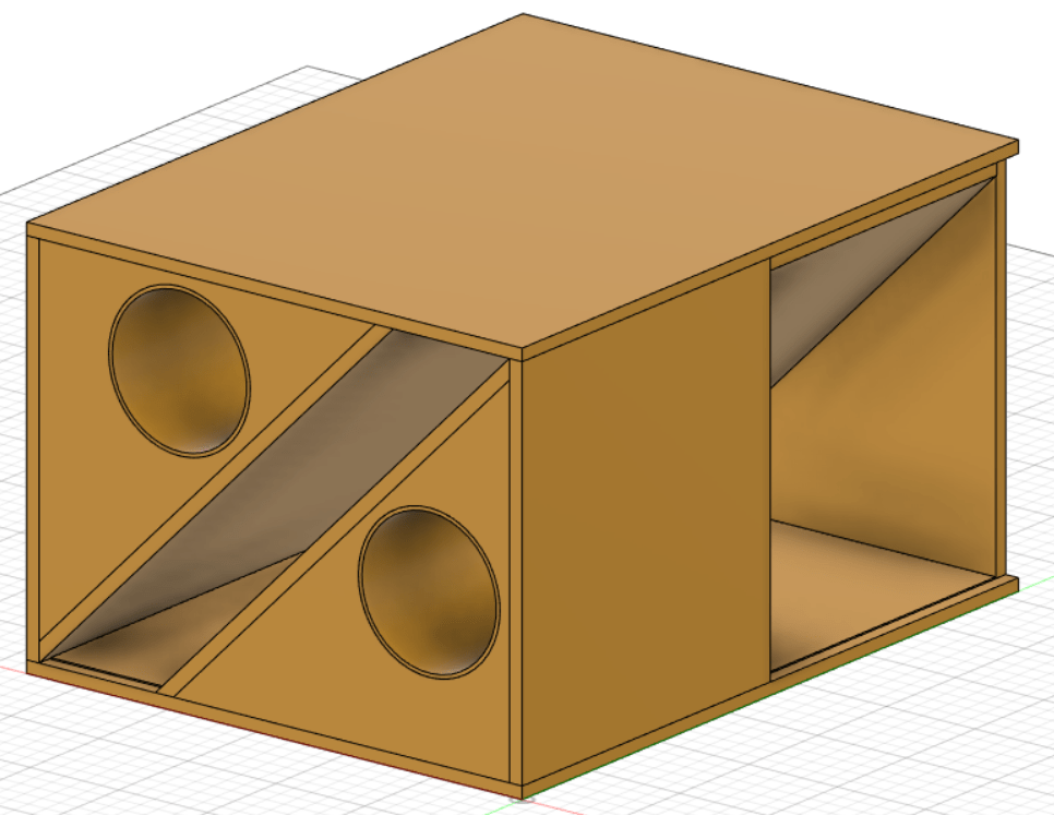

Now i would decide which position is better for left br port. (last picture).
Do you see any problems in this design??
I really appreciate you opinion and suggestions!!!!
Thank you very much
Ale

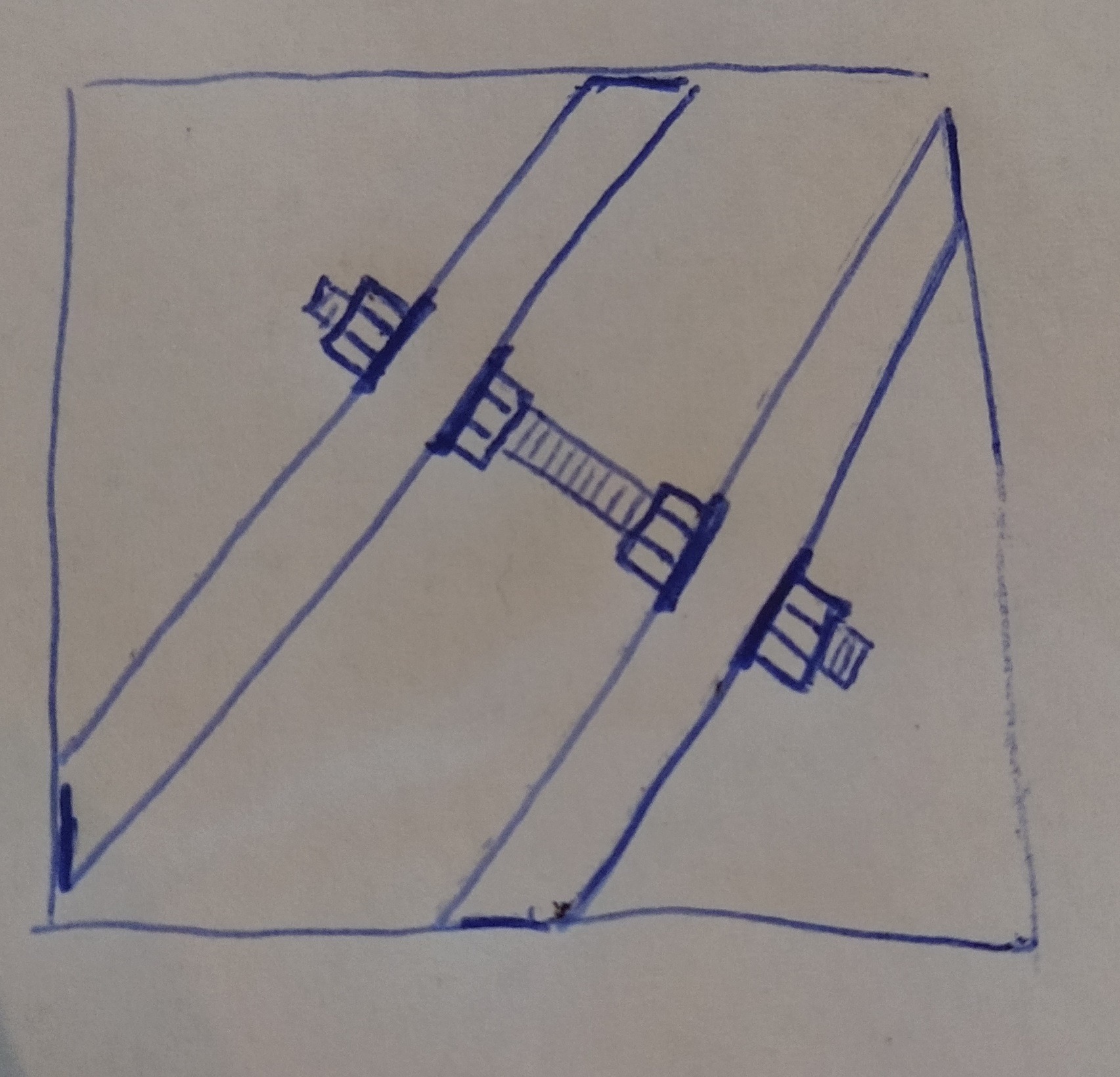

I would make the plenum very stiff. my ideas are:
1- wood wall in the middle of the plenum, but my fear is that can change the sound (or raise the modal resonance frequency of the diagonal dimension?)
and can be difficult to assemble with the glue.
2-(picture)some big 20-22mm threaded rods with self-locking nuts or with few drops of soft threadlocker, easier to assemble and phonotransparent.

HI
I almost finished building the cabinet
my last decision will be about shape and number of ports.
Initially I opted for 2 triangular br ports with one sliding wall for changing tuning but I tested and is very difficult to make is air-sealed.
So I would to use orange pvc pipes for house building so I can add a slice of pipe in front of the sub just inserting it in the joint of the internal pipe.
I want to decide between:
4 pipes of 140mm diam. each, lenght 49cm,615cm2 and 44m/s velocity at 6800w,
2 pipes of 200mm diam. each, lenght 46,628cm2 and 43m/2 velocity at 6800w (don't look at the position on the baffle)
Bigger than this would occupy too much internal volume, now is 160-180 liters.
4pipes like the photo will be better for air exchanging like Art said but Is worse for port eventual port chuffing???
Thank you very much
Ale
