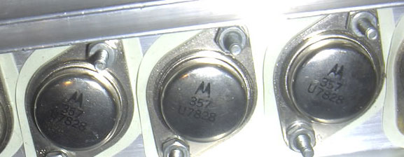

The "manufacture" should be Motorola, well, the logo is there.
After a search on google, the only webpage that I see was:
http://www.mailameal.com/dyn/d2002.66946.motorola.power.devices.aluminum.heatsink.cms
...but where is the information about this "guys"?? I don´t no...weird

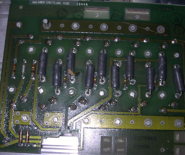

And the front.

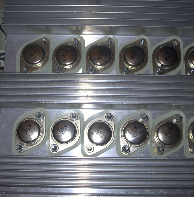

I'm thinking they were used in a high current capacity because of the low ohm resistors and thick traces but it could be an rf module?
I popped the top off one just to see the die size and connecting wires, as if this means anything, well maybe die size means something. The pic is are in the next post.
It sure looks like an audio output stage from something, especially if it has the low resistance ballast resistors.
Those are indeed Moto xstrs, adn that is a date code, but thbe other number is just a house number. It would have been the part number that whoever made the unit used. They order the parts stamped with theit number for use in house. If you contacted Moto witht the number and describe it as a TO3, they might tell you what it was under the skin, but that is proprietaru information. They would knly tell you if the OEM whose number it was was no longer in operation or if the copyrights had expired.
In other words if Marantz contracted Moto to make power xstrs for them, Moto could not reveal to you what they were.
The semi division of Moto is now called On Semiconductors. Moto sold the division off some time ago.
Current popular audio output stages use Moto MJ15xxx types. The MJ15024/15025 [air are rated for high voltages and high currents. 25 years ago we didn't have parts that big 2N3772 or something was a big deal. So those parts could be anywhere from 40V if they were in some car stereo system up to even 200v. And the current could be anything from not much to 30 amps.

Its power supply stuff, not audio.
I agree with Enzo, they are most likely either 2N3771, 2N3772, or 2N3773 types.
Considering the low, low value of the ballast resistor I would guess they are 2N3771 40V 30A
The bite taken out of the PC board suggests de-milled spares from military stock.
