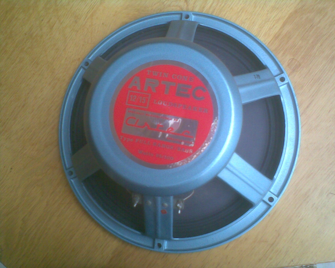

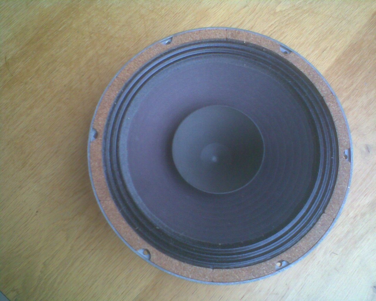

I have a pair of so-claimed full-range speakers for wich I would like to build a cabinet.
First idea was to re-create the original cabinet but since I cannot find anyone who has one and who is willing to disassemble it, I'm kind of stuck.
The original cabinet was a corner speaker cabinet wich was open at the back, but had some sort of waveguide (is that what it's called?) inside.
It also had an additional tweeter.
The speakers themselves are AFAIK made by goodman. (for a local company called Artec) Someone told me the magnets are Alnico.
They are twin-cone, 12/15" and rated at 25/100 Watts
Measured impedance is 8 ohm
They have the code "7/79" printed on, wich looks to me as the manufacturing date.
Now, where do I begin to create or find a new cabinet for these speakers?
I should probably begin with measuring the specifications, but wich ones do I need?
Thanks in advance, a speaker building noob.

Yes, you'll need a tweeter to match them.
Let's try to guess at some of the parameters.
I'm thinking efficiency will be high, (>90dB), because amplifiers at that time didn't have too much power. Following that, power handling will be fairly low, by today's standards. Think no more than 100W. I'd also expect resonance to be quite high: 60Hz+.
Usually, speakers of that era like large ported boxes. I know my dad's old PA drivers are of similar age, and, when modelled, they take a silly-large box.
HTH
Chris
PS - it'd make a lovely guitar speaker.

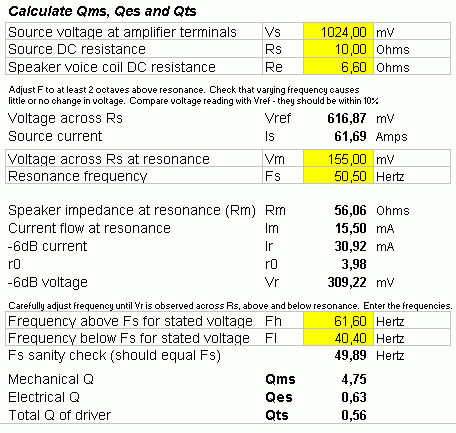

Here are the results from a quick measuring session.
(The speaker was hanging from a wire, between the legs of a chair, probably not an ideal situation)
I have no idea however what these Q values mean in real life.
According to a website, the Qts indicates that this speaker will work well in a sealed enclosure, correct?
