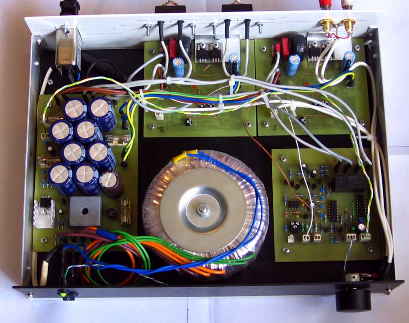

I didn't say, that I won't help, just only that I don't want to share my whole project (including PCB, detaliled schematics, etc....)
I have a reason for that: I'm in the middle of my graduation process, and I don't want anyone to have suspicions about me of stoling my whole project from this forum.
kikikaka
After taking this picture i had a smaller modification: decoupling protecting and signal ground.
Instead of shorting them together i put parallel R and antiparalel diodes to avoid hum and other noises came from earth-loop.
It's only 2*90W @ 4 Ohm @ about 1% THD. But it's far enough for my room...

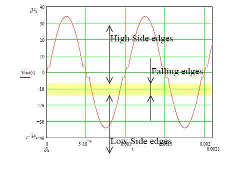

But the problem: about at 25% power some distorsion can be seen on a scope. It' like on the attached image (that is from irf's class-d tutorial), but only on the lower halfwave. And it's seems to be independent from frequency.
I can hardly imagine how dead-time causes a distorsion like that....
As Umut said, i purchased four IRF540 (st) instead of IRF540N (irf), but they have a text 'CHINA' on them. Someone wrote that these are good only for the dustbin. What's the problem with them?
(sorry for the picture, but in the original document text and arrows are in the wrong place too)
If you would like to damage your drivers, U can use "China" marked IRF540s. I agree with Luka, yes 540N has lower Rds on. But St's 540 has lower input capacitance and lower Qg. But, usually Rds on value has a reverse balance with Qg.
Hýýmm, China marked mosfets may be IRF510 or other lighter mosfet than 540. They could be celaning the original mark and then marking them as IRF540 or so. I tested them on my desings, they can only work for 5-10 seconds while original IRF540 can run for several hours without damage. I got china marked ones for 0.5$ while the original is on the same price and finnaly two fake 540 damaged my HIP4081's one channel.
