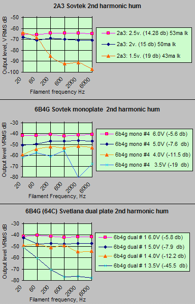

You are right - and Dmitry Nizhegorodov's work proves it.
His "study" doesn't "prove" anything. Yes. He posted some oscilloscope shots on a website and attached some graphics. But not anything I would consider documentation. It's not even clear what the oscilloscope shots show, what the vertical or horizontal scales are. Gimme a break.
His study shows that even when you null out the fundamental signal (with the usual pot) you get 2nd harmonics of the filament current at the output!
Of course you do. You create an artificial ground reference for the signal that couples capacitively into the tube. It's intuitively obvious that this will make the interference signal twice the frequency at half the amplitude. No surprises here.
Check out his measurements and see for yourself how clearly he proves that this is a modulation effect and not a thermal effect.
Again, he doesn't prove anything. He merely shows poorly documented results of some measurements.
Read what he says carefully, and it makes perfect sense. The scope shots show a residual 2nd harmonic of the filament voltage, and their phase relationship to the incoming filament supply waveform. The output levels are separately graphed, and presented in dBV, and plotted for various frequencies... I have attached the output graphs so you don't have to search for them.
What Dmitry presents us with is a study of output magnitude and phase of DHT amplifiers, when the filament is fed from a selection of frequencies from 20 to 6000Hz.
This is useful - to spell it out - to show that :
- there is a current-modulation effect on the output of DHTs;
- 2nd Harmonics are generated
- the effect is frequency independent.
- the phase relationship is stable and unchanged from the incoming signal.
The last two items are of great interest, since they prove that this is NOT a simple capacitive coupling effect.
Intuition proved wrong by the measurements shown!
If it were a cap-coupled signal, the effect would increase with frequency, since the load at the grid is a resistor (50 to 100K).
What's more, the 8pF or so of input capacitance of the 2A3 is over 800Mohm of reactance at 20Hz. The grid has a typically 100K pulldown. And yet -40 to -60dBV of 2nd harmonic was measured at the amplifier output.
I would be interested to see your calculation that shows how such a feeble coupling could give such a large output as the -40dB V measured. For normally configured 2A3 amplifiers you'd get less than -140dB!

How do you distinguish 2nd order harmonic noise from electrical induced emission from second order harmonic noise from thermal induced emission?
H. J. Van Der Bijl in The "Thermionic Vacuum Tube-Physics and Electronics" clearly explains the relationship between temperature and emissivity of at filament/heater. If the ac power through the the heater/filament does cause thermal changes it will be at a second harmonic of the line frequency and therefore indistinguishable from emissivity changes from second order harmonic emission from voltage e-field changes.
Furthermore, he explains the difference in emissivity from one end to the other of a heated filament/heater, and how a potential difference along the heater effects emissivity along the heater (his analysis was done on an AC signal iirc, but equally applies to DC).
Finally, given that there is a correlation between switcher noise on the filament and noise at the anode, what is the relationship between the 8mV 500KHz-800KHz switcher noise and audible sub-harmonics?
Are there any?
This question is addressed by Dmitry's tests: the thermal effects will be subject to a thermal time-constant, so increasing the frequency should decrease the effect. The results of his test were that the output was constant, regardless of frequency - which suggests zero thermal effect, 100% electrical modulation.
All I see on that page is the blanket statement that some residual of the heater waveform will be present somewhere in the amplifier. I'm not contesting that. In fact I'm supporting that.
You make the assumption that what he is measuring is due to this "current mixing effect" that you have thought up. Based on my understanding of how vacuum tubes work I just don't see that argument as being rooted in anything that goes on physically in the tube.
Yes, the cathode current provides electrons for the filament coating to release. The filament coating releases electrons because it's heated by the filament current (DC or AC). But the process by which these electrons are released to the space-charge cloud surrounding the cathode is completely random. It's a stochastic process. To argue that you can distinguish one electron from another and follow this one electron as it travels happily from the heater wire to the anode is absurd and not supported by science.
Why do you think the current mixing occurs in the space-charge? You are imagining it if you think anyone claims that.
Filament current and Anode-cathode current mixing occurs in the substrate wire of the filament, which conforms to Ohms law, just like any other piece of wire.
I have explained it numerous times already, so any interested readers can look further up the thread for the workings of it.
