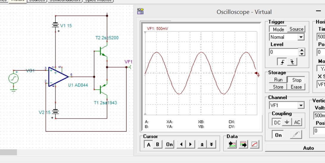

The result is obtained by TI Tina simulator the models are from Toshiba for transistors and from AMD for ad844 . I fully agree , the distortion doesn't image the sound quality. This why I am concerned only with class A amps and nowadays , powered by FSS, Floating Single Supply . The bias circuit has always been the weak point of class B amps in terms of reliability. It is the nightmare for DIYs, if all will explode on first start up.

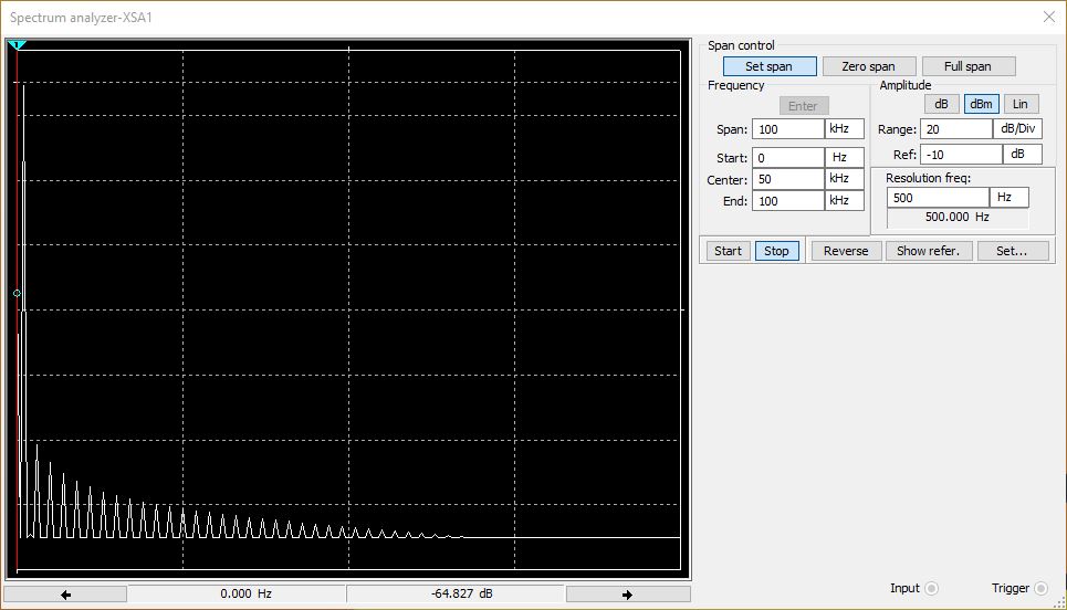

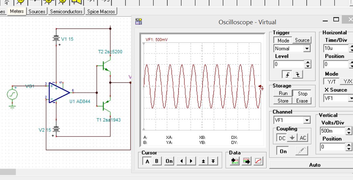

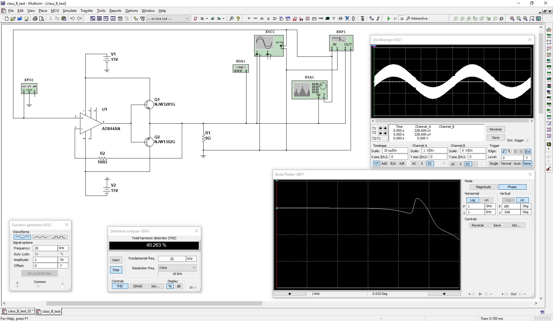

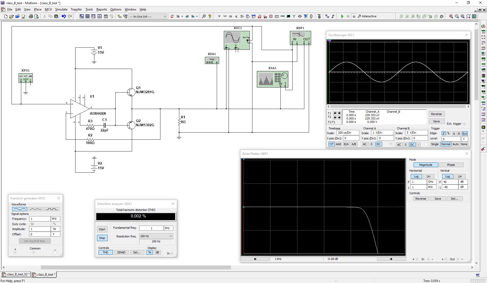

A quick simulation (I use Multisim).
First of all, the circuit is unstable, showing an amplitude peak (and corresponding phase artifact at around 30MHz), mostly caused by the output pair's input capacitance. See 1 KHz and 20KHz simulations at the pictures 1 and 2. Note the crossover artifacts within the oscillation at 20KHz scope picture.

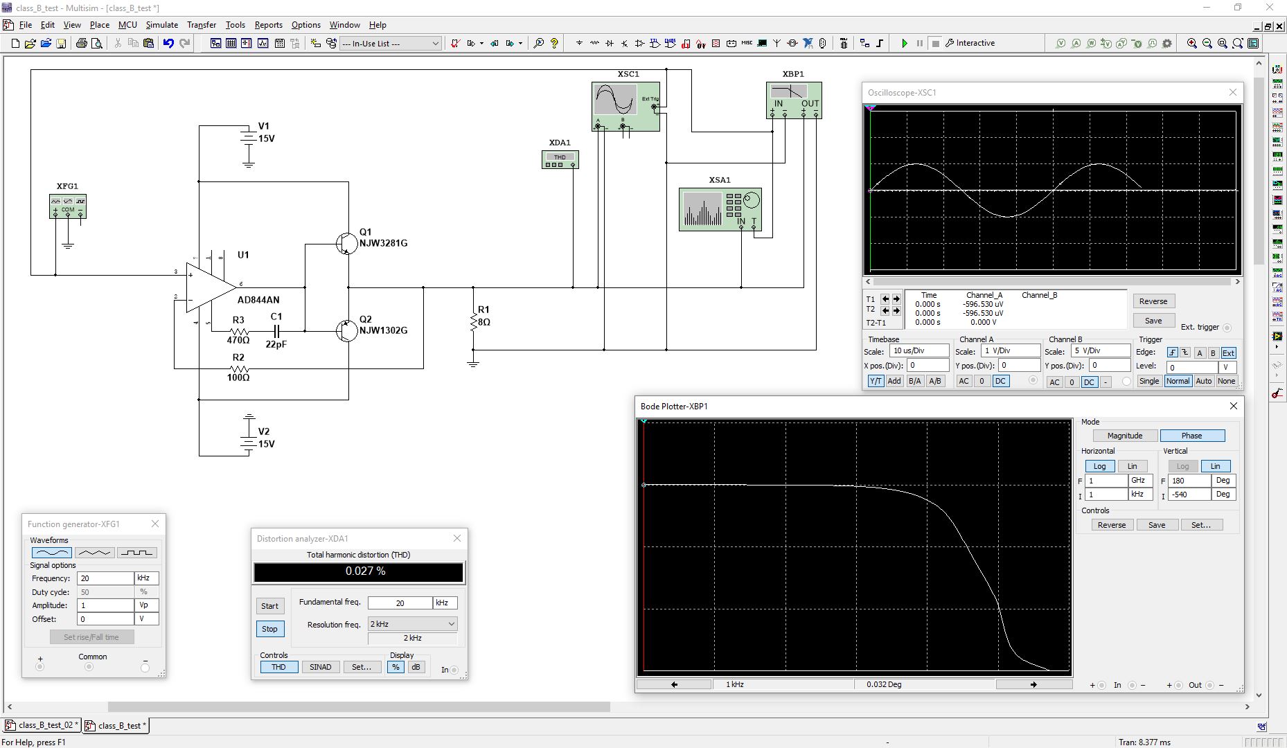

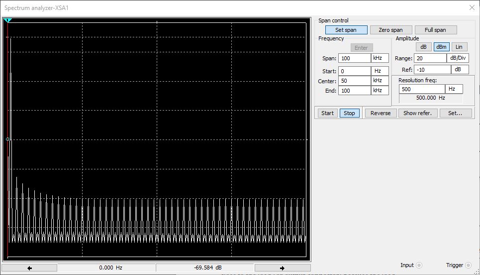

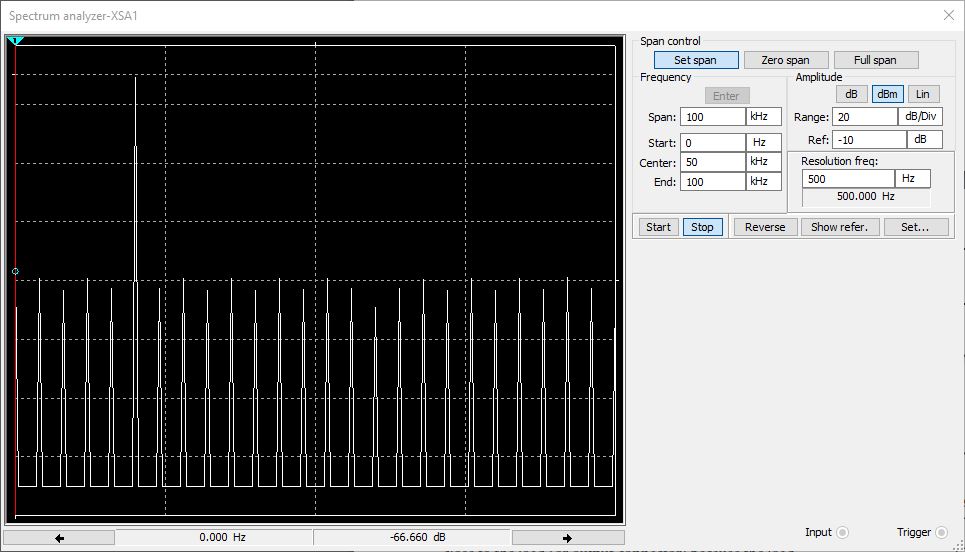

OK, not a big problem - we compensate with feed-forward RC according to AD844 datasheet - now amplitude and phase responses look good (pictures 3 and 5) and the system is unconditionally stable. But oscillation is not the biggest problem.

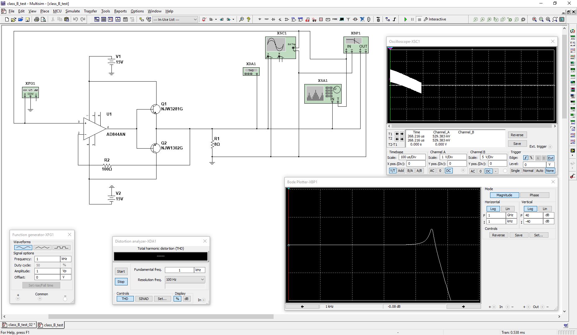

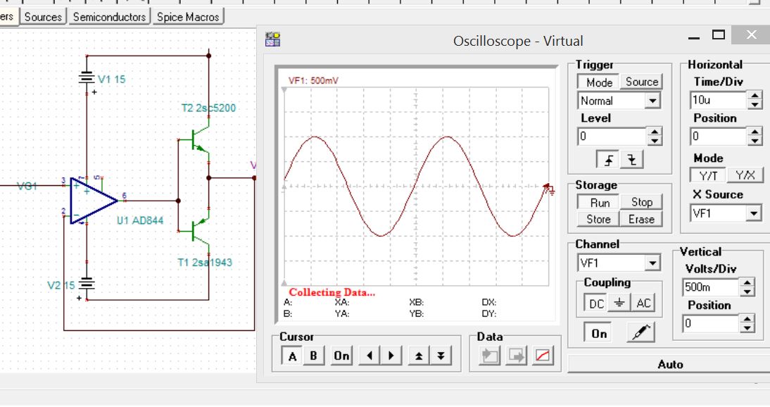

Pictures 4 and 6 show the spectrums at 1KHz and 20KHz. They don't look good - long "tails" of high-order components (pretty much as expected).
The simulations shown are performed at 1Vp. Level of distortion strongly depends on the signal level. At 100mV distortion will increase 10-20 times (influence of crossover distortion increases at the lower signal levels).
I agree with Jan - a couple of Schottky diodes between the bases will improve the situation, but the crossover distortion is not the only problem here - a proper driver stage is required for dealing with a high input capacitance of the output transistors, reducing distortion at the higher end of the audio frequency range.

Nice Valery. Yes it was clear from the earlier posted schematic that it hadn't really be tested in any way.
For compensation I probably would have used a small 'base stopper' of 10 or 20 ohms, to isolate the base caps from the '844 output. But your way works fine.
Using darlingtons for the output devices would also help, after all at 15 supply and 8 ohms, output currents are manageable.
And some bias of course. Maybe you can try that as a quick see in your sim?
That would all make it a nice little amp to have around.
Edit: yes, the nature of the distortion really makes it a b*tch at low levels where we do most of our listening...

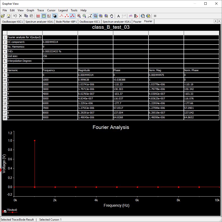

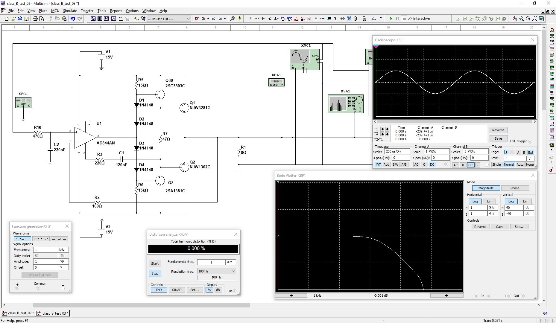

Here we go :)
A slightly improved version of the same amplifier.
Simple driver stage, two pairs of diodes, setting the OPS bias close to the edge of class B (idle current of the output stage is around 0.5mA).
Much better performance. 2-nd picture shows the details of FFT, measuring THD (1KHz) = 0.00033%. THD (20KHz) = 0.003% (not shown here), which is still very good.
Look at the spectrum! Descending right side is what we were looking for :)
It also leads to much lower intermodulation, which is even more important for the better sound.
In fact, at this power level, some TO-220 transistors at the output would be enough. MJL15032/15033 is an example.

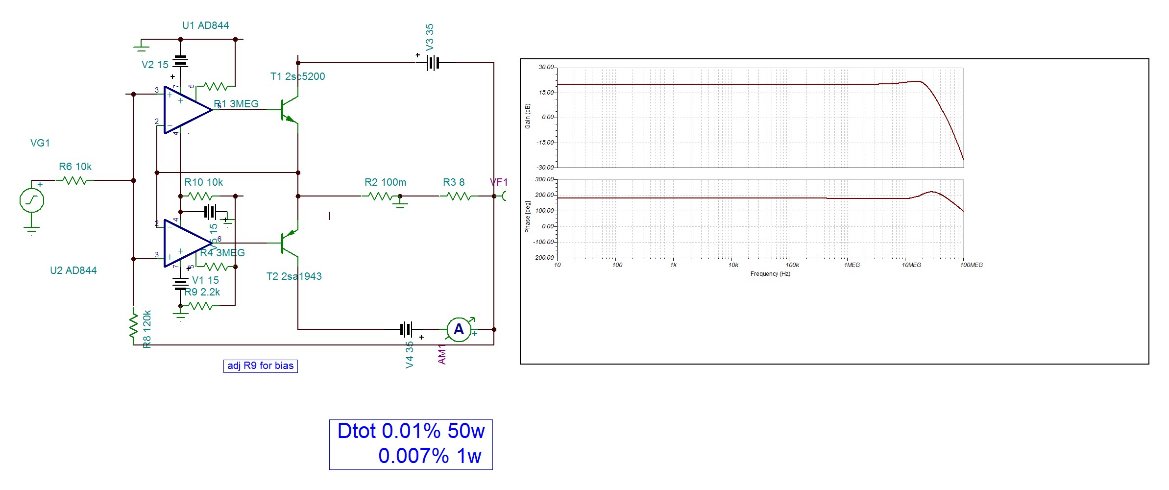

sorry my circuit is wrong . Indeed above 500hz oscillations occurs.
Yes, I see now - the power supplies are connected the wrong way.
But no problem - the compensation feed-forward RC makes the trick. Thanks to the access to internal buffer's input, provided by AD engineers ;)
If you can build the bode plot in your simulation - you will see the amplitude / phase response without compensation as well as having it in place.
