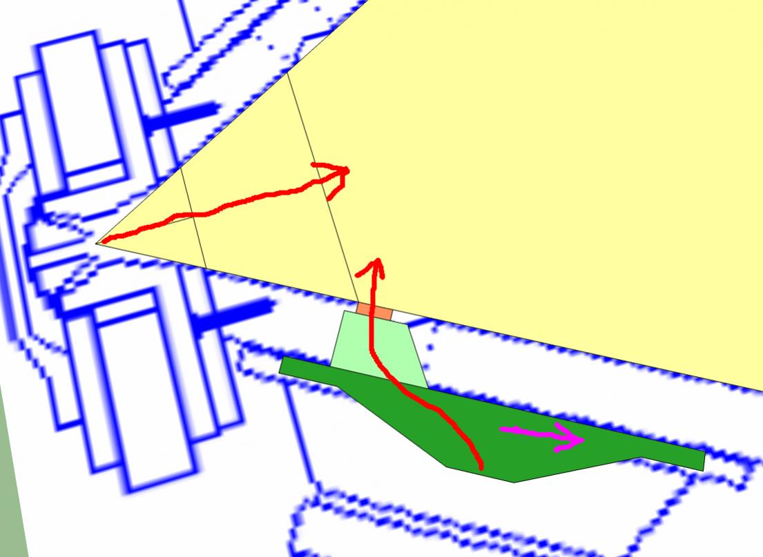

I drilled the hole first (3/8" inch) then used a dremel for the rest. I started by shaping the frustum (light green) with a sanding band . Then I used a 5/8" diameter grinding stone to carefully create an accurate port length [currently 3mm (orange)] by grinding a flat edge at the bottom of the frustum (light green). I then continued with the sanding band until the angled edges of the frustum matched the flat end where it meets the port.

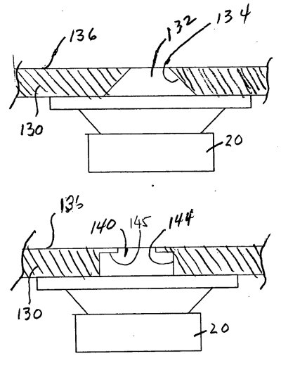

First I determined the desired port width and length (0.95mm wide by 3mm deep). Since the port length is shorter than the depth of my material, I need to "cut away" this depth until I'm left with my desired port. Mr. Danley docuements two ways to achieve this in his patent (see figure). I chose not to terminate the frustum directly to the port because I wanted to create as accurate a port length as possible so it would be easily repeatable. I assume terminating the frustum to the port would cut down on turbulence, but it would also require calculating some sort port end correction for the transitional area. I just didn't want to deal with that.
One added benefit to how I shaped the port entry (which I first saw in others designs) is it allowed the driver to be moved further away from the port (purple arrow) without creating a choke point as the surround of the speaker moves closer to covering the port entry. This creates a longer physical delay as the sound travels from the acoustic center of the cone to the horn entry (red arrows). This delay helps compensate for the distance between the compression driver and the mid range ports.

One correction, my port width is 9.5mm wide, not 0.95mm.
Mine seem to be holding up just fine. Doing the ports as in the first figure (angled straight to the port opening) would be preferable for strength, but shaping them by hand (as is my case) would make it difficult to do consistently.
On some of Danley's synergy models it appears that he uses a metal plate to create the horn walls. I haven't seen pictures far enough into the horn to know if the mids are mounted to the plate, but it looks like the LF drivers are mounted directly to it. This would allow a very strong and short port configuration.
