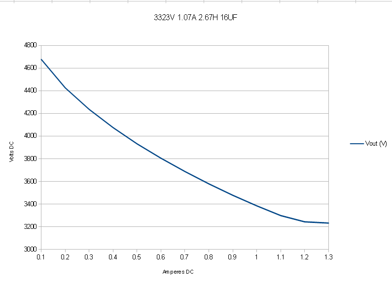

The three 400mA inductors were parallelled for the simulation because the plate current on a pair of 4-1000's at 3000-4000V and making 2KW in AB2 is about 1.1A (one can see the grounded grid spec or the modulator spec). The QB5/750's have no data for 3KV, but at 4KV have to be driven in AB2 to make the power rating. The QB5 is a smaller tube, but larger than the 3-500Z. It's probably impossible to find in cheap supply too.
The only >1 Amp single inductors I have (9H 1.5A) are reserved for a 3CX3000A RF amp. - Except for a 3H 3.5A one from a 5KW RCA transmitter, which is too big for this project (anyone need that size? U pick up in Texas.).
There is no more information about voltages or parts values at this time. I'm working on that. I can confirm the HV filter cap was 2uF (2M=2 million picofarads). Don't know about the choke.
Keep in mind the power supply stuff I posted is just a rough working point, for investigating the types of components needed. This is because there s a stack of 'good-sized plate iron' here. Since it has to be single phase, the values in the original will have little in common with the new ones. The filter size will be mugh larger physically, but I may be able to use electrolytics or to buy modern oil filled caps and a "dahl" inductor if space is tight. The voltages are what have to be close. I can only speculate the HV is 3-4KV. None of the original parts are available although someone says they have the LV transformer removed from this amp. Amazing.
I don't like that chart much. The regulation is poorer than I am used to. I'll have to try another idea. I'm cheap so buying a 1A inductor that will operate at 3-4KV is going to hurt.
I'm willing also to run at the lower of voltages on the old transformer, as a cautionary measure. The OPT inductance and turns ratio has not been measured yet. The primary DCR is 250 Ohms in entirety. That's not very helpful but every thing counts.

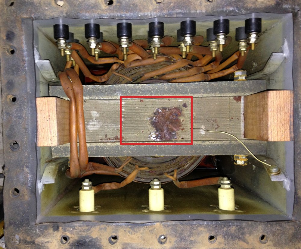

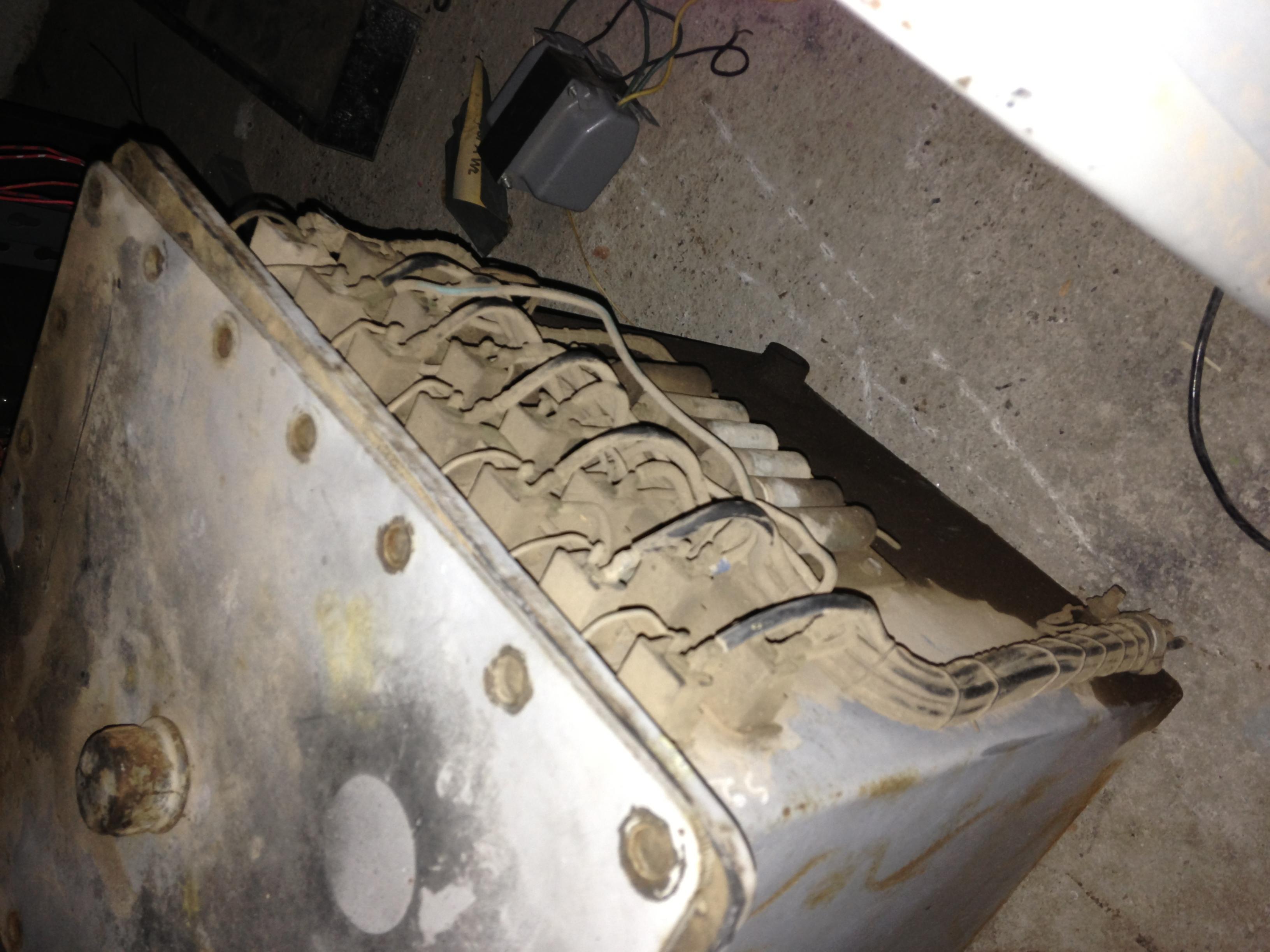

The OT appears to have simple secondary-primary interleaving, but the photo doesn't clearly show where the centre B+ CT bushing connects to the winding?
I'll check with a colleague about the oil type we use in HV PTs.

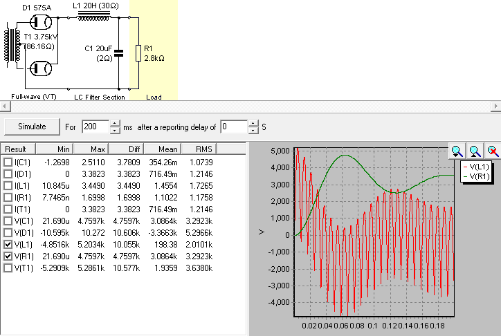

The steady state operation in simulations using a 20H choke input circuit, or the example one, reveals the high voltage impressed across the inductance every half cycle. For this reason and because of having made practical measurements in this sort of high voltage power supply, I disagree and will explain so that it is clear.
Such repetitive voltages are common across chokes in real HV supplies. The repetitive voltages across the windings are scaled with the voltage to be filtered. I have not noticed pedantic assertions regarding the choke's ability to withstand a high voltage across the inductance, so the adjective can not be applied. Regardless of where it was directed, I'd rather ignore it now because it is not important to the fact that surges affect differently the steady state waveform across the choke and the instant voltage between any part of the winding and case/ground.
The simulation below is much like the measured activity in a real 3KV 800mA supply in weekly use here. It shows that upon turn-on, there is a surge on the (nominal 3200V) B+ line and indeed the average DC level on the choke, but the repetitive half-cycle voltage waveform across the inductance is fairly constant at about 5KV. That voltage is necessary for the filtering operation. A spark gap across the winding is one practical protection method against intra-winding arcs at these voltages.
The only reason to place the choke in a ground return lead is to protect its winding-to-case rating from surges.
Some experimenters keep the choke in the + lead and mount it to a 1" piece of wood or by ceramic insulators. This is most common with old or abused, but still working, parts that would be costly to have rebuilt or to buy.
It becomes a moot point if the choke is prevented from shorting to ground but can't stand the steady waveform across its inductance.

We used Shell's Diala BX oil for LV/MV transformers in the past.

DCR needs to be fairly low to constrain temperature of choke. A choke would need to be physically quite large to sustain say 1A DC with say a DCR=200.
Any dI/dt higher than what is experienced in a sine wave will introduce an increased voltage across the choke. Diode conduction start and stop can be a problem, which means the first choke in a multi-section filter can have a spikier working voltage than latter chokes. Turning off the mains at the peak of the voltage waveform can also be a problem, as will step load changes.
C or RC snubbers or MOVs across the PT secondary windings and choke, and MOV across the primary winding, are typically used in lower voltage applications to suppress such transients.
