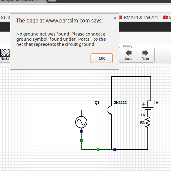

Understanding Transistor amplifier with an online simulation
Circuit diagram with SPICE
Switched to partsim Online Circuit Simulator with SPICE.
The circuit shows a NPN transistor and a power supply of 1 Volt DC. The transistor is connected in series with the power supply and 2 1K resistors.
The transistor blocks all DC voltage across its emitter to the collector. If a small current is supplied to the base of the transistor, current will flow across the terminals.
If an AC current is supplied to the base, this will result in a fluctuating current across the transistor terminals. Hopefully this will be of the same pattern of the input signal.
Resistor R2 could be a speaker of impedance 8 Ohms for example.
The input signal goes to the base of the transistor and the lower side of the resistor R1.
First question - won't the current from the battery flow into the input terminals since they are at a lower voltage than the power supply current?
Just thinking out aloud.
The transistor blocks current flow as drawn.
To force current into the base, you first have to overcome the base-emitter volt drop of around 0.6 volts. No current will flow in the base until that threshold is reached. Once it is, current flow increases dramatically and non linearly.
Your question... no. Current can not flow from the battery to the input because the base-collector junction blocks it.
So if R2 were a speaker, then you would only hear the input signal as it passes through that 0.6 threshold. In other words, silence at low volume and huge distortion on the louder bits.

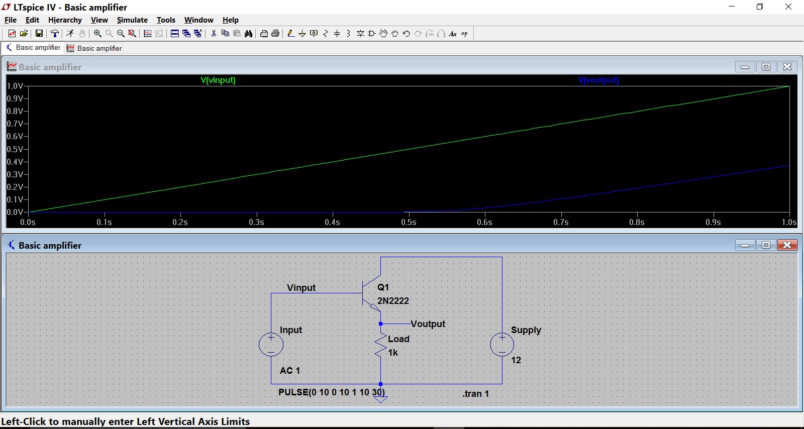

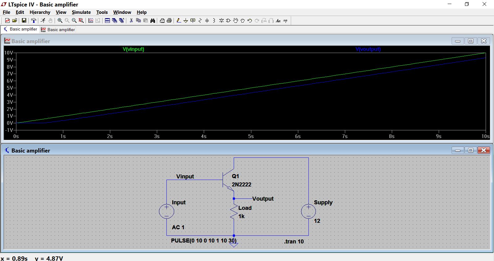

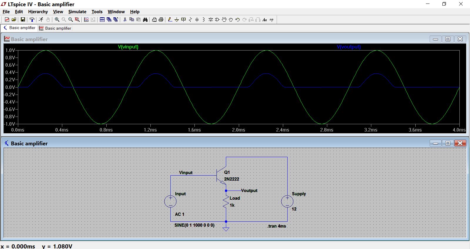

Yes, you always need a ground as a point of reference in a simulation.
Lets take your basic one transistor amplifier as shown here and lets look what happens when we apply a 1 volt peak to peak input signal.
Look how the output does nothing until Vin reaches this magic 0.6 volt threshold. Until then the transistor is OFF. As Vin rises, Vout follows but it is 0.6 volts lower than Vin. This 0.6 volts is the base-emitter forward volt drop and is around this value for all silicon transistors.
The negative part of the input signal has no effect, it simply biases the transistor off.
The second and third picture shows a ramp waveform applied to the base. Look how the emitter follows 0.6 volts lower and how nothing happens until that 0.6 volt point is reached. The third is showing just the first part to make it easier to see.

I understand the diagrams, but the question is what is the other output terminal, and how does the voltage after the resister connected to the collector vary with the input signal? If the voltage is higher after the resistor connected to the collecter than at the input terminal, current will flow to the input terminal.
I'm not quite following your question 🙂
You've no resistor connected to the collector in your (and my) diagram. The positive supply goes to the collector as drawn. The emitter is the one with the resistor.
The configuration as drawn is called a 'common collector' or more usually an 'emitter follower'. The voltage gain is always a little bit less than one (unity) but there can be tremendous current gain available. In other words a tiny current flowing in the base-emitter junction can control a large current flowing in the collector-emitter path. The output is always taken from the emitter in this configuration.
Does that help.

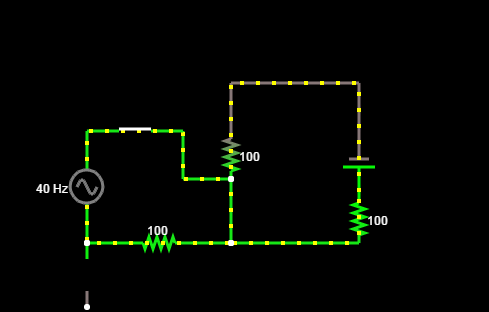

I have been going through some of the basic circuits here:
Circuit Simulator Applet
I understand how the transistor works. It can be compared to a dimmer switch for a light bulb circuit where the dimmer switch is operated by another smaller current, an electric motor or servo for example, except the operation of the transistor is not mechanical.
What I do no understand is the left hand side of the circuit, how two current sources, one DC and the other affect each other.
A simple circuit will hopefully clear this up : here goes:
This is the text file for the circuit: a simple DC circuit with two resistances.

Adding a second circuit on the left, which is a AC source with a 500 mA peak.

This is the part I do not understand: The ac current and DC current keep on circulating without any change, as far as I can tell. Is this the way it works in reality? I would think some cancellation occurs.
Of course I could test it practically by connecting a DC voltage across a speaker when it is working. MIght burn out something unless I put a resister somewhere in the input.

Left hand circuit shows two series resistors across a DC voltage. The right hand diagram shows the same, but with a separate AC source simply using one of the conductors of the other circuit for its own connectivity. There is no ground, you have two independent voltage sources operating with no interaction. The AC source feeds into the left hand 100 ohm. The DC source is the same as in the left diagram.
Is it supposed to be like that ? That's how its drawn anyway.
Remember the part about voltage in a circuit being like pressure in water, or air?
Let's use that analogy. DC is like a constant, static pressure. For instance, the air around you has a steady pressure of one atmosphere.
AC air pressure exists too - we call it sound when it's between 20 Hz and 20,000 Hz.
Suppose you turn on your TV or click over to YouTube now, and turn on some music. The air around your head now has a DC component, AND an AC component. The DC component lets you breathe and stay alive; the AC component is the music you're hearing. At any one instant, the air pressure at your ears is the sum of the DC and AC pressures.
Now, there's nothing startling or hard to understand about that, is there? You've been listening to sounds in the earth's atmosphere all your life.
In exactly the same way, you can have a DC voltage and an AC voltage added together in a circuit. Nothing startling or hard to understand about that either, really. It's just unfamiliar.
I'll take the analogy a tiny bit further. You wouldn't survive long if you were listening to only AC air pressure: you need that DC pressure to be able to breathe!
Well, transistors "need" DC to be able to function, too, just like you do. Once they're happy and have the DC they need (it's called biasing), then they can handle a little AC added on top.
Analogies can only go so far, of course. But does that help make sense of your question about AC and DC co-existing in the same circuit?
