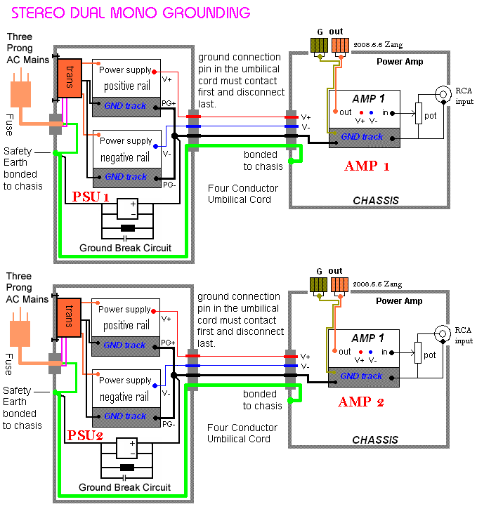

Hello there....
Im currently building dual mono lm1875 ( two transformers with two rectifier, transformer is dual secondaries ) and 1 stereo pre amp ( 1 transformer CT )
And im using two outputs ( 4pc binding post and headphone out through one rotary switch ) and im using 4 inputs ( 4 pair rca through 1 rotary switch ) and im using 1 chassis for all of that
can i use stargrounding at post #66 as well ??? Thank you

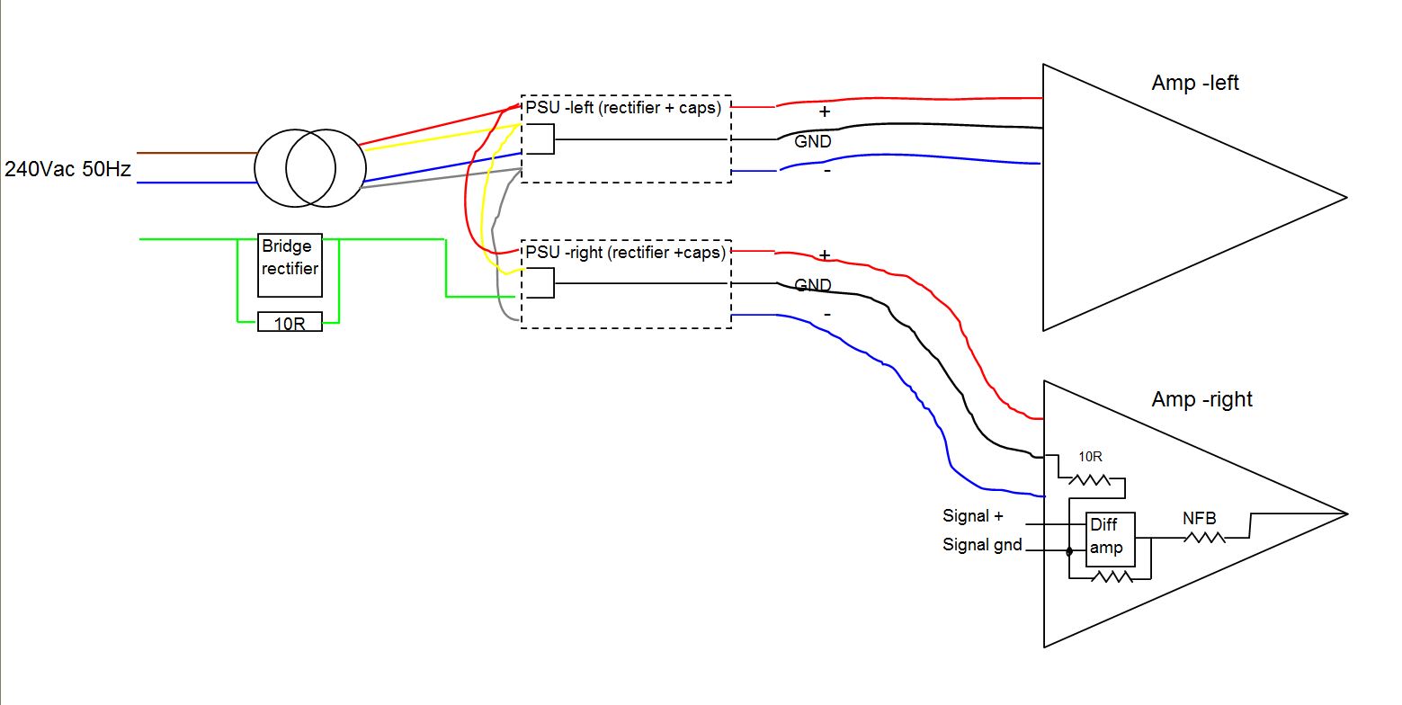

Ground loop in stereo amp with 1 transfo and dual PSU
Hi there,
I have gone quickly through this thread and tried some proposals, but sofar no succes.

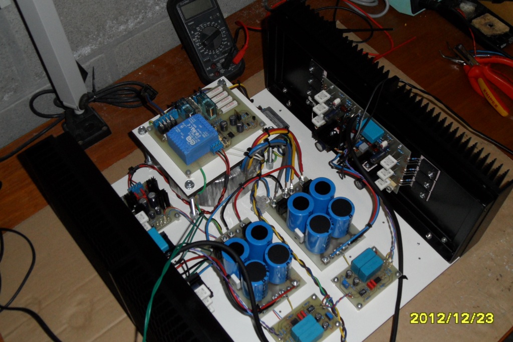

My situation: I'm having two amplifiers with each there own rectifier and cap's, but only one heavy toroidal transfo. Each amp is running perfect and is death quit. But when I'm plugging in both RCA cables comming from a source, there's is slight hum comming out on both speakers. This seems like a ground loop to me, however, I don't see where. The signal ground and power ground are connected on the amplifier pcb by a 10R resistor.
Please have a look at the wiring sheme below. What should I do to get rid of the hum?
Greetz

That's a tough one. Make yourself aware that the signal grounds for both amps will be connected at the source. Then each of them goes through a separate 10 Ohm resistor to its PSU. On the transformer side you connect the grounds together again. From there you go through another 10 Ohm resistor to the chassis. Is the chassis connected to PE and through that to the source ground, too?
Start by using only one PSU for both amps. Produce a star ground between PSU and amps, and connect the chassis there. Replace the 10 Ohm resistors between signal and power ground with jumpers, if possible. Then add the components back in one by one and check each time.

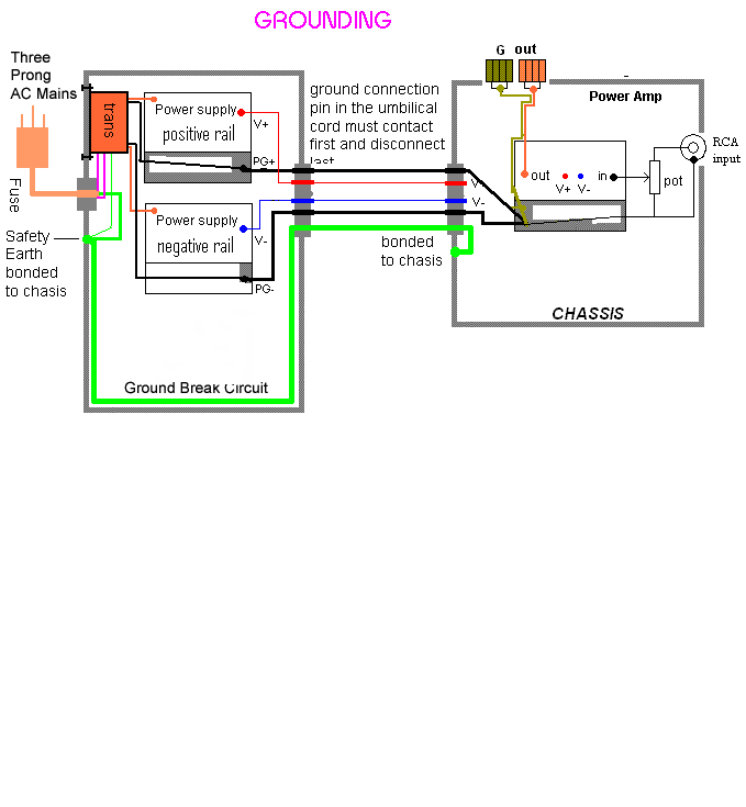

Sorry for drudging this topic up again, but I spent all day reading this thread as I am building a mono block with separate PSU
Earlier in this thread the follow was presented.
No one seemed to dispute this and it looks correct to me.
However, the following :
Hi 454,
You will need a minimum of four wires in the cable: safety ground, + voltage, - voltage and power common (0 volts) no matter if you have an SLB or not, of if you have an SLB, where it goes.
Good grounding practice would have five wires if the SLB were in the power supply chassis, and four wires if the SLB were in the amplifier chassis.
If you want to use an SLB, you can not double duty the power common and safety ground because these are what you want to isolate with the SLB. Also, as I said before, it is not a good idea to double duty any ground wiring.
If the secondary of the power transformer is shorted, that short will be reflected onto the primary and the main fuse will blow. There is no need for an additional fuse to protect the transformer.
Dave
Which one is correct? Would a 5th wire be needed to connect the end of the safety ground back to the SLB from amp to PSU in the configuration shown above?
Also, if the amp and PSU were stacked and the cases were touching would this cause a ground loop for earth ground?

...............As you have done the safty chassis heart ground , the only important things! you can float your signal/psu ground....(ie disconnect Psu1/2 from your green line) .............
No, you cannot.
All exposed conductive parts must be connected to Safety Earth.
That includes the amplifier chassis and the amplifier control knobs and the input and output terminals and screws through chassis walls and the remote end of an interconnect that your toddler could put in their mouth since the nice red thingy on the end looks just like ......
