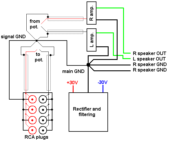

I made ground schematic like in an attachment, posted by someone in this or other grounding related thread. I can't remember who and where it was.
But this schematic is for one channel only and shows one PSU. I use four channels from sound card for 4ch amp and four PSUs. As I observed, if you connect multichannel chipamp with single PSU in parallel, as advised, you shouldn't have any ground related problems. However when you use two or more PSUs with independent transformers this could be a little bit an issue.
At first I had a big oscillations (I guess) with four PSUs, as my light bulb testers were shining when I power on the amp. When I tried to power the amp on for one second without light bulb testers, the amplifier was producing a strong enough buzz. This only applies when connect the amp to source.
After that I found out that Ground from sound card is not a GND as it should be (perhaps, because of I don't have Earth connection in my wall sockets). If you look at PC PSU you could see a PTC thermistors connected from lines to middle point of AC line socket. In my PC PSU has happened that these thermistors conduct to PC Ground 112VAC potential between PC Ground and Earth. Of course, I claimed about this to manufacturer and the answer was that this is a normal operation of PSU.
So, when you connect multiple independent PSUs to the amplifier you have separate ground layouts for every PSU. But source always has common Ground for every channel. Thus, your connection point for every separate ground layouts will be a source ground.
My solution was to connect between each other in series star ground points of every PSU. I have four PSUs with full bridge rectifiers and two transformers with double secondaries. Also to connect like that and have no hum from speakers you should have identical secondary voltage and regulation for all transformers and maybe matched rectifiers. If this rule neglected, you should expect a voltage difference between every transformer (PSU) middle points which will produce a hum. Also to minimize a little secondary variations I used a thick copper bar (on caps) and wire from bridges for PSU Ground and voltage traces, speaker returns, little thinner wire from signal ground points and thin wire for other signal ground layouts. After all of that I don't have audible buzz and hum from speakers, only a little bit when stay close to speakers, caused by variations in secondaries of my transformers. I have 0.5V transformers difference of rectified and smoothed voltage.
